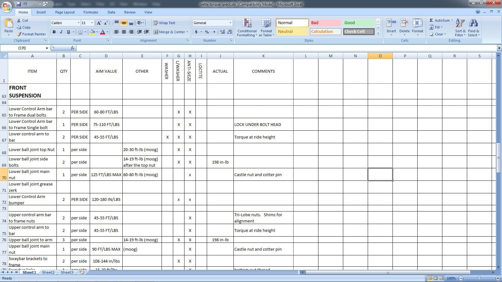

Still not sure which ones your after
Here's a screen cap is my working file, updated one is in the garage
M

Default Torque Specs
That will do it Mooser, I like it and I will use it, thank you for your help.
