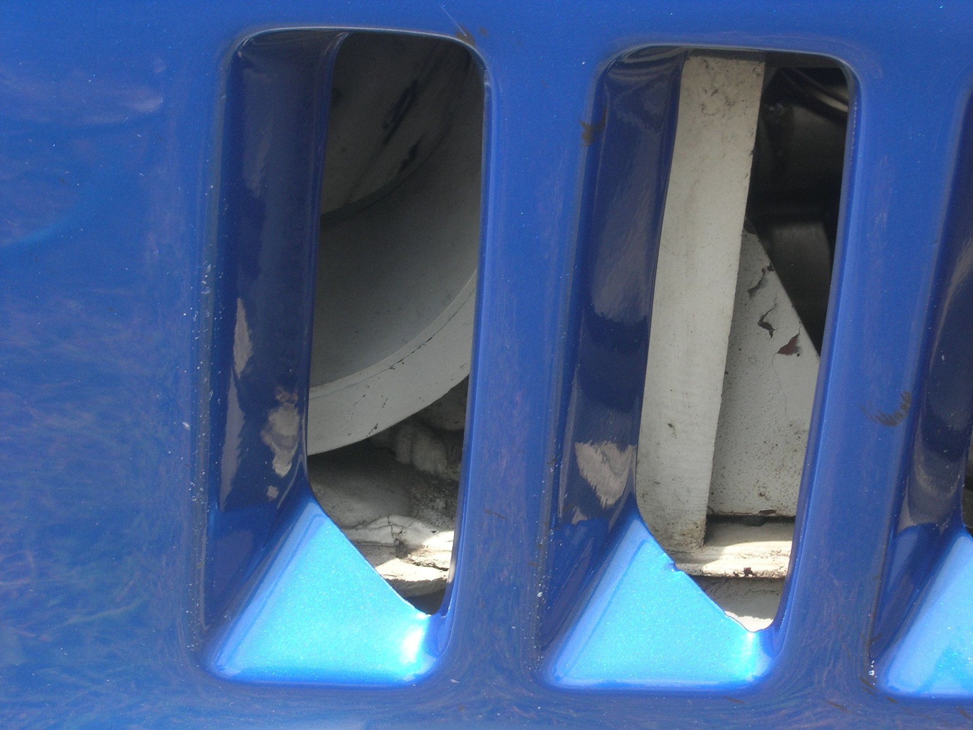

Here is why you should not cut open the rear gill. The vent door for the interior kick panels is right there.

So is the bonding strip to the right. Ditto for the driver's side. There's a reason the gills are closed.
