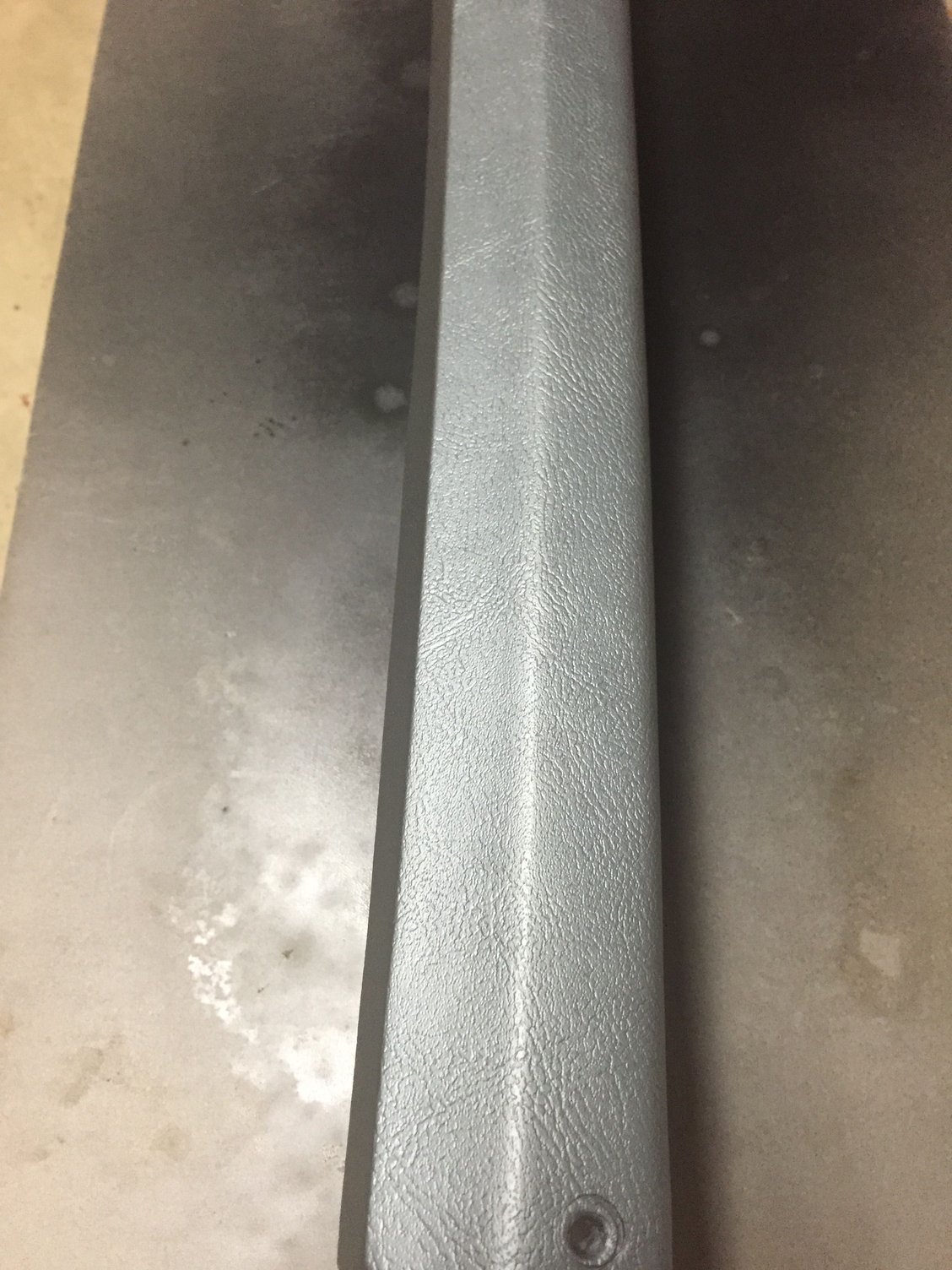

So, full disclosure I painted my interior using the Mid America system about 8 years ago and was pleased with the results then, but admittedly I rushed the job a little bit and left (what I now think is) an important final step out. Were I to do it all over again I would look into doing what 7T1 and others have suggested... using the interior dye. That said since I did the Mid America route last time and it lasted almost a decade I decided it would be safe this time (and your always better the second time right?)
First things first. All Mid America stuff is SEM stuff (I pulled the label off to check). What they do is mix the color coat in the spray can for you. I did check and I believe their pricing is very fair.. plus they've done all the color matching leg work for you. The color coat is mixed in with SEM Universal Color Coat (a flexible coating.. not a dye).
Here's the process I used on my first Vinyl piece (the trim underneath the rear window on a 69 Coupe).
1. Cleaned the piece twice with liquid dawn and green dish scotch pad.
2. Next I used Mid Americas Vinyl Prep to further clean and remove all the years of interior cleaning product. I did this x 2.
3. I then used SEM soap to further remove all grease and oils
4. Gave the piece a quick wipe down with tack cloth
5. Next I applied 3 coats (10 minutes apart) of Clear Flexible Bonding
6. Then I applied 3 coats of (in my case) Gunmetal Color Coat Of note I think it took about 1/3 of a can to do the rear trim piece. Once I am completely done with everything I'll let you know how much was required for the car.
7. Lastly (this was the step I skipped 8 years ago) I applied (15 min after the last color coat) Low Luster Clear.
I did not take a before picture.. needless to say it was mainly just dirty and a little faded. But I am very pleased with the results. Only time will tell how well it holds up.
