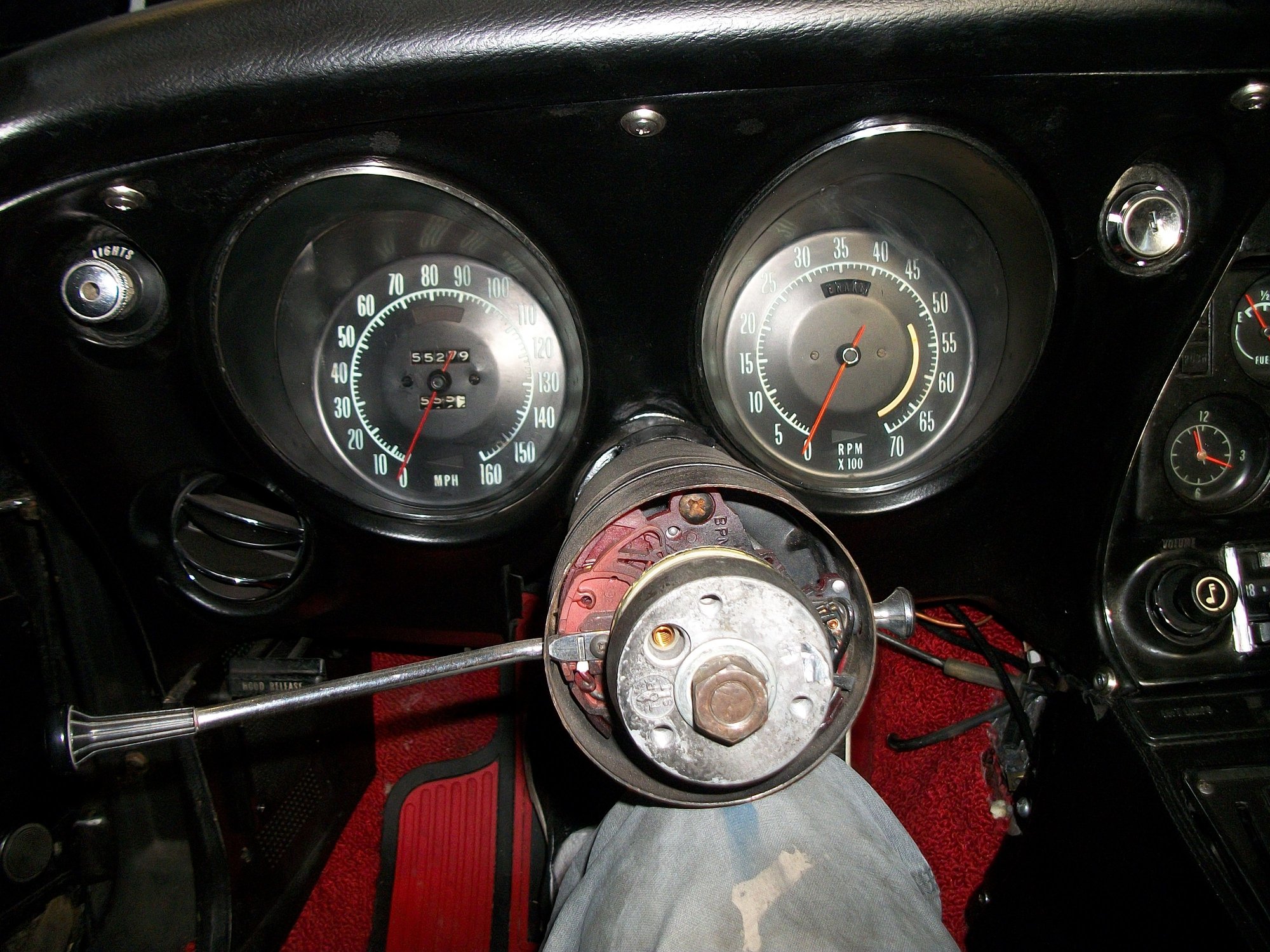

I just dropped my '68 standard (no tilt/no tele) column....at first it only moved a little after removing the two large bolts....then I got a mirror and saw a 3rd bolt on the right side of the bracket....I removed it---wiggled the column a little and it dropped down about three inches....I also found there is much more room to work with if the steering wheel is removed.....

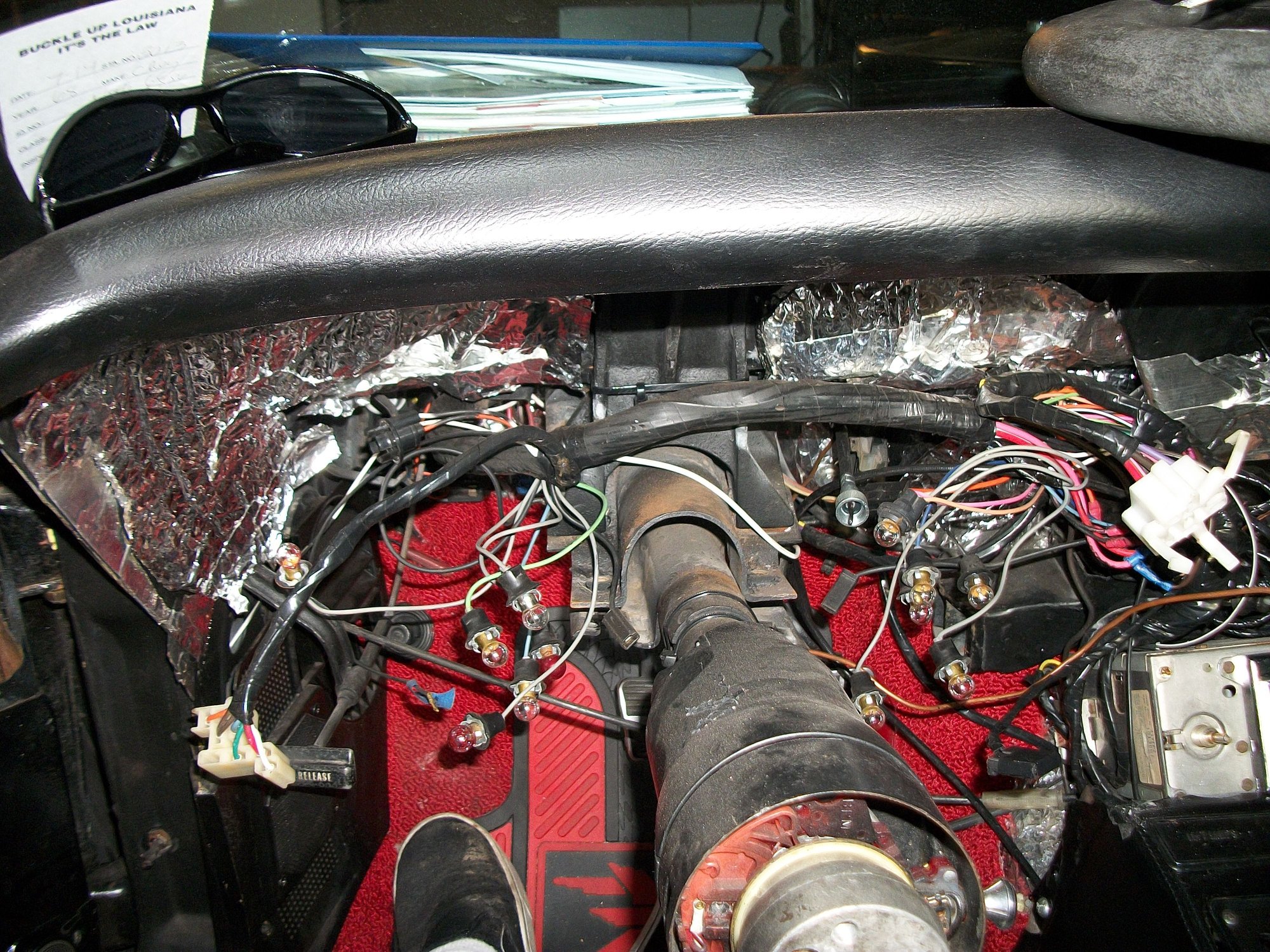

This is about the opening you get with a dropped, but not removed, column. It depends what you want to do if it's enough or not.
After I posted, I searched and found out that I needed to remove the firewall bolts too. Mine doesn't look like that Alan though, it has about 10x more dust, lol. I was able to get in from the side on tachometer and from the bottom on the speedometer...I was trying to go from the top before and that didn't work at all.

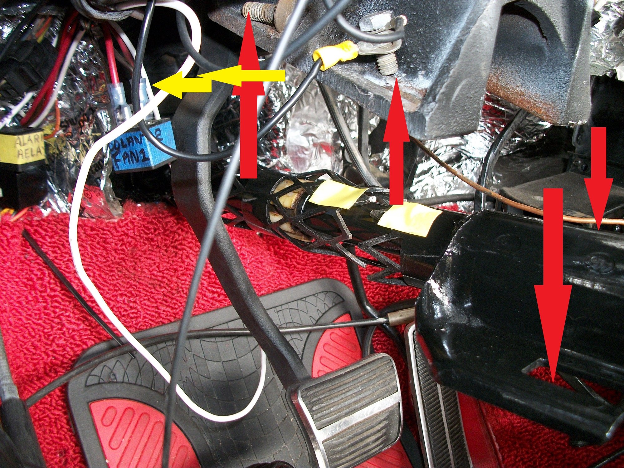

Originally Posted by dreno73
So it is the firewall bolts that help drop the steering column a few inches to get the dash installed?
Yep. But the bolts that hold the column to the large main brace have to be completely removed also.
The red arrows show the bolt holes for the main brace/those are the wrong bolts....The two firewall bolts holes are hidden on the firewall behind the brake pedal arm and the cooling fan relay (yellow arrows).......
