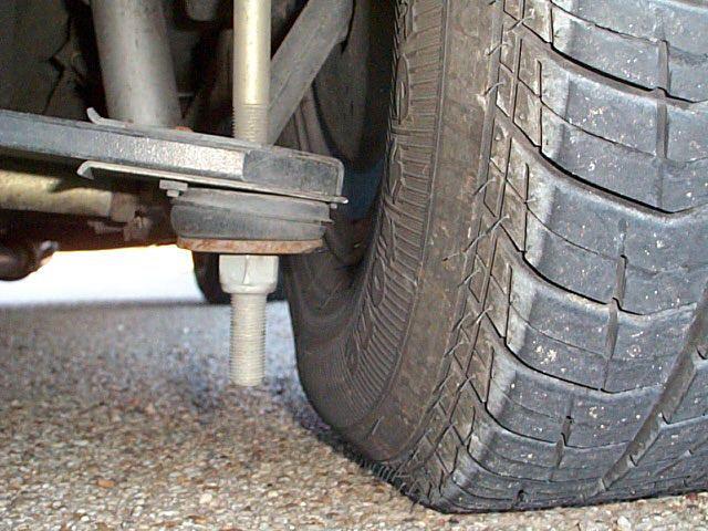

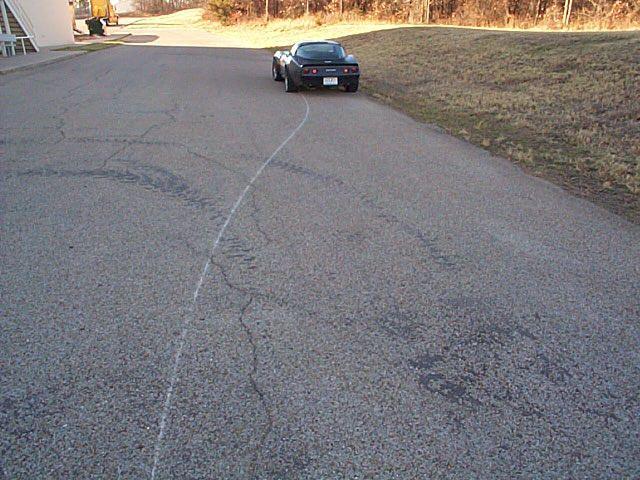

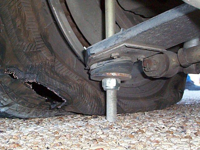

And before somebody jumps in and says 10" bolts will solve your problems. Let the pictures tell the story.

Oops!!
