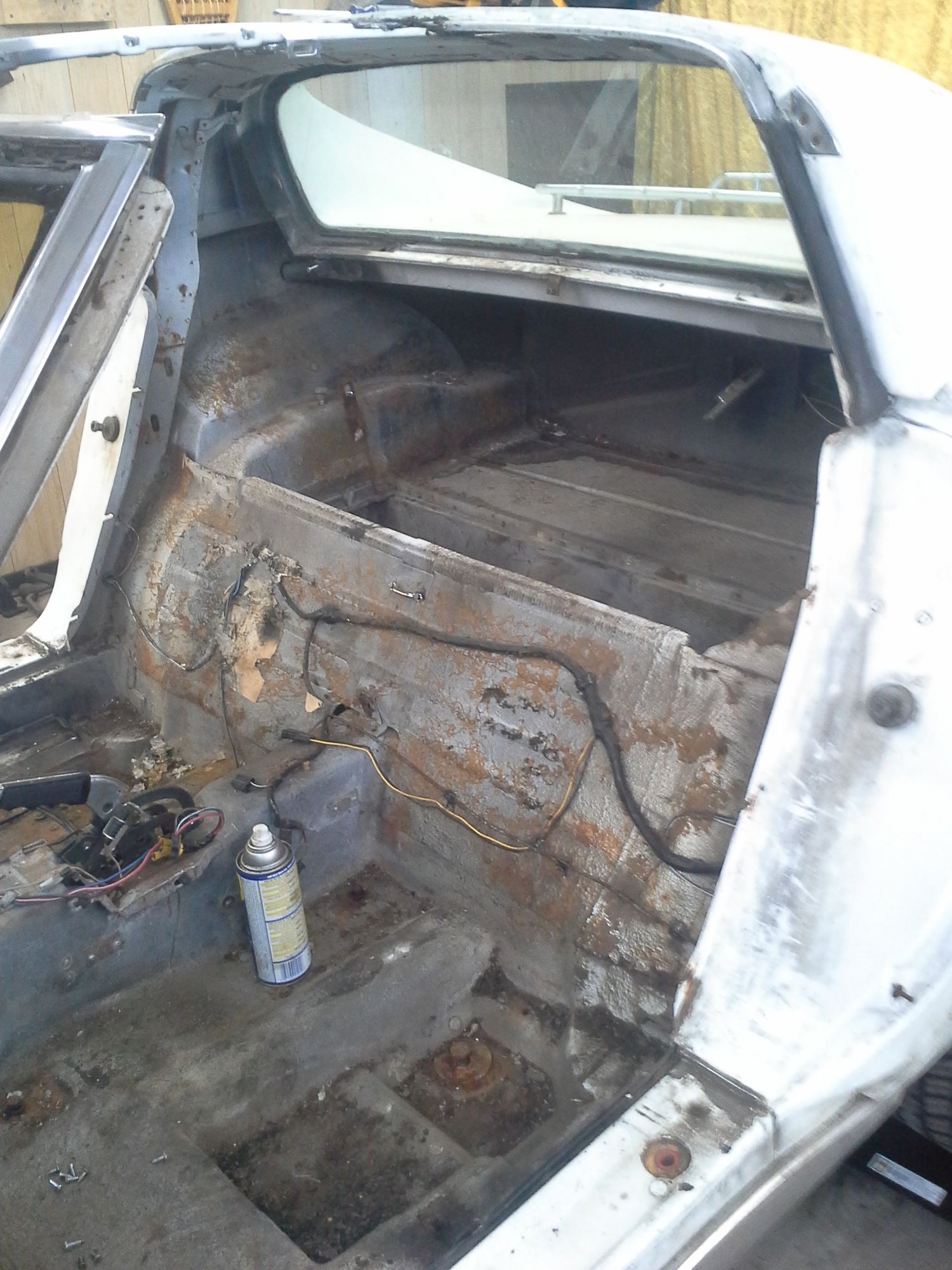

Hi Guys ,
Does anyone know if rust protection / rubberizing was part of the factory assemble process or after market ?
The rear parcel area is covered in a black rubberizing like a rust preventer, it's very thick and uneven and then has a coating of contact adhesive over it when someone tried to glue the carpet . I am trying to scrape it all off so I can have a smooth surface to stick the dynamat to , but it's going to take some time to get this smooth and back to the metal underneath .

It's factory undercoating. The primary purpose was for sound deadening and insulation, but it can help prevent rust. You're also looking at carpet glue.

Hi John,
I believe it might have something to do with the model year of the car.
Certainly 68-72 cars had no 'undercoating' sprayed in the interior.
A minimal amount of undercoating was sprayed in the front and rear wheel-wells….. but very, very, little.

John,
By no means am I telling you what to do on your corvette. But I install Dynamat. And I would not remove this stuff. IF I wanted to add some DynaMat Extreme to it. I would apply it to the backside of this panel and leave the outside alone.
if you are concerned about noise....applying it to the backside will achieve the SAME result. And knowing that HEAT is not a factor here...that is why I would not worry about getting it clean.
If you just have to get this stuff off because now you are on a mission to get it clean...use a heat gun. One this areas gets covered with carpet...no one will ever know.
From your photo and what I can see....I am guessing that your Corvette is pre-1976. You have seat belt retractors that mount under the seat...and the floorboards are still fiberglass. Hard to say for sure due to the three pop rivets over by the area where your seat belt retractor is installed. The floorboard may bee steel....just not enough of a photo for me to be for certain. Not that it matters.

Dub the car is a 73 and the covering is strange , not uniform , in fact in the corner closest to the passenger seat there isnt any at all !! yet over the wheel arches as well as inside the wheel arches there is plenty of the stuff I will clean it off on both sides and treat the metal and repaint it all before installing the dynamat .

To get all that goop and glue off, try a wire wheel on a drill. That's what I used throughout the interior of my '71 and it worked well. Just don't press down too hard and stop once the material is removed but before the base surface is affected. All of my fiberglass floor boards are still intact and the "zinc chromate" primer is still on the cockpit rear vertical riser. Saves a TON of elbow grease!

Dont take that goop off it is sound deadner just clean it up nice then paint over it. I have a 74 and I'm doing the same thing here's a before and after
