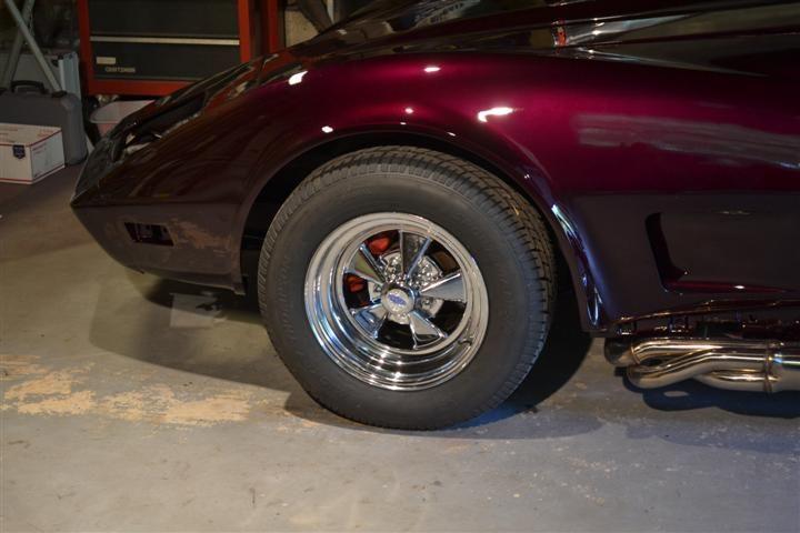

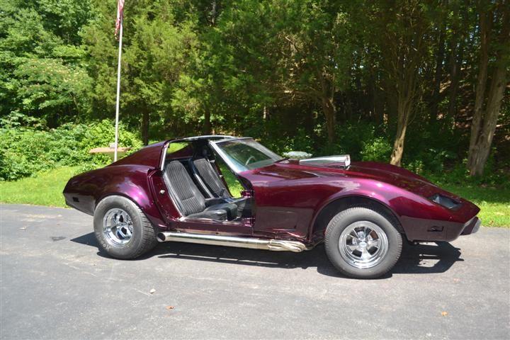

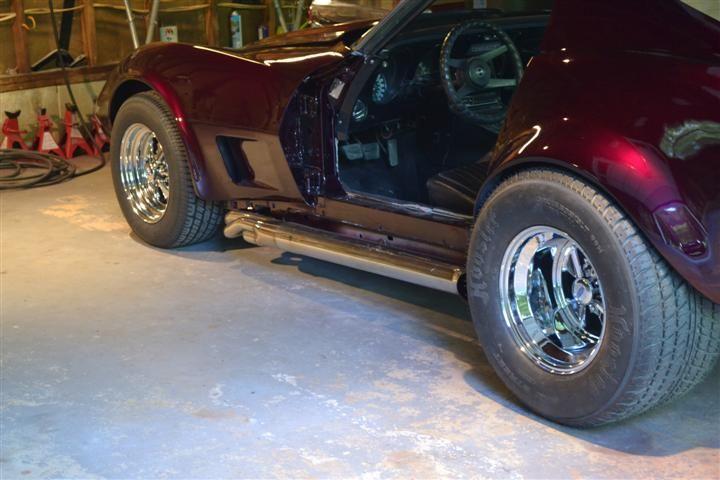

Well got er done and she does look sweet....took 1 1/8 coil out, put air shocks on the back...Monroes. Would still like the back up about 1/2 inch but the air shock travel is about maxed. The design of the shock does not give much jack up ability over stock. Was thinking of putting a 1 inch shock block in the top to give more travel but no one makes one that I can find....may have to get it custom made. If anyone has any ideas...lay it on me....I can go up a bit more without compromising the angle of the drives.
BEFORE:
AFTER:

To adjust the rear ride hight you change to spring/trail arm bolts. Longer=lower and shorter =higher. No real need for the air shocks.

That will only do you so far. As this thing sits the stock shock is almost all the way extended...14" to be exact which is where the air shock is about right now...little more. By adjusting the bolts you can only go as far as the shock will extend. I need to keep in mind I can not compromise the angle of the drive shafts too badly but there is some room there. What I need is a shock extender block about 2 inches such as the ones shown below. This will allow me to let pressure off the shock and shorten it....then adjust with room to spare. I can find nothing like this to fit a C3 and may have to get them custom made....If anyone knows of a company that sells them or has another idea please feel free to share.
