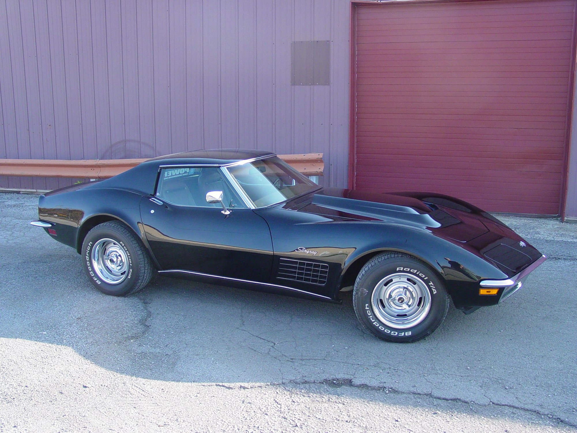

Looks like you're making great progress. Here's a 72 we did a few years back. It also was a War Bonnet Yellow car.

She looks great, I hope that mine comes out looking just as nice.
