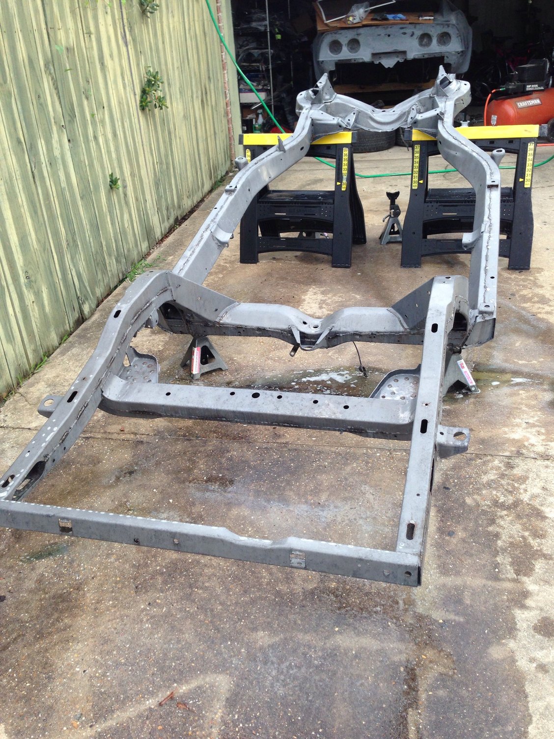

Up date time,
Was able to get the frame blasted yesterday. I started at 8:30 and didn't finish until 5. I was one wore out puppy.

I am sure that you are aware of this...but the frame will need to be fully rotated/flipped all around so you can blow out as much of the media as possible.

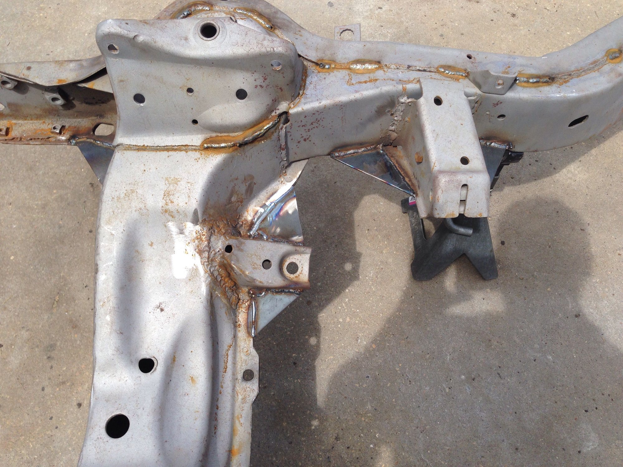

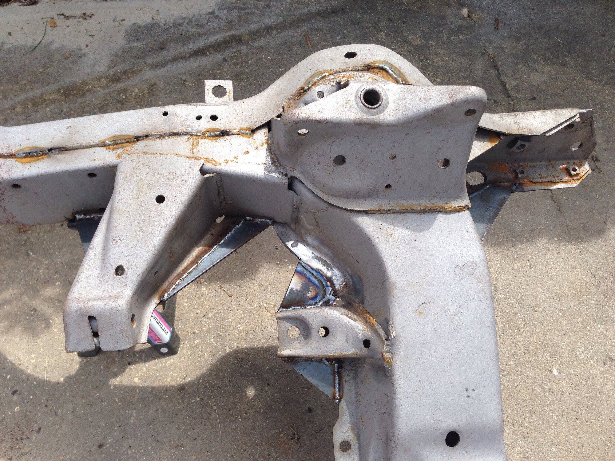

It's update time,
Yesterday I was able to weld in all of my gussets. The only thing I wasn't able to do was box in the forward portion of the frame but I was able to weld the frame between the origional factory welds

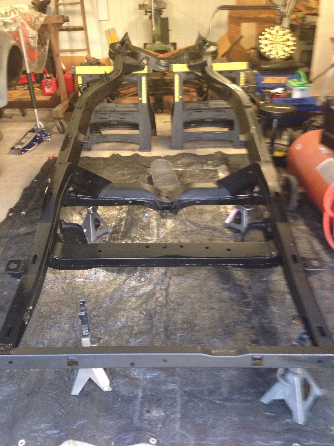

Its update time.
Since my last post I have tried to stay true to my effort to do at least a little something each day. I have put two coats of POR-15 on the frame, blasted and coated the control arm assemblies, front sway bar, steering box and all four brake calipers with POR-15. The brake calipers were all rebuilt using Vette Brakes & Products caliper rebuild kits. With all of that done I have reassembled almost everything on the front end and I installed new SS springs from Vette Brakes & Products with a new set of KYB Gas-A-Just shocks. I have also installed the engine, flywheel, clutch and bellhousing, which was blasted and also painted using silver POR-15. I know its a little detail and most people wouldn't notice but one of the things that I have done that has saved a lot of money is to reuse all of the hardware that was there. It was all blasted and reblued and then soaked with Marvel Mystery Oil to preserve them. Here is a Pic of my current progress.
