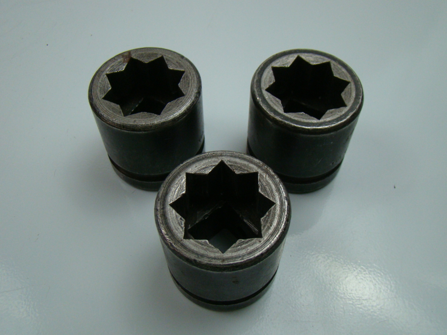

Title sez it all. I have a bad #4 body mount. Reached into the trunk? to see what is on top of bolt and cage came out in my hand. Not corroded or anything, looks like rivets just didnt hold. Looks like holding an open end wrench from above would be difficult. I figure some 12 point largish socket should fit these nuts.

The nut part is just over 1" across flats, might have been due to being lightly rusted but a 1" open end wrench wouldn't quite fit over it.
First one I had to deal with I took a piece of 1-1/4 sqr tube which has an inside dim of just over 1" and it fit nice over the bare nut.
Second time I machined an actual socket to fit over the cage with a spacer to fit a bare nut. Now I'll likely never need it again LOL

8 point socket does it...that is what I use.
Like these..
http://assets.suredone.com/1599/medi...e-im-740-9.jpg

Yep, 4 point nuts need 8 point sockets that oddly enough most people don't know exist.

What size 8 point socket DUB?

I believe the socket is a one inch...and Snap-On sells them...Craftsman sell them. I am sure any major tool company sells them.
