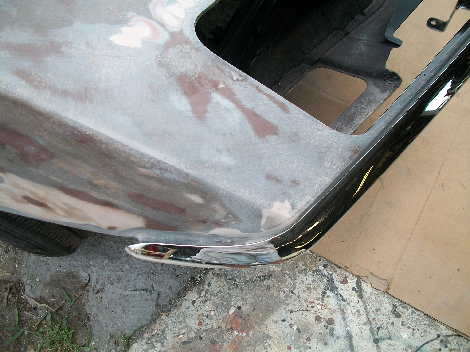

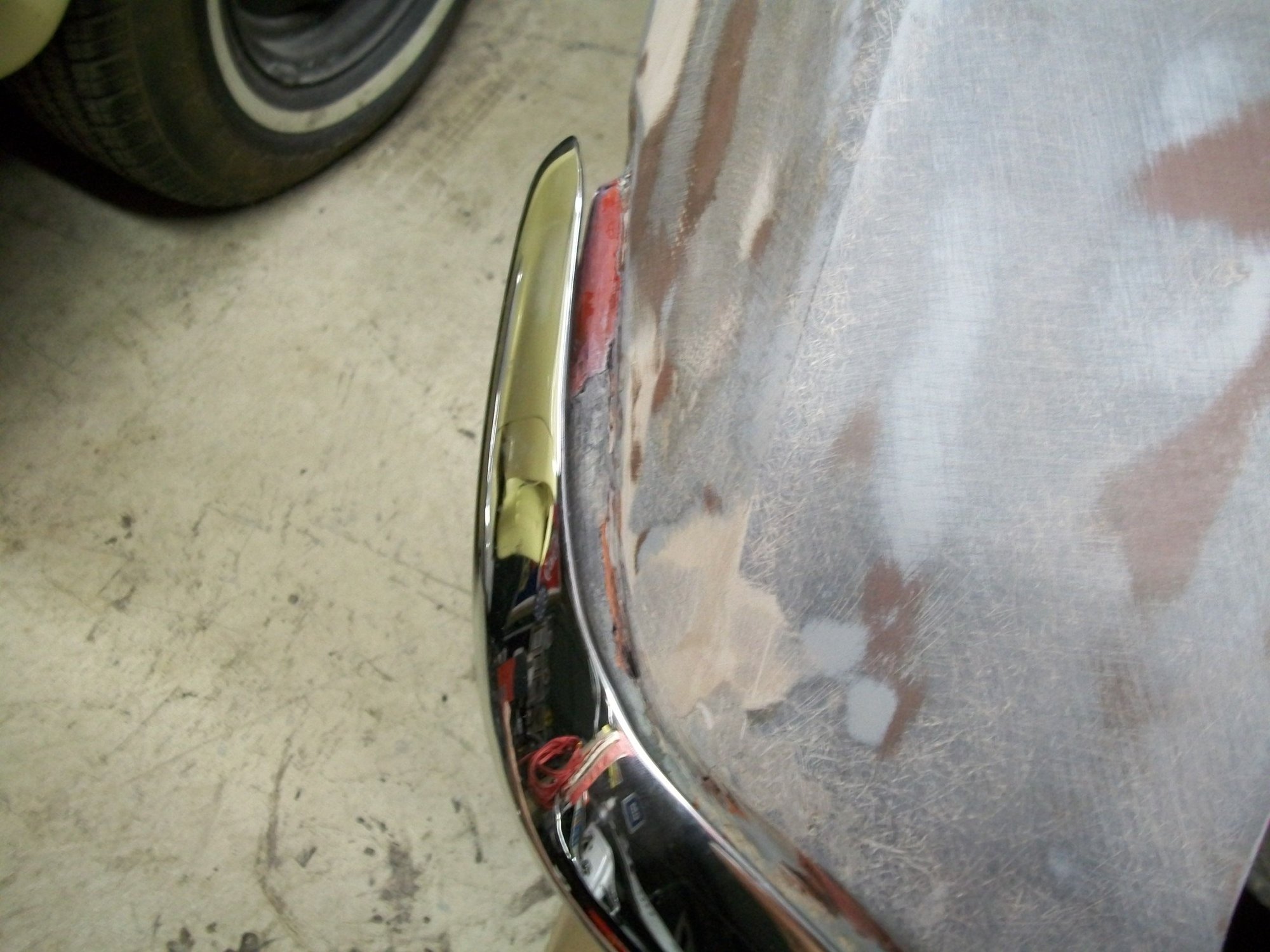

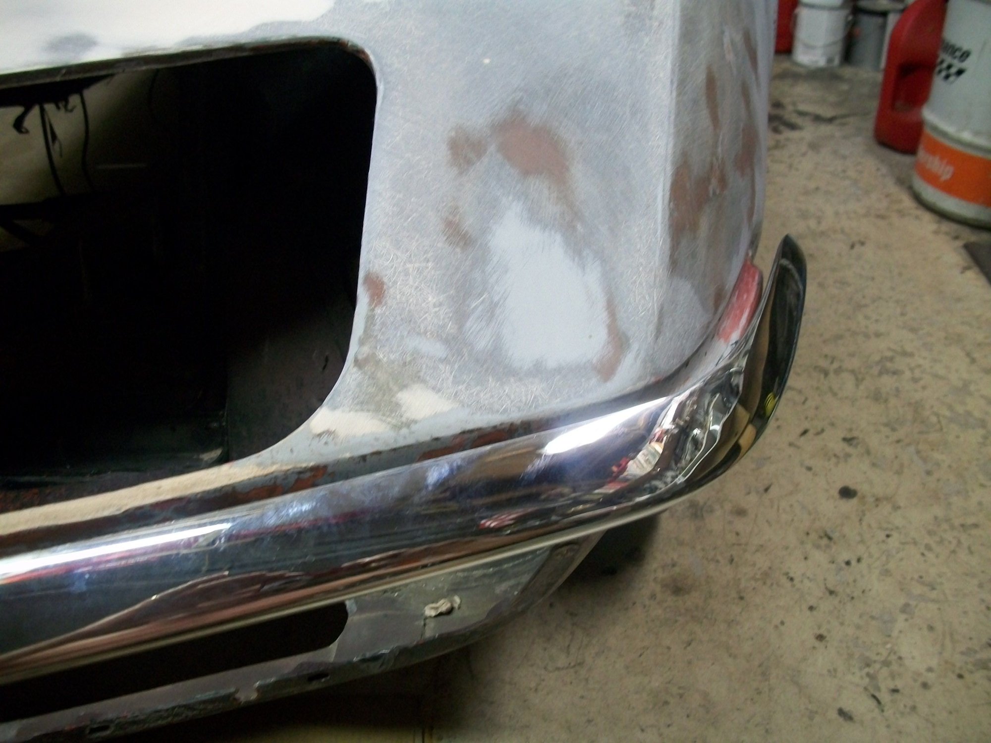

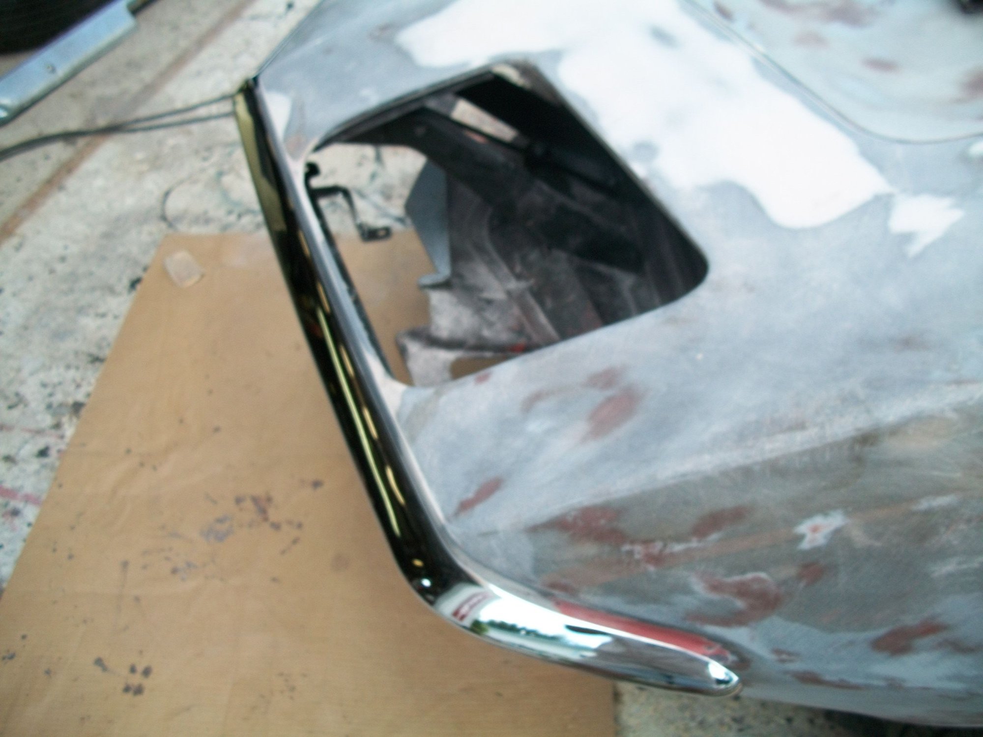

I have a '72 corvette and im having issues installing the front chrome bumper, the p/s corner hole doesnt match up and both corners bow outward, any suggestions on how to get this installed? I attached some pictures showing the problem

Hi s,
It appears to me that the bumper has been 'sprung' which has made the ends not parallel with the body and thus the bolts are difficult to start.
A picture of the center of the bumper may indicate if it's sprung or not.
Did the bumper ever fit this car well?
Has the large center horse-show bracket been moved?
Regards,
Alan

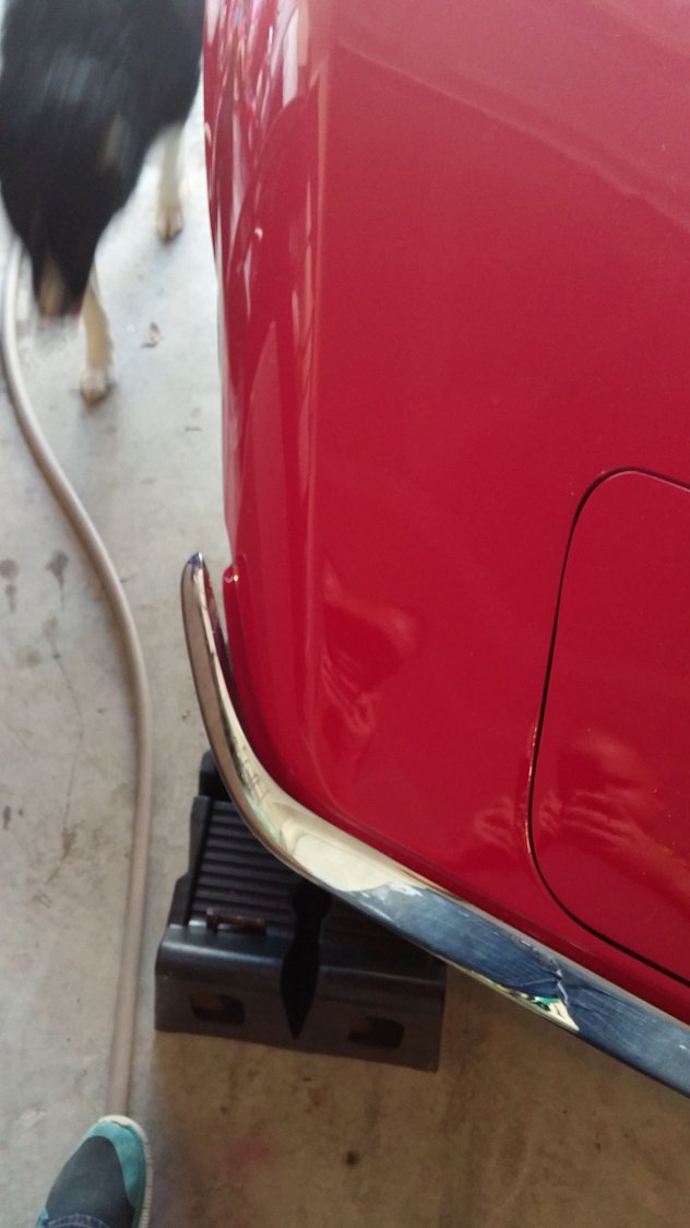

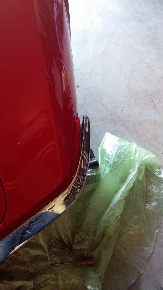

Funny.... I had the exact same issues when I first tried to install my front bumper, AND I posted very similar pictures. It was Alan who suggested I loosen all the mounting bolts until I could get ALL of them started into their holes.... THEN start tightening them all up. This method worked perfectly, AND the corners got pulled in a bit when it was done. (Notice I was test fitting BEFORE paint to get the brackets right) Before & after shots...

Hi s,
A new bumper… ah!.
It's sad to say but new front bumpers are quite notorious for not fitting well.
I'd still like to see a picture of the fit of the bumper at the center of the front clip.
Depending on the fit across the front of the car perhaps the bolts for the ends of the bumper can be started first and gradually pull the bumper ends in using the outer bumper brackets (NOT THE BODY), and then use the center bracket to set the center/front.
The fit of the bumper across the whole front of the car has something to do with how the ends fit.
Regards,
Alan
