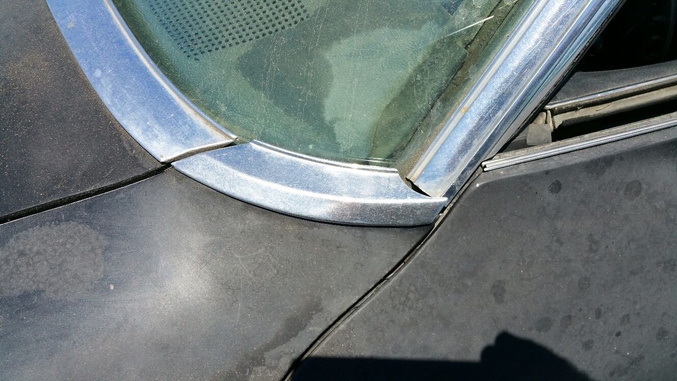

The trim on the bottom, in addition to the stainless strip that clips to the back of the wiper door, are two small trim pieces that attach to the front fenders. These pieces are different from 1968 to later years, one has a longer radius next to the windshield vertical post (though I can't remember which is which) See photo below, not sure which year this is. Robert
Old Aug 21, 2015 | 06:36 PM
Bobs69BB's Avatar
Bobs69BB
Joined: Nov 2011
Posts: 148
Likes: 24
Also note that these trim pieces should be painted body color except for the bead on the top.
