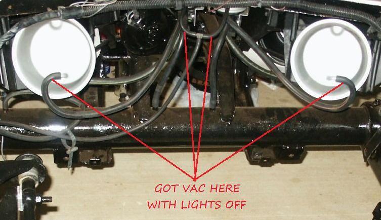

Yeah, I know there is about 100 posts for headlight problems with vacuum diaphragms etc etc etc but I just want to know the direct answer to my question with out having to play Sherlock Holmes and print PDF vacuum diagrams to look for color codes that are not visible anymore on my hoses + I'm to lazy to do all that right now (at least I'm honest).
when I start the car the passenger side headlight goes up and stays up, the drivers side goes up and down when i turn the headlight switch or over ride switch on. I have vacuum at the center regulator, when I disconnect the vacuum the drivers side drops not the passenger side, so what need replacing?

You didn't say what year, but on my 73, I had the problem of the
headlights opening when I started and the problem was no vacuum
to one of the regulators. Make sure that you have vacuum to the top
small inlet on the regulators. When there is no vacuum there, that
is what opens the headlights. See the small lines to the two regulators
in the photo, that is the vacuum line I am referring to.
Donnie

Assuming that what you are calling the 'center regulator' is actually the headlight actuator RELAY....and this is where 3 big hoses connect along with ONE small hose....CORRECT??
Well..if this is what you are calling the center regulator....look at them. Where the 3 hoses plug in...if you look and feel on the relay further down at the BOTTOM of the black plastic portion of the relay..you will see how it has been made into a square. IF you put a small vacuum hose to your near...when the engines running...and take the OTHER end of this hose and put it near or INTO this square are ON THE BOTTOM of the relay....so the hose will be going upwards...and you can hear a vacuum leak or serious hissing....that is a problem and the relay needs to be replaced...or should be replaced.
