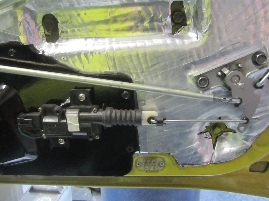

Power locks are fairly easy. A bunch of people have added actuators (try to go with some OEM version as the aftermarket seem cheap) and a set of relays and a key fob remote. Some use a higher end alarm which frequently have the power lock feature built in.
Basically the actuators need to do something like this

@Mooser - wow! That's a real nice inner door you got there! Did you fab that plate? Pretty sweet! How's the quality of the Harada actuators? Those are OEM for Honda?

Yeah the plates were made to fit, wanted to maintain the factory links and add mine. It's spot welded (sort of) on-top of the original pivot so it could always be removed. Others have used similar things that are far less complicated in shape (a big washer works) but I use things like this to prevent myself from ever finishing.
The actuators were salvaged from a Hyundai I believe and have enough power and stroke length to work well in this setup. They are wired to a set of relays under the dash and to a keyfob remote from unknown origin (I'd guess China like everything else)
If I was worried, I guess I'd run a set of wires off the unlock circuit out somewhere hidden yet accessible (inside the fender gills or under the headlights somewhere) and you could trip the solenoids if the receiver ever quit or the battery died. But I can't actually remember the last time I locked it anyway.
