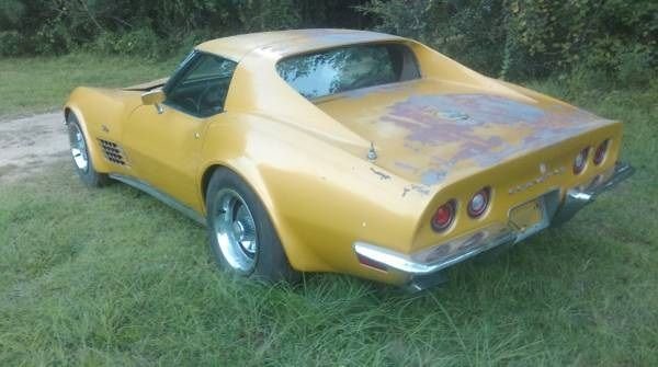

I am considering a 1971 project that will need a replacement chassis.
I want to do it correctly, so what do I need to know? The car has:
ps; pb; automatic.

As I understand, it is a no hit car with a badly rusted chassis. I think $3500 will take it.
