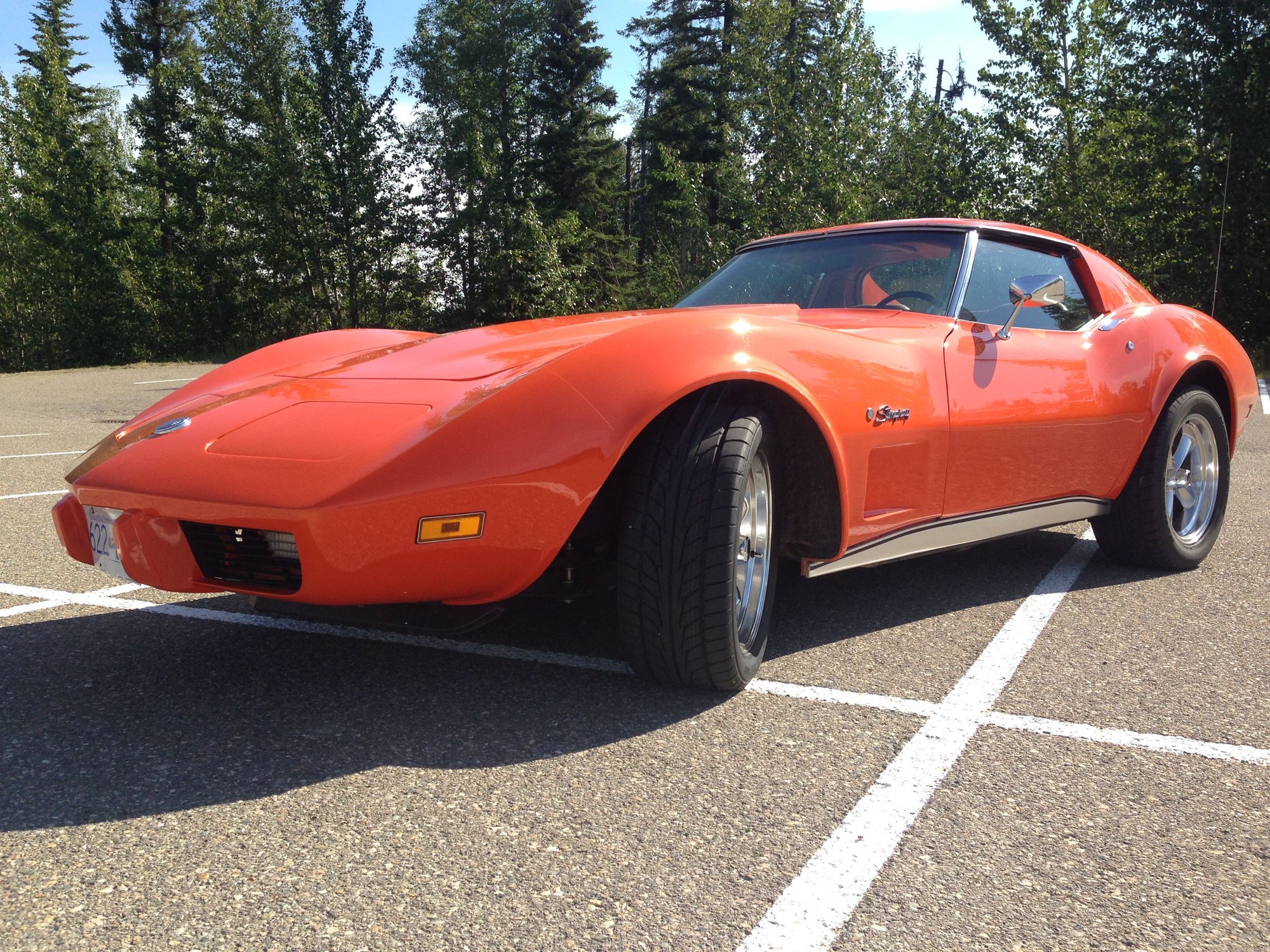

I also had same problem after new paint job . I talked to the body shop who painted my car and they said to put the clear plastic on front . found a couple of shops in town that apply a product called Dura Shield Flex . Cost was around 500.00 but I think well worth it considering the price I paid to have car painted and it does help protect from many chips up front .Hardly notice when you look at car.
Nice! looks good...
