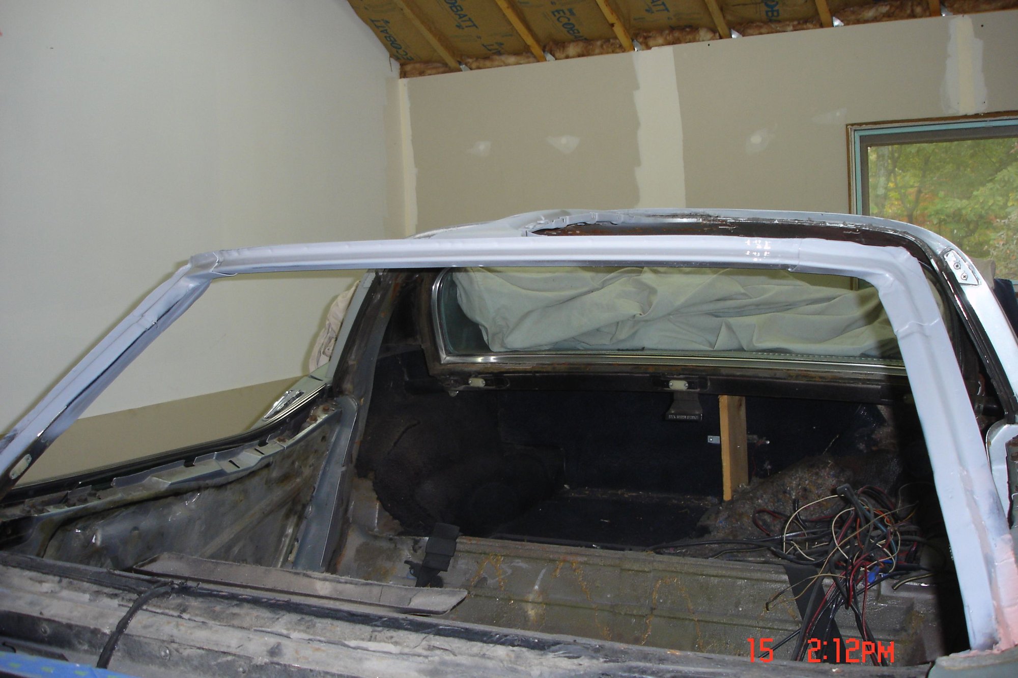

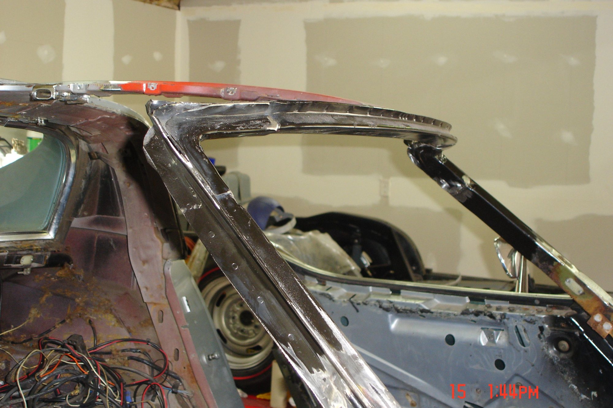

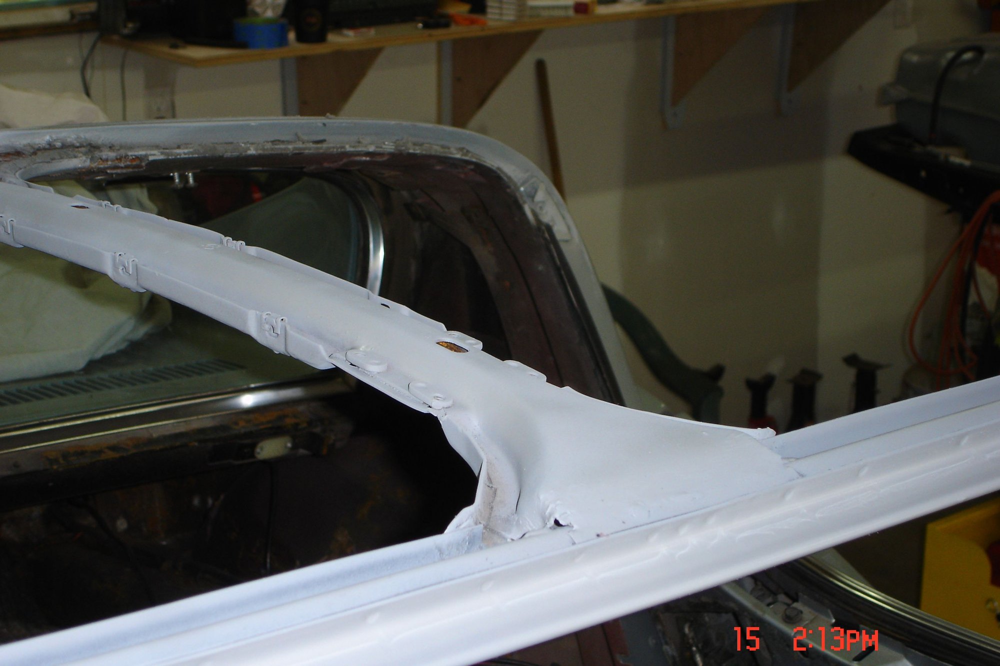

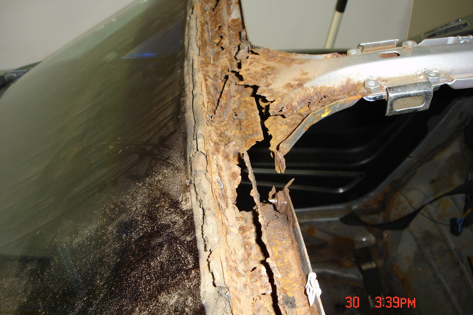

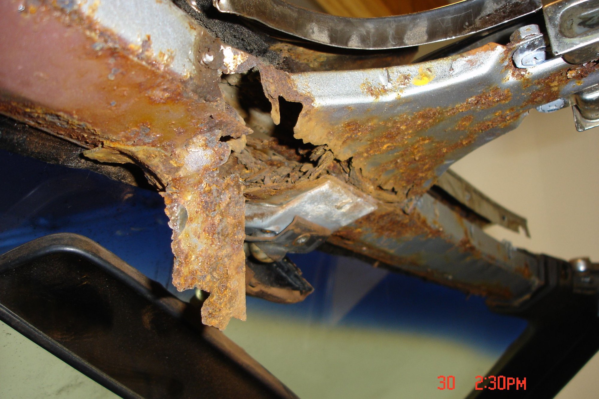

Welcome to the C3 world. All of the advice list above from other members is correct. I have been on my 69 restore for along time as a retired person. There are many hidden tings below the surface. It is an exciting experience to fix one of these old cars. Hopefully you won't run into what I had and all your issues will be minor. Keep the pictures coming so we can all help. You are in the right place.
ZIO
Please don't be shocked, and hopefully yours is not this bad but it can all be fixed!

After seeing your pictures I realize my problem is not that bad. I also realize there's hope and it can indeed be fixed. Congratulations on how you handled your problem with the rust. Do you have finished pictures of your vette? I think we would love to see them. Thanks!

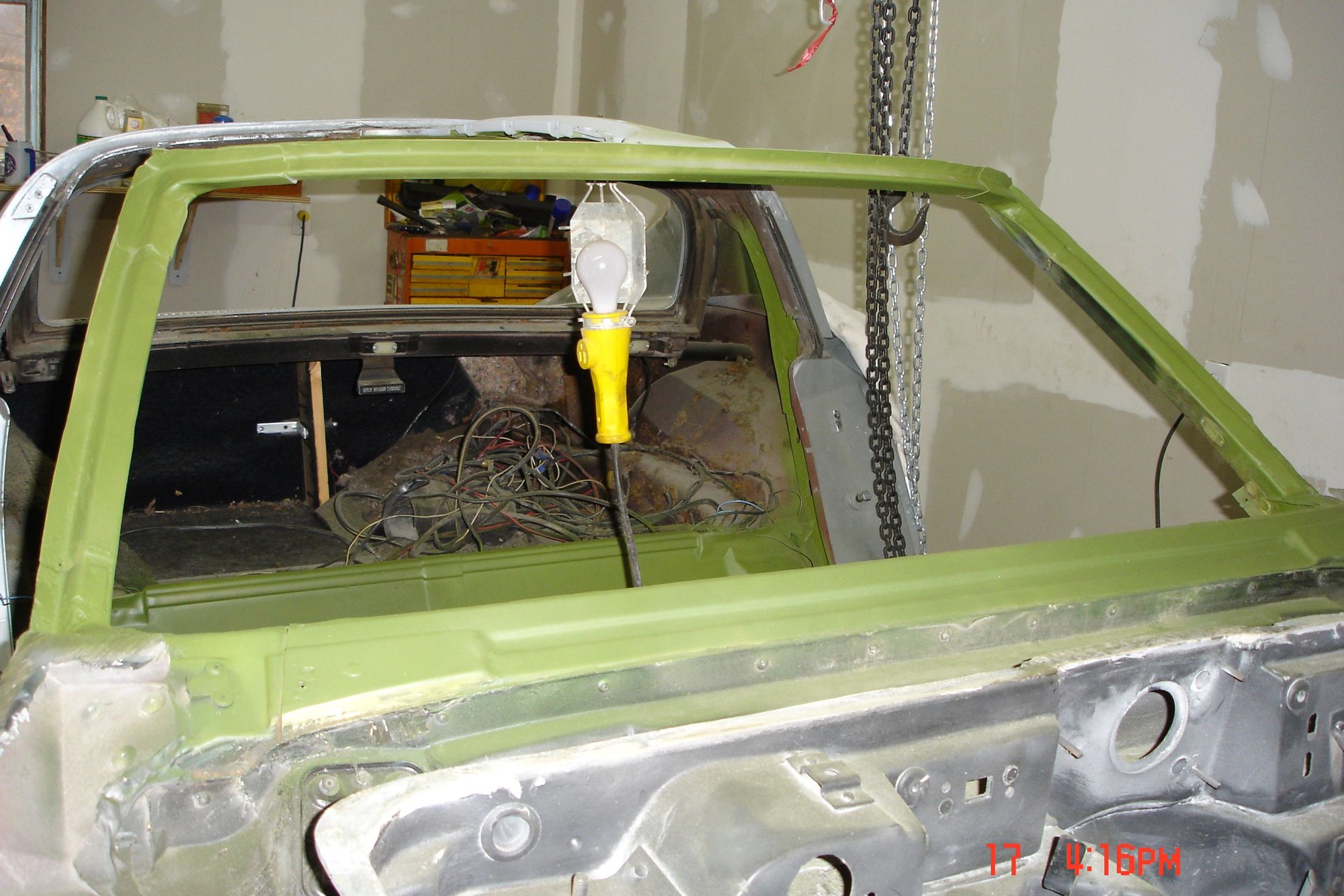

I am glad you do not have the damage that I had. If you want to keep it original GM used a Zinc Chromate paint in green. If not you might want to clean any rust a use UPOL#2 gray primer. Your choice. My car is far from done but you can see how I am doing on my thread.
Good Luck!

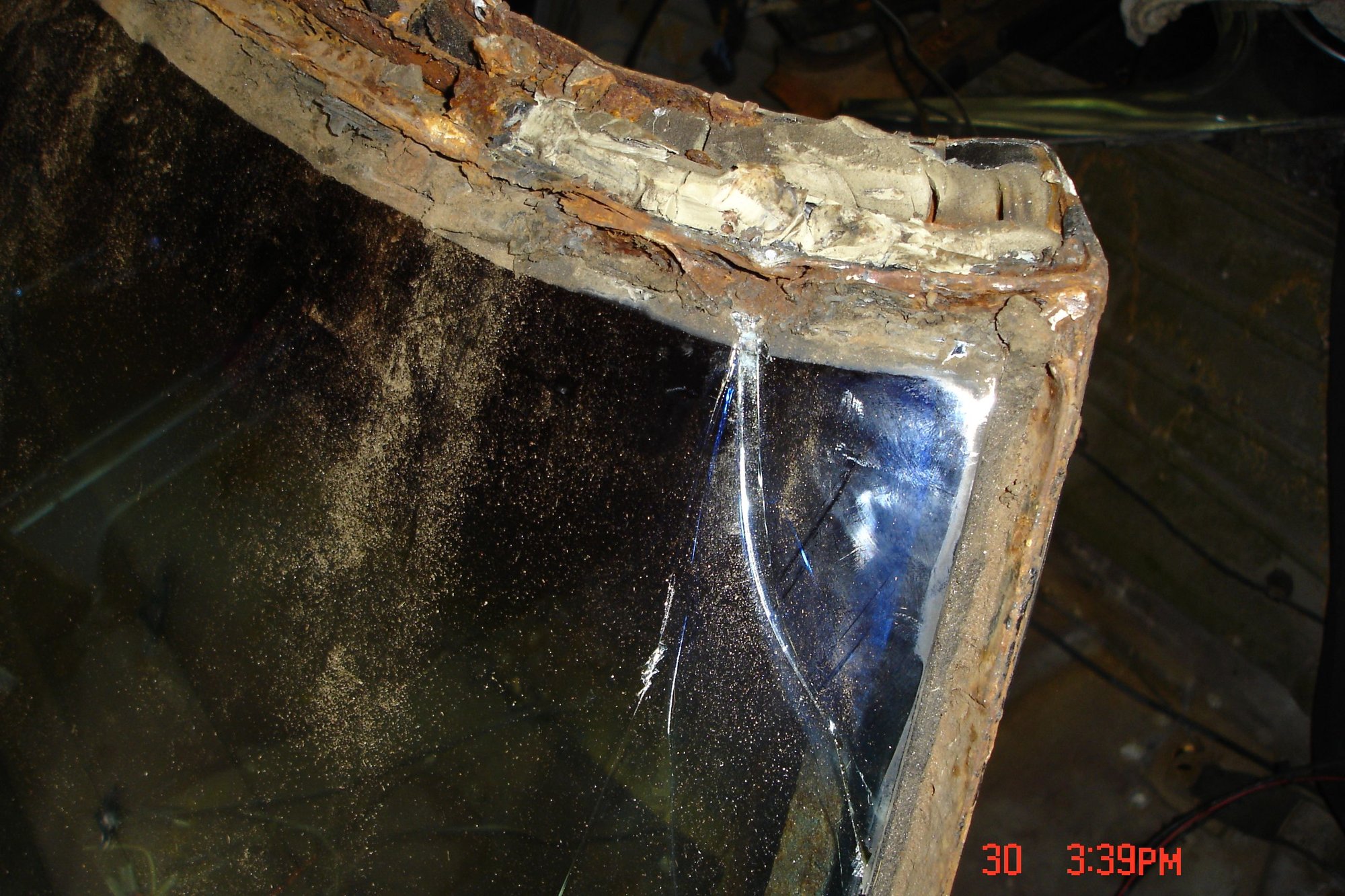

The header on my 71 was not as bad as rvzio, but we did have to replace the upper corners, and patch some holes in the cowl.
When we took it apart, it appeared that the entire header was full of old, dried sealant.
Since the 3M "dum dum" we found was only in thin little strips, we decided to use "duct seal"... an electrical putty type product used to prevent moisture from entering electrical equipment.
It`s sold at electrical supply outlets, and is only a couple bucks per pound..... about two pounds filled our header completely.... side to side & top to bottom.
Sorry I can not yet rate it`s performance on the car, as we are still building it.... but I am an electrician, and it works GREAT in that application, so I expect it to work wonderfully in the car too.

It seems like I might be leading the way in the bad windshield department, which is not a good thing. Thank you for the positive comments on my fixing the problem. Means a lot coming from Wilcox. Was not fun but rewarding.

Originally Posted by DUB
... If a person is cleaning up the windshield frame. It is WISE to get too crazy with applying products on the windshield frame where the urethane is going to be applied. Every where else is fine. Applying excessive coats of primer and even painting it is a NO-NO. And this is due to you are increasing the possibility of shear. Most glass companies either want it bare steel so they can apply their special primer..or apply one coat of epoxy primer or zinc/chromate primer and leave it at that.
DUB
Dub,
Did you mean to type "It is WISE to not get too crazy with applying products...???
That makes more sense to me considering the rest of your post and is a great warning to us do-it-yourselfers. I'd hate to have remove products I'd added in order for the window to seal properly.
Paul

We use zinc chromate (from air craft spruce) on the frames and then 3m 08681 Windshield primer around the frames everywhere the urethane will touch and I think what Dub is saying is to keep that area clean and free of any weatherstrip adhesives.
http://3mcollision.com/3m-single-ste...81-125-ml.html

Originally Posted by nwav8tor
Dub,
Paul
Paul,
THANKS....I corrected it.
Oddly..I have had several 1969's that had the stainless steel track above the door glass to hold the weatherstrip. A new one to me. I stand CORRECTED.
What Willcox is applying to the frames is perfectly fine...not like they need my approval on that. The zinc/chromate is a thin product that sticks like heck....then the 3M product adheres to it. SO...the 3M product ONLY has ONE product that it can shear off of. Because the 3M primer and their urethane will bond together and not shear.
Because....the area on the windshield frame where the urethane is going to be applied is what is most important if a person is concerned about 'shear'....SO...if a person plans on priming, painting and clearcoating this area where the windshield primer and urethane goes....is NOT up to industry standards....just 'saying'.
DUB
