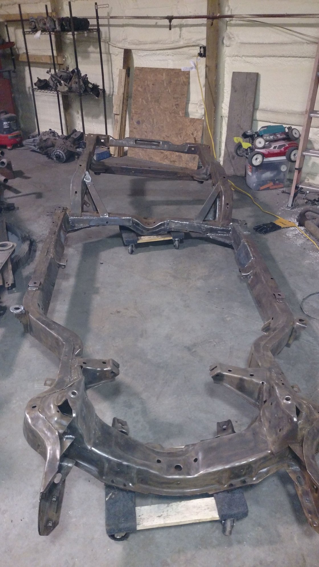

Got a chance to work on it tonight for about an hour.
Frame stripped.
Excited to get to putting back together.

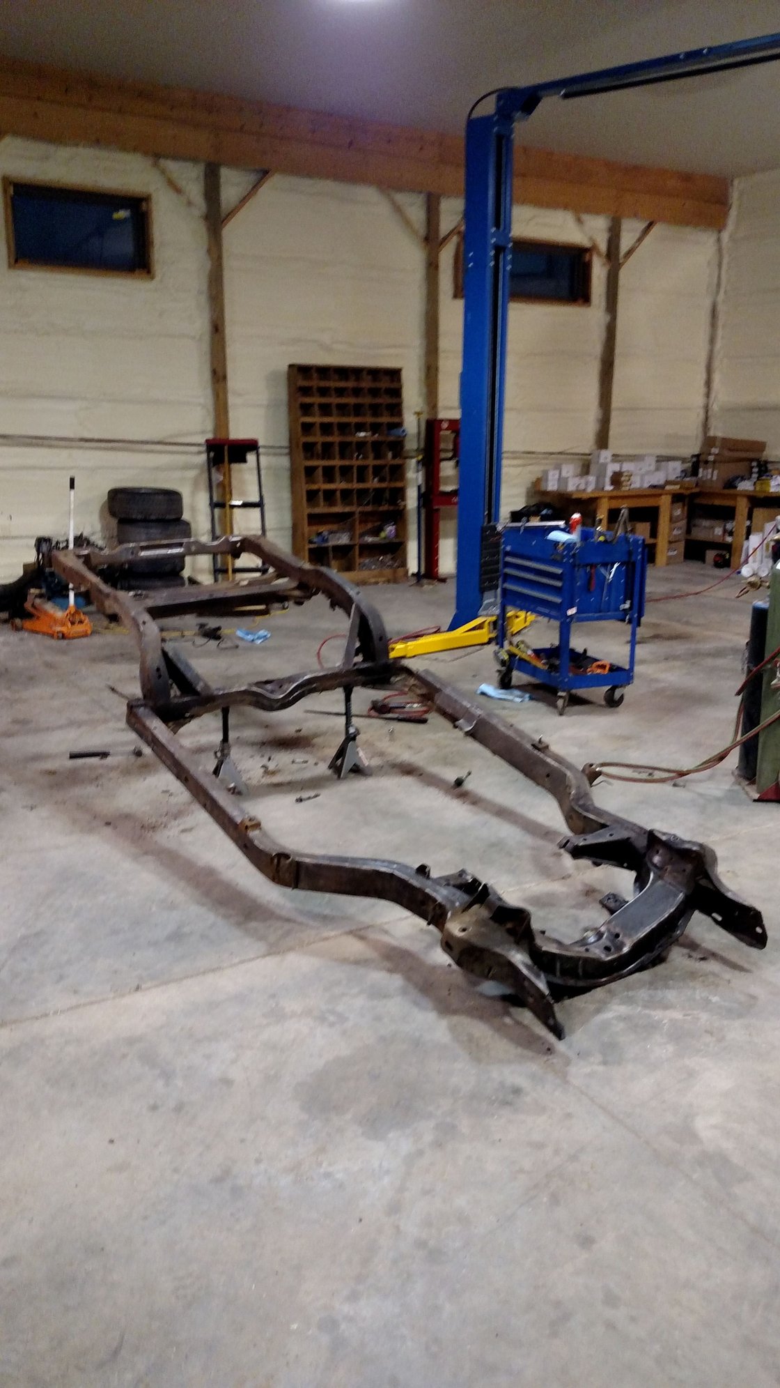

Getting close on this frame. Final cleanup and repairs left.
Hope to complete cleanup and repairs this week, coat frame next week. I've come up with a plan for cleaning and coating inside frame. Pics to come.

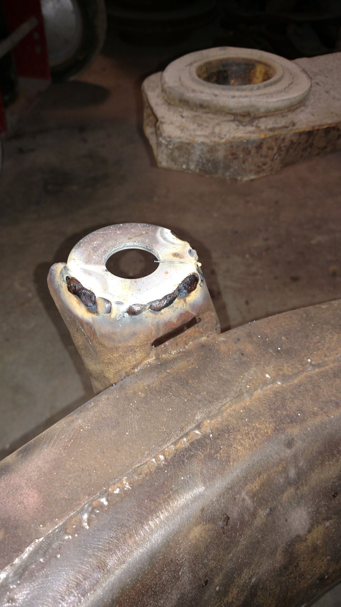

Frame all fixed and reinforced
The real bad corner
Fabbed up body mount
Heavy washer to repair body mount
Just have to grind down welds and finish cleaning frame and its ready to coat.
Anyone see any issues I missed or reasons why this won't work?
I repaired and beefed up trailing arm pockets, repaired frame as needed, added more welds to frame seams, repaired/fabricated body mounts. My welds aren't particularly pretty, but should be plenty strong. I think I've got it stronger than new in any trouble areas.

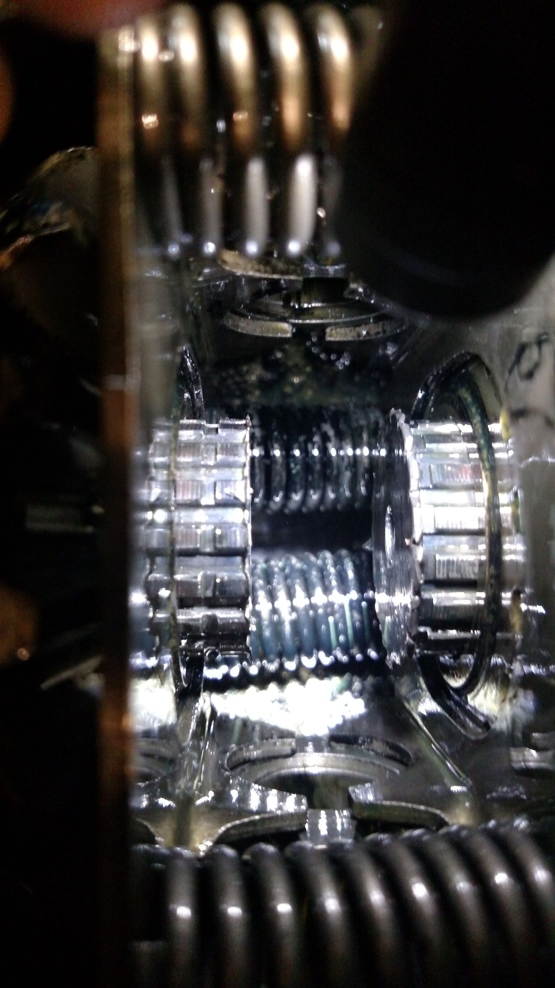

So I started coating the inside of the frame tonight.
Inside frame rail
Interior frame painting
I used a spray on bedliner gun and attached 3' of 3/8" hose to the nozzle. Ran the hose in any openings big enough and sprayed,twisted,wiggled, etc... The gun uses venturi effect to draw in paint through a hose. I removed the regulator and used full 150 psi. Worked pretty well, a couple of times the check valve didn't like the high pressure and blew bubbles in my can of chassis saver, after that I just made sure to squeeze trigger slowly. I'm going to flip frame and do another pass, think it will do a good job.

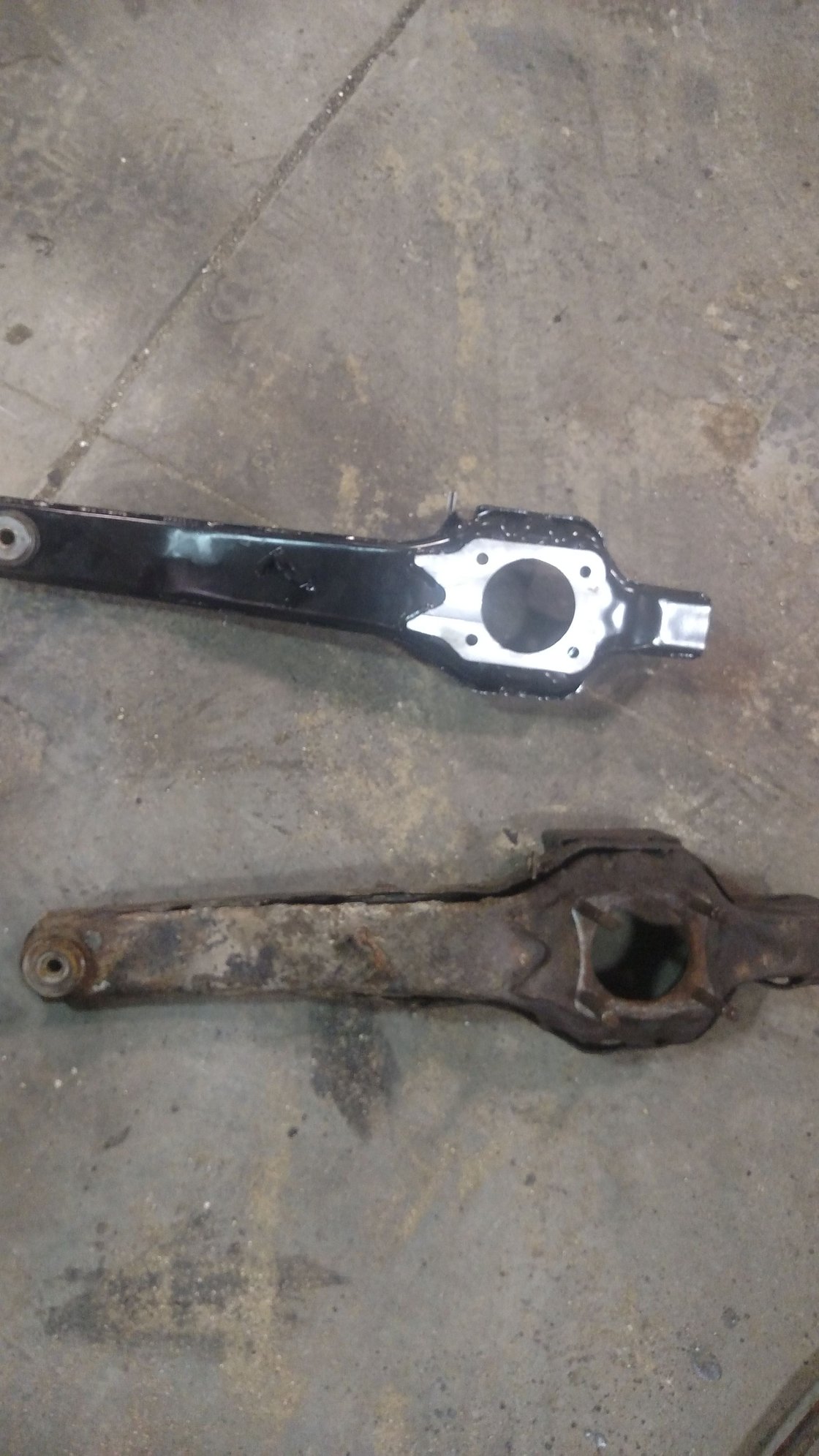

Got rear diff put back together with new side yokes and started on rebuilding trailing arms.
A little better
Yuck

Both are a pain. If you dont have a shop full of tools, id send them out. I have an entire auto repair shop at my disposal and if I had the extra money, I'd pay someone else. I had stuff that would work, or was able to fab something up instead of buying the tools. With your hp, I would get a set of trailing arms from vansteel or another vendor that will use heavy duty spindles and get it all set up perfect for you. Those rear bearings are stupid. By the time you buy spacers, bearings, possibly spindles, dust shield, park brake, rotors, bushings, etc.. It's a bargain to get a rebuilt set.
I didn't do a rebuild on the rear diff, I replaced seals, replaced side yokes, replaced pinion bearing, cleaned everything up. Gears look brand new, gear lash was good. Posi worked good, breakaway torque was in spec, so I didn't even mess with it.
The winter after I get it driving again, I'll consider rebuilding the rear diff, I'm going to make a list of things that need attention and start taking care of those over time. Coilover rear susp is high on list.
