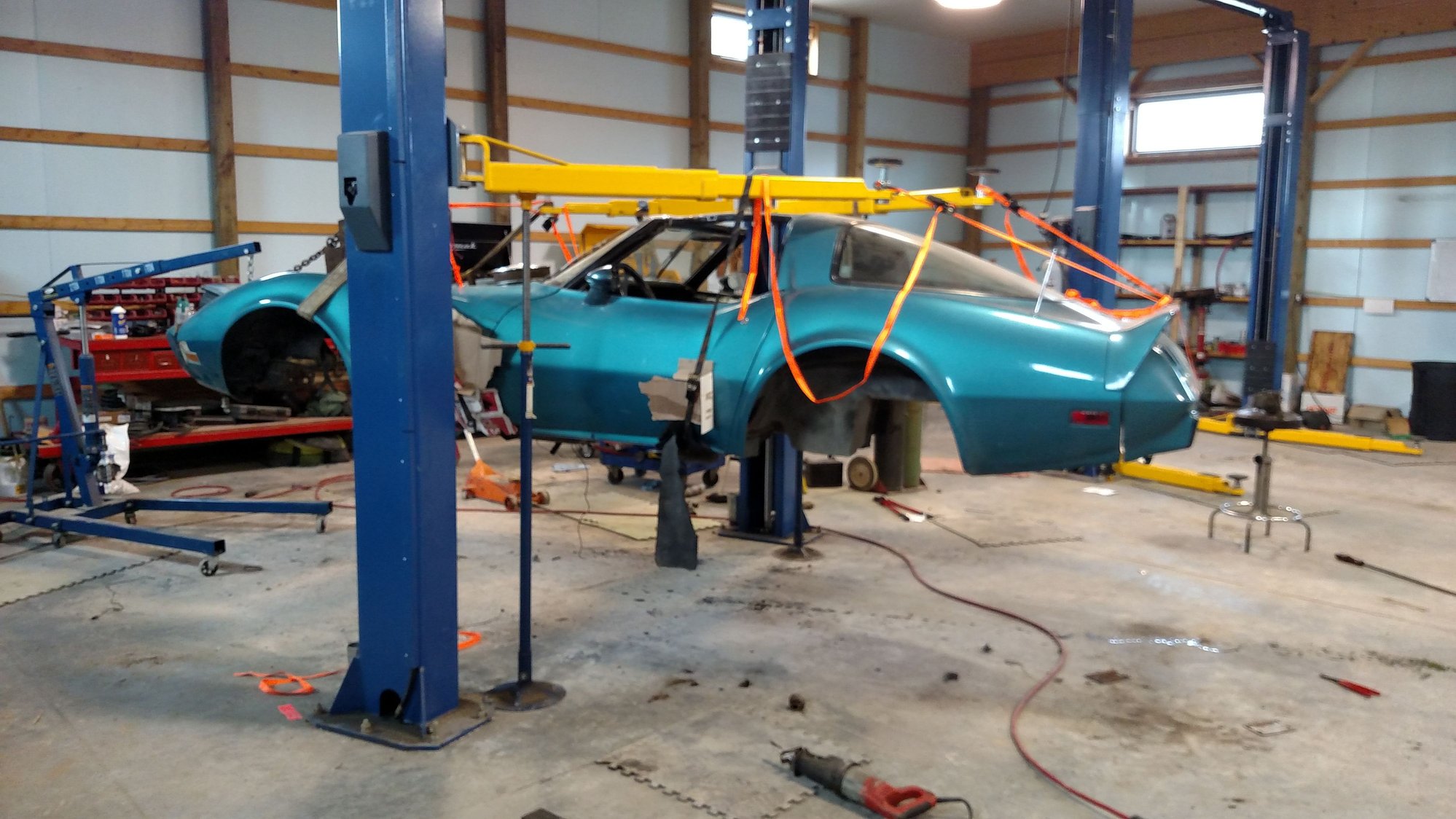

Interior coming out.
Body separated.

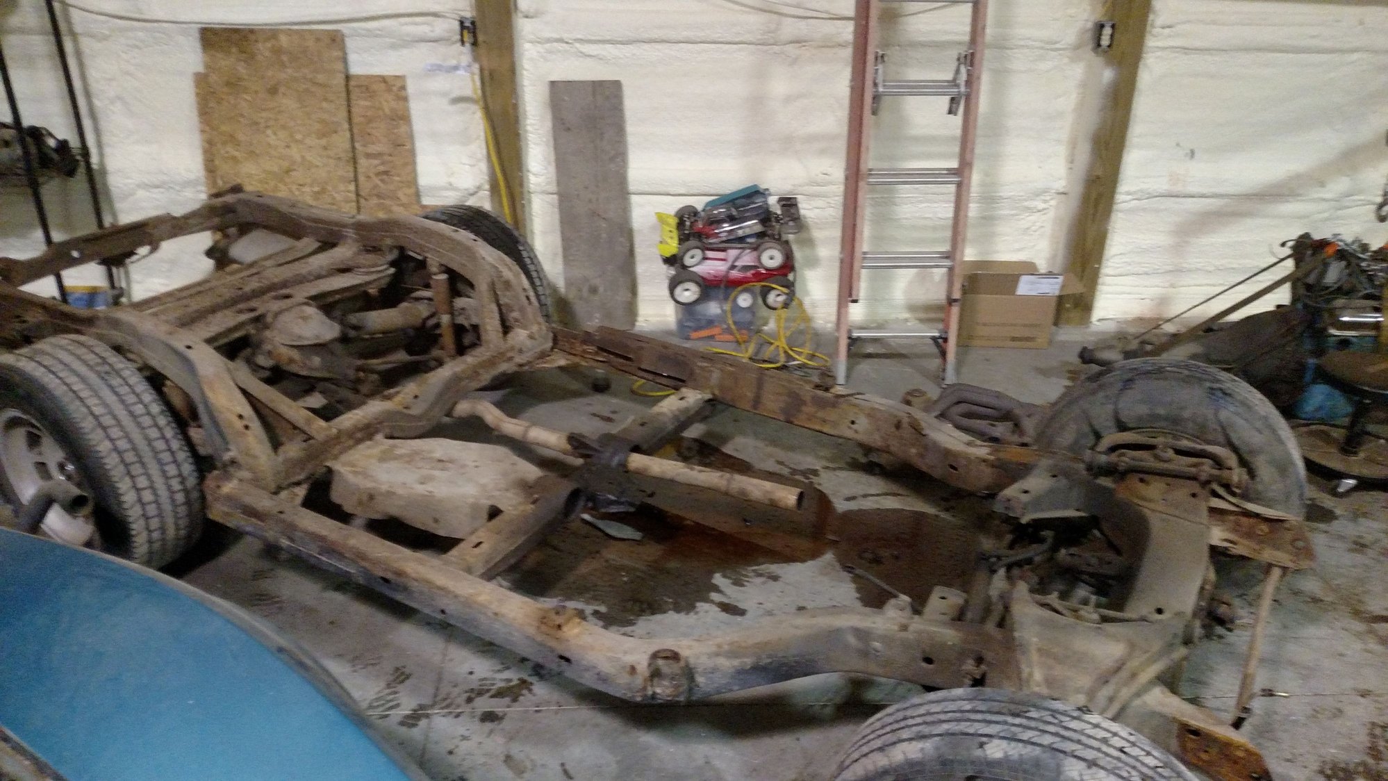

Chassis

Powertrain out
Cutting out bad areas of frame

Hi G,
Looks like you have some serious work ahead!
In this pic it looks like the body must have been holding the frame from buckling up on both this side and the passenger's side. An odd 'crease' in the frame rail?!?
Did the frame want to kinda 'come apart' when you lifted the body?
Good Luck! It sounds like you have a good plan!

Originally Posted by Alan 71
Hi G,
Regards,
Alan
Someone had welded on the frame from underneath, as much as could be done without pulling the body. They used 1/4" steel angle, so its really strong, but the top side of the frame is gone. I drove it maybe 40 miles or so before deciding to pull it apart. It will be safe before anything else. I want it to last for a long time. I'm going to repair the frame and coat it inside and out.
