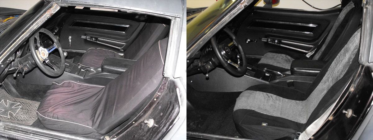

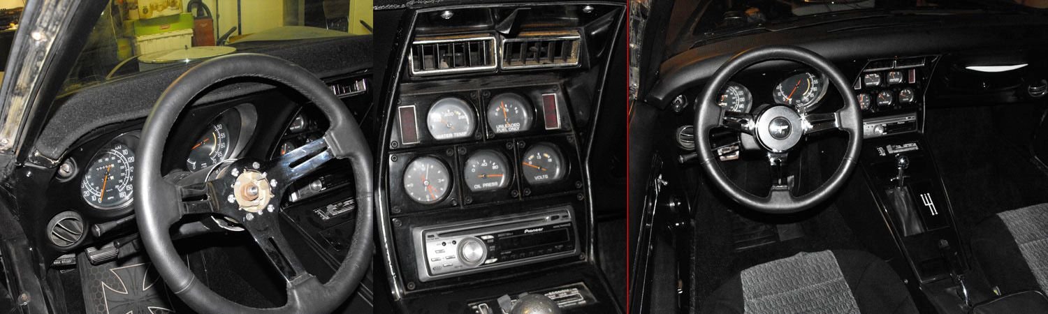

Very happy with it. Actually, I was surprised at how well it turned out.
I can't find a photo showing the gray interior, but here are some that I took after gutting it (again lol) to detail things. These show the replacement door panels and dash pads mixed in with all the small trim parts that were dyed black. It all has a very consistent sheen to it.

That looks good! My dash pad has a few small cracks and I was considering putting a dash cap on it? Rather than replacing the pad. My door panel are new, just the wrong color. How do you think the dye would hold up on the door panels? My interior just needs cleaning and dyed, of course new carpet.

I would think the door panels would turn out great if they are prepped well. What you see on ours is a dash cap as well. New pad in the future, but funds are going to other places in the car for now.
