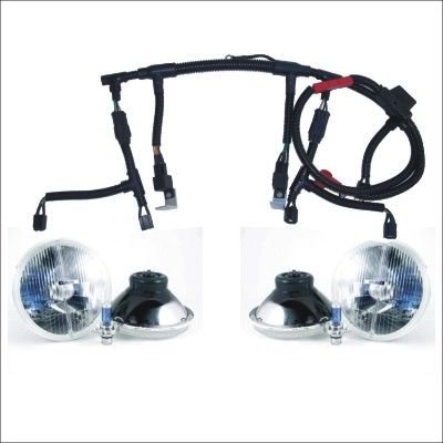

"Now, the absolute best way to fix the problem is to route wires and relays straight to the headlights. There are three things I don't like about this: one, it costs a lot, two, it is often overkill, and three, it is hard to maintain a stock look. The addition of this kit allows you to pull the headlight voltage from an alternate source (such as our Accessory Fuse Panel), distributing the total electrical load over more wires. This kit is a direct plug-in to your floor mounted High/Low beam selector switch and allows the battery voltage to bypass the factory wiring to the stock fuse box, the 40+ year old corroded fuse box, and the worn-out headlight switch. This will almost certainly brighten your headlights to a much more reasonable level."
The Speed Direct is a good one- I made my own-
Bought really nice ceramic plugs-large gauge wire- Copper wire not "CCA" which is Copper Coated Aluminum and is equal to one gauge LESS than the Copper as far as conductivity.
They are not all created equal- one on the right has much thicker gauge metal for the terminals-
DSCN4931 by Richard Hayes, on Flickr
notice the difference in wire size- again right side better- and that's aluminum wire -cheaper!!
DSCN4927 by Richard Hayes, on Flickr
since I'm adding fans -extra horns - electric headlight motors-and wanted better power to the lights- I added a terminal w/ 4gu to the battery-
DSCN5170 by Richard Hayes, on Flickr
12 gauge wire from relays to lights -
DSCN5143 by Richard Hayes, on Flickr
lights- Hella- 80/100w and 100w
relays for lights and headlight motors-
DSCN5160 by Richard Hayes, on Flickr
Only used the factory wires to trigger the relays-
DSCN5151 by Richard Hayes, on Flickr
Then used some AN braided hose to cover the wires
DSCN5154 by Richard Hayes, on Flickr
testing-
DSCN5157 by Richard Hayes, on Flickr

Has anyone tried this product. Claims 12 volts at the headlight.
http://www.ecklerscorvette.com/headl...relay-kit.html
The link is having trouble. Part number 25-362265-1
Yup. That kit will do it. If your battery shows 12 volts, thats what your lights will get. Or for a fraction of the cost, you can use your headlight switch (at the existing headlight high/low beam plug to power a relay/harness and build the same thing. I bought 4 ceramic plugs and play 3 pin connectors for the headlights as a brighter light has to shed more heat, and upgraded lighting can distort or melt 40 year old plastic at the headlight plug.
Either way, it's going to a noticeable improvement in lighting output whether you keep the existing lights or upgrade them.
When I first upgraded my lighting, the headlights switch couldn't handle the voltage requirements (amerage) of the new lights, and on high beam they would cut cut out randomly. After the harness and relay upgrade, works without a hitch.
If you choose to build your own for about 20 bucks, get a relay and pigtail from your local auto parts house, just realize the relay that comes with it is junk. So are the leads leading out of the NO/NC contact part of the pigtail. These are the ones that carry the headlight load. 8 and 10 gauge wiring is what I used for the project. You can remove the pins from the 3 pin plug and upgrade the wiring, then snag a handful of Bosch relays on a few late model salvage cars and your good to go.
Good luck!

Satisfied speeddirect user here. See thread https://www.corvetteforum.com/forums...t-upgrade.html for video.

The kit comes with everything and the quality looks like its there. But, are these upgraded halogens or HIDs?
They don't say on the website, but I would give them a call to be sure.
My intuition says that the bulbs included with the kit are HID and the bulbs sold separately are halogen because the price of the kit is more that the price of the individual parts

Originally Posted by Speed Direct
Yes it will, Rescue Rogers. Our NeverNight kit with the Xenon lights may require some clearancing in the headlight bucket but that will depend on your car. They are significantly brighter than even the halogens. You can also just go with the harness and you will still see a big difference. It is a plug and go design, no need to rewire connectors. NeverNight headlight harness and Xenon lamps
Forum members get a 10% discount on their orders. Also, this product was actually designed by a forum member. We bought that design from him and have been producing and selling it.
More explanation
What's the coupon code to get the 10% OFF? Just interested in the harness. Thanks!
