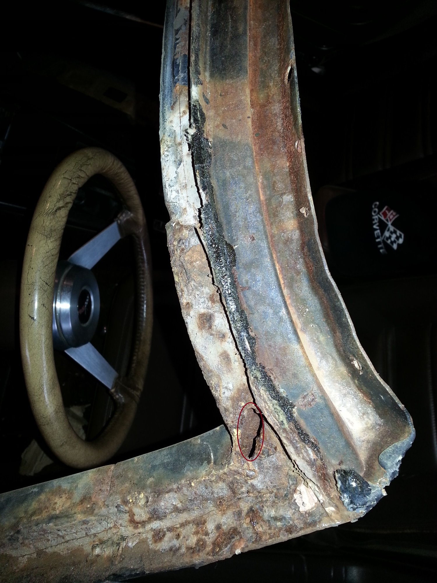

Here is the hole I found in the drivers side corner windshield frame. I ordered an inspection endoscope so I can see what it looks like from the inside. Based on just the exterior of the windshield frame it does need a new corner piece, but other than that doesn't look bad. I also saw what looked like a crusted over rust through spot on the the lower windshield frame until I realized the hole is supposed to be there and it was partially covered with sealant. How hard would it be to just replace the one corner? Thanks.

OK...I run into this issue often.
As I tell my customers...I can patch in a piece of steel to close up the hole. And they are AWARE that all of the rust that is inside the post/frame that I can not get to.
SO...if a person gets all caught up and OBSESSED on removing all of the rust....EVERYWHERE....then the car ends to be completely dismantled and the steel structures need to be dipped or what ever process to get ALL of the rust out of it.
There is a point where a decision needs to be made (if it had not already been made) on how far are you willing to go to get the rust out.
DUB
Thanks Dub!
I just plan to clean up the worst of it. I am planning to blow out any loose rust and use a rust encapsulator sprayed on the inside of the windshield frame. I don't need it to be perfect, just mechanically solid and last many years with the car being driven on nice days. I think I will replace the corner piece and evaluate the rest of the windshield frame.

Originally Posted by JimLentz
Thanks Dub!
Sounds like a good plan of attack.
