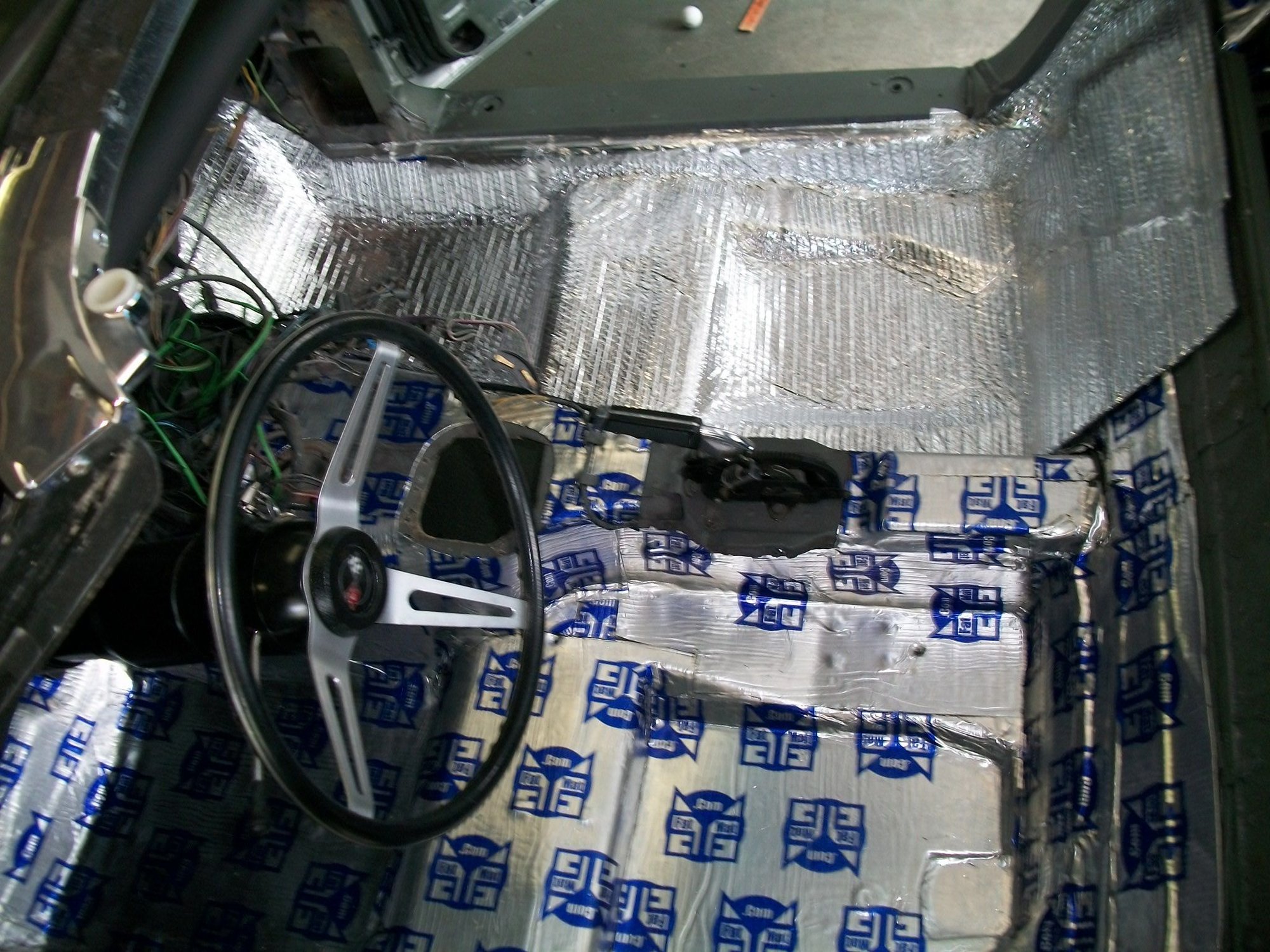

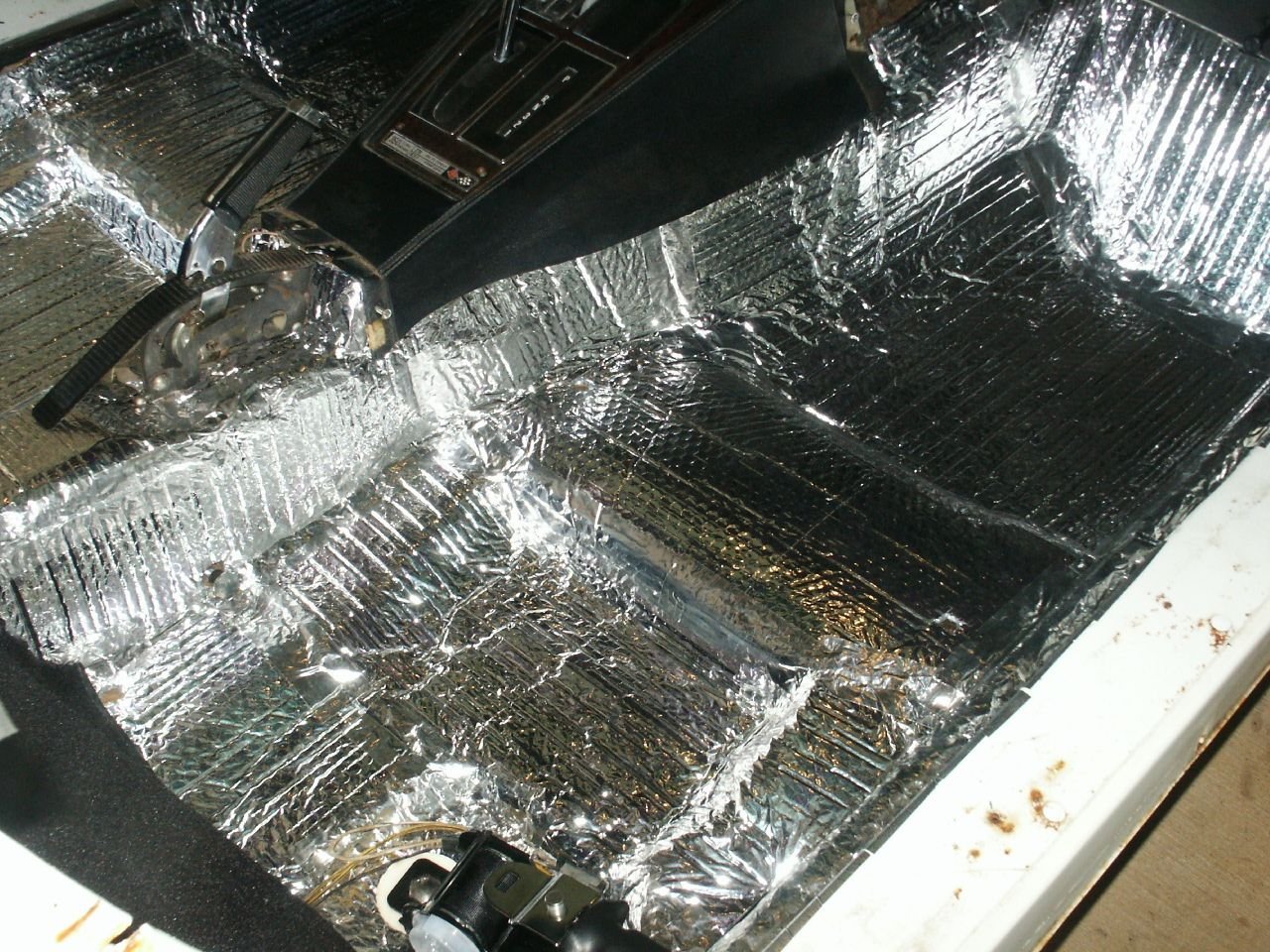

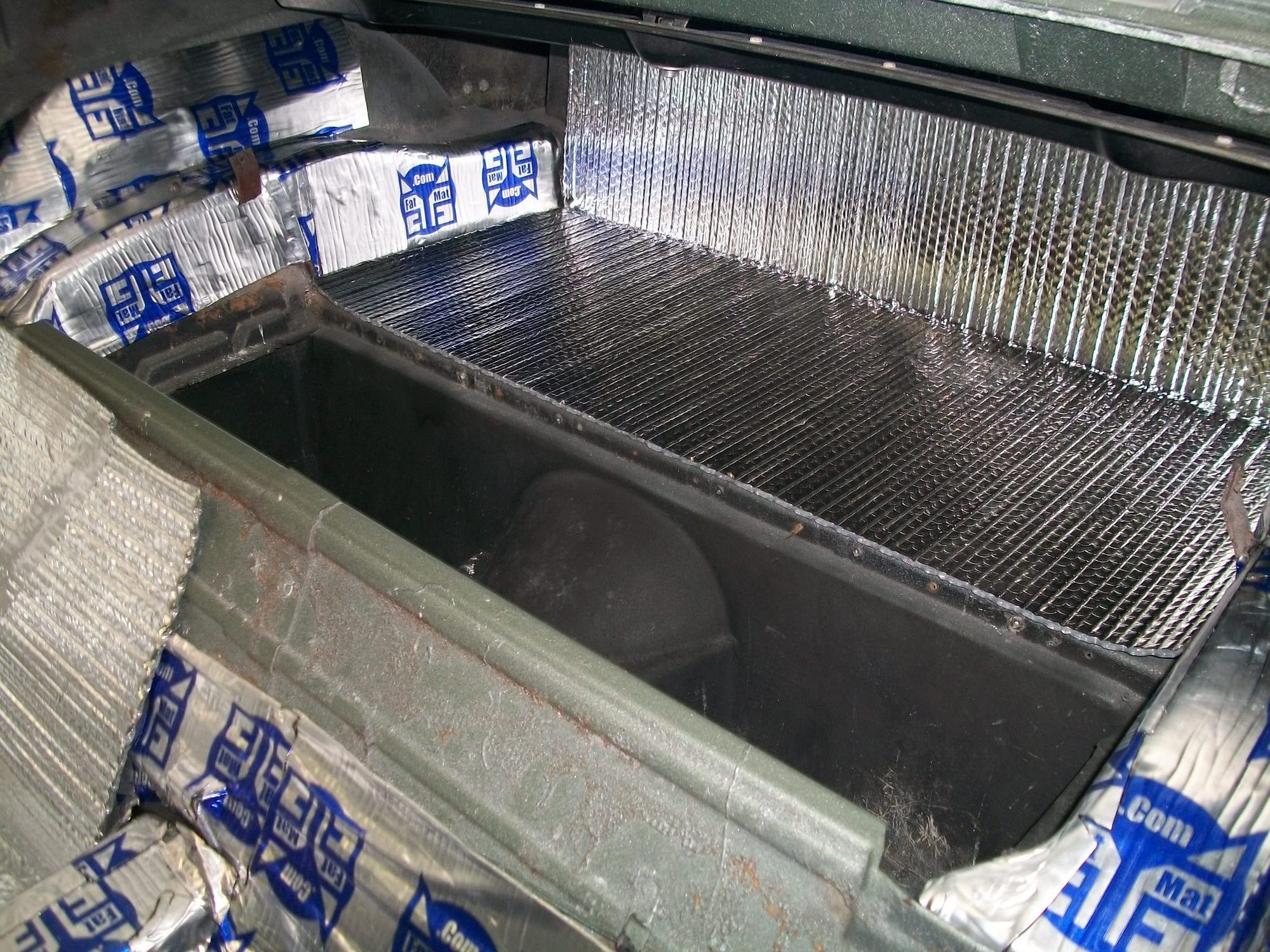

Originally Posted by sug
What is the best dynamat to use to stop heat in the interior and who to buy it from. Thanks Grant

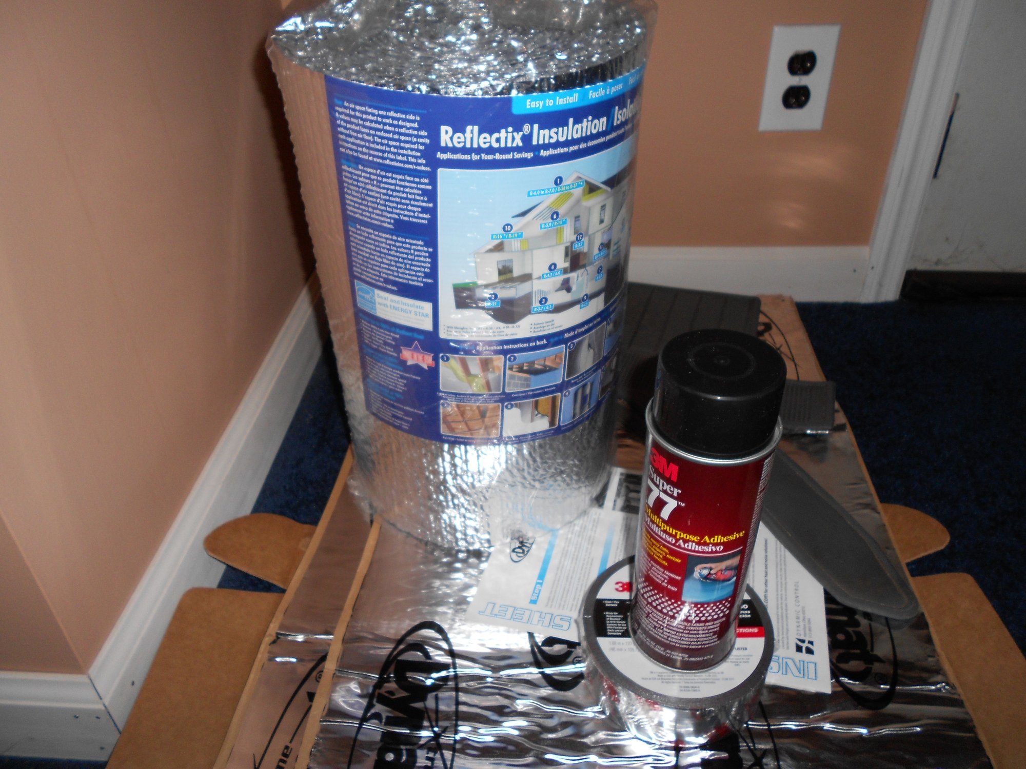

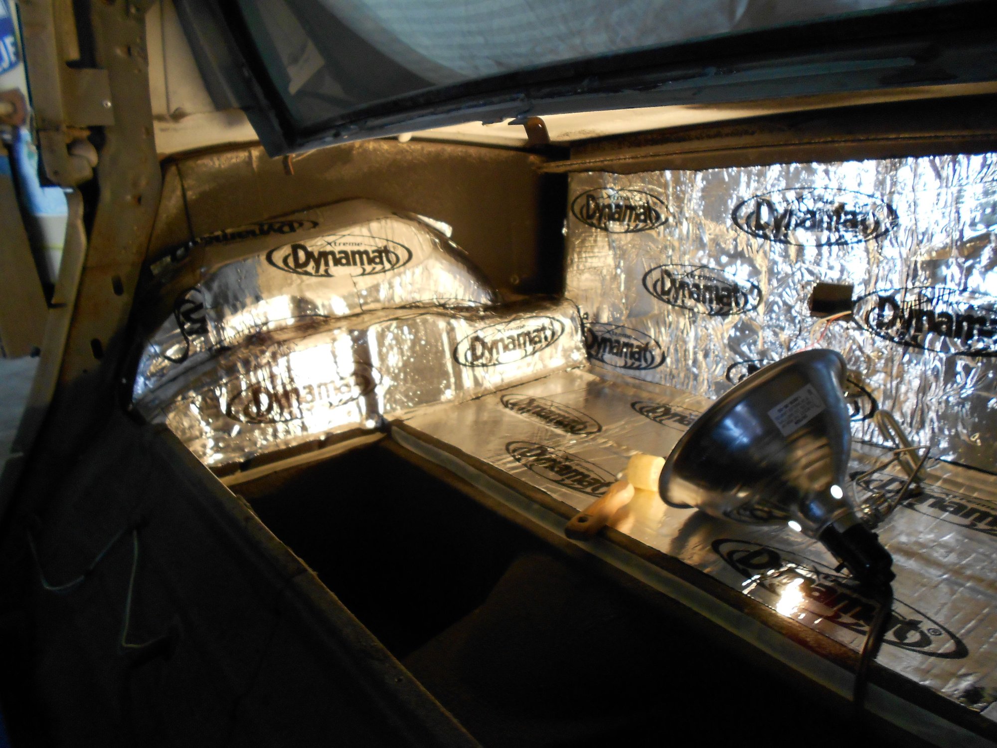

The mat is more for sound. Big box stores have a heat barrier called "Reflectix". Many people have used both, with mat on the bottom, and relectix over it.
Check around before you buy... there are several "mat" products out there, Dynamat, Hushmat, Fatmat...almost exactly the same, but WIDE variety in price!
I saved enough on the mat to add the reflectix ( including silver tape and spray glue!)

I've been very happy with the reduction of noise and heat from the combo of Dynamat and Reflectix.
A couple things worth noting: The dynamat has razor sharp edges, especially after trimming. Be careful when handling the edges.
Also when I got near the end of my project, I was a little short on the matting, so I ordered some hushmat. Same basic principle, but the tar-like backing and the foil of the dynamat was significantly thicker. Also dynamat had superior adhesion.
As earlier posters noted, the dynamat is for sound reflectix for heat. And the reflectix is very cheap in comparison.

Originally Posted by 7T1vette
IMO, the BEST heat insulation material is jute padding, similar to what was installed at the factory.
Agreed.... but there is jute padding on the back of the carpet also. So with the mat, reflectix, and the backing on the carpet, I`m hoping that will do it!
One other note is that I had to trim a little of the jute padding off the back of the carpet to get the push plugs into the back wall, the footman loops for the T-top straps, and the dimmer switch.

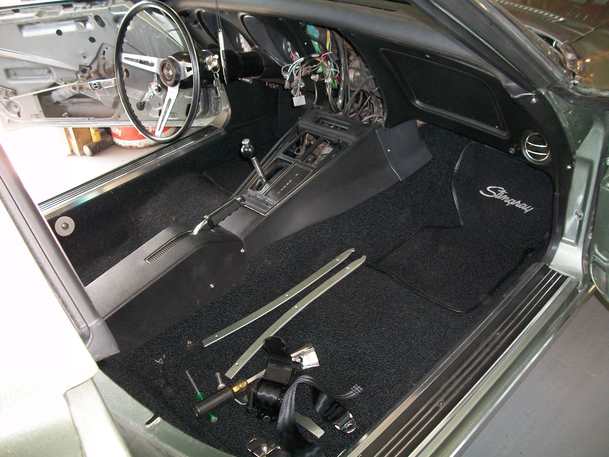

Originally Posted by mdeslyper
Doesn't all the layers of hushmat, reflectix, and jute padding on carpet cause fit issues on new carpet installations?
Except for the couple spots I mentioned above, it didn`t for me. Whatcha think?

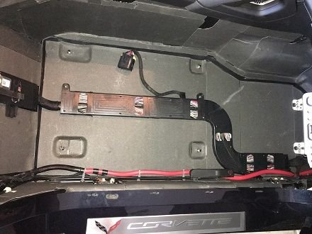

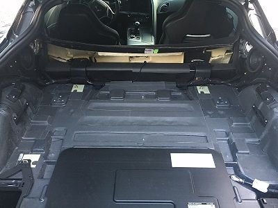

Here's another alternative..
Blockit DeadMats
• Extremely effective at eliminating unwanted vibrations, noise & rattling!
• Light Weight!
• Performance to weight ratio is amazing!
• Improve your audio’s sound quality!
• Textured top layer looks great once installed! (No "tin foil" appearance!
• Very durable. Won’t rip, tear or break down overtime!
• Helps reduce heat!
• Simple peel and stick application!
• Apply to any make or model where it’s needed!
• All raw materials are from the USA!
• Made in the USA!
• Manufactured under strict ISO 9001 regulations
• A Great Addition to the Blockit “Quick & Quiet” Mats
Blockit Dead Mats use a unique technology to eliminate unwanted vibration & noise in your vehicle.
It’s not your typical mass loaded vinyl. The light weight mats are a highly damped proprietary mineral filled viscoelastic polymer which provides outstanding sound & vibration reduction. At only .445 lbs per sq ft the performance to weight ratio is amazing. The bottom line is The Blockit DeadMats are designed to simply not vibrate!
The self adhesive backing makes for a simply cut and stick application. You can either completely cover an area, just a portion of an area or strategically place them with outstanding results. Blockit Dead Mats can be stacked to double up on vibration and noise reduction. Blockit Dead Mats, are fantastic on their own or in addition to compliment the Blockit Quick & Quiet Mats.
We know there are some areas that require damping and are not hidden or buried under carpet. The Blockit Dead Mats have a textured surface layer which is durable and has a nice clean look when exposed.
Available in:
★5 18"x32" Sheets (20sq ft) http://store.tkoperformance.com/bldema185sh2.html
★9 18"x32" Sheets (36 sq ft) http://store.tkoperformance.com/bldema18x329.html
or 9 18"x32" sheets
Under C7 Seat
Cargo
Door
Click Here to watch what a small 5" piece of DeadMat does! Imagine what DeadMats can do for you!
Available in:
or 9 18"x32" sheets
Oldgto highlighted the main areas.
I had to trim back a few places where the trim met the carpet.
Anyone not insulate behind the seats? Does it get hot back there?
Looks Great!
New carpet is just so nice to see.

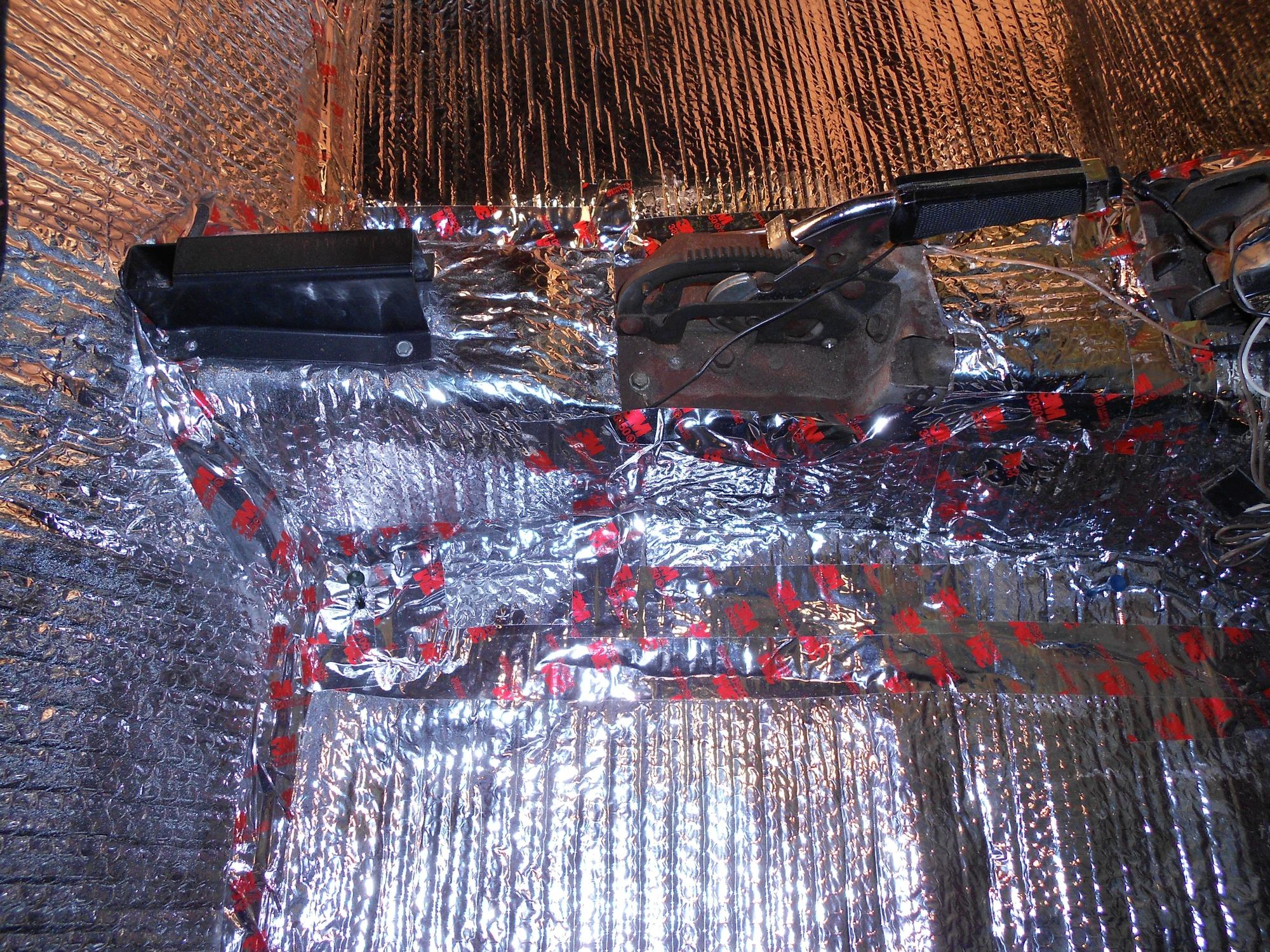

I used ACC carpet from Willcox and reflectix everywhere and didn't
glue any down. Drove this summer and the interior never got hot.
As you see, I live in Louisiana so I think this was a good test.
I covered the back as well as the floor because I think it will help
the air conditioner stay cooler. ( The air is not hooked up yet and
the vent keep me cool this summer.)
