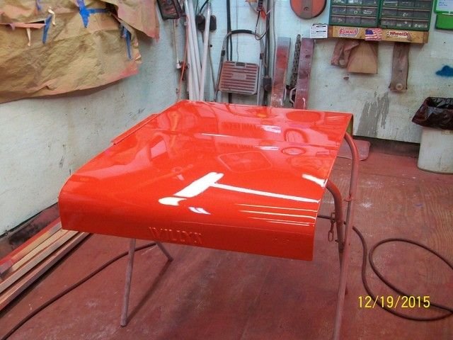

I have painted a truck of mine using rustolem and sprayed it, it looked decent, but rustolem is not very UV resistant, you will be constantly waxing it to keep it shiny.
Look into Summits painting line, you can buy their 2k high solid primer for $100 and a gallon of their single stage paint is $120, this is for automotive paint.
If you do not have the ability to spray the material, I would have a body shop shoot the primer. Bring the car home and sand it, then have them shoot the paint.
This is my ****** that I am currently painting using Summits single stage and it works great.
