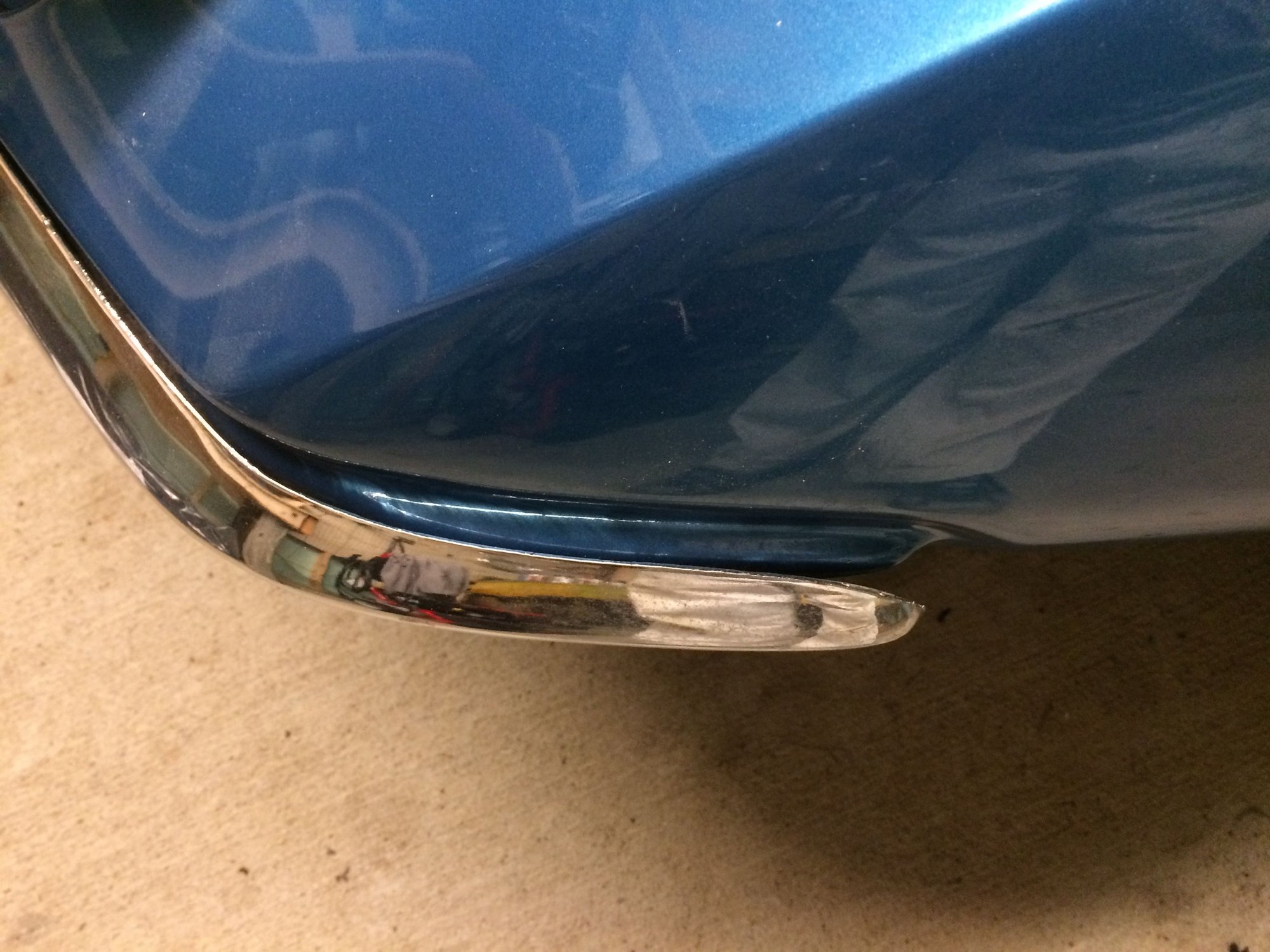

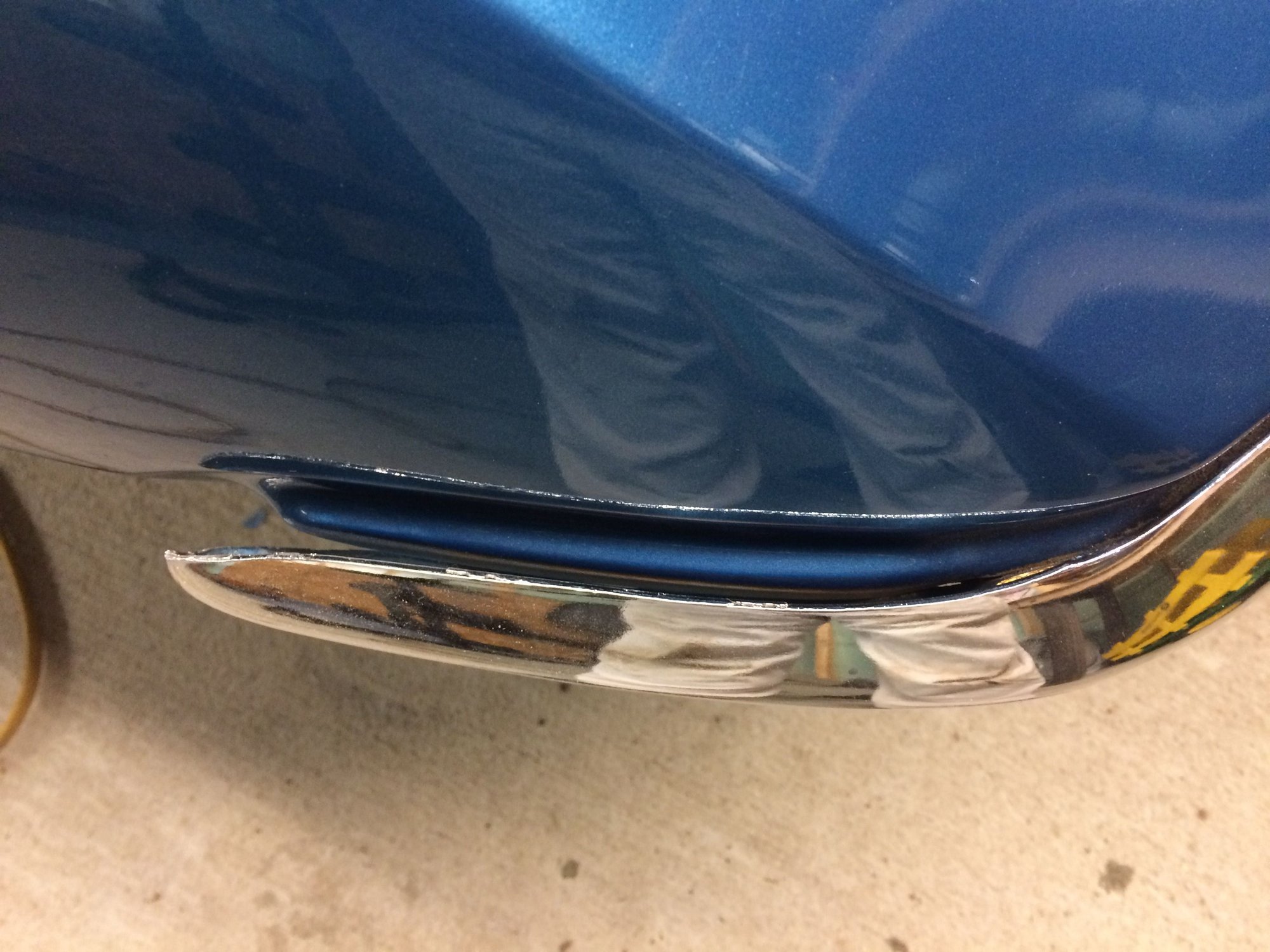

Ok senior CF guys I need your opinion. I have 1972 and I'm starting to think this bumper is not original. Thoughts? Should the gap be that wide? I can't find any sign she's ever been wrecked.

well my 72 ,the bumper fits tight all around!!

Bill that is what I was thinking. I'm guessing bubba found one and just put it on. I think I'm going to get a correct fitting front bumper.

The AIM say 1/2" gap, so I would measure and see if you are close.

The new repo bumpers all look like that. The original ones fit the sides like the rest of the bumper. Another case of ill fitting repo parts.

My 72 has the original bumpers that I just had re-chromed and they fit perfect . That is why I didn't use reproduction which definitely looks like you have.

Thanks everyone. I got it off today and based on what I see I actually think it's original. Now the question is to get a repro or have this one rechromed.

If it is original you have other problems as originals fit fine on unhit front ends. My bet is yours is a repo.
