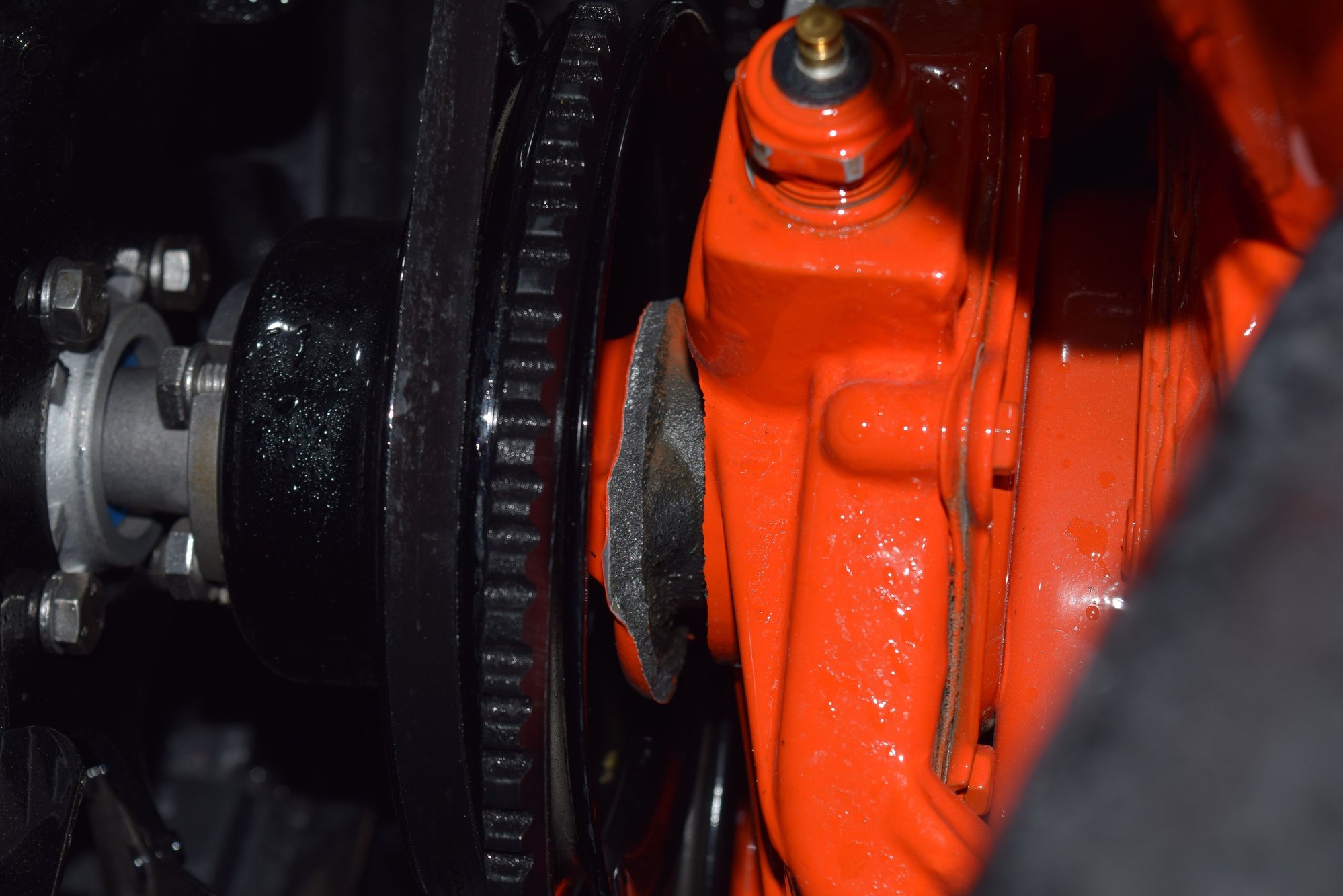

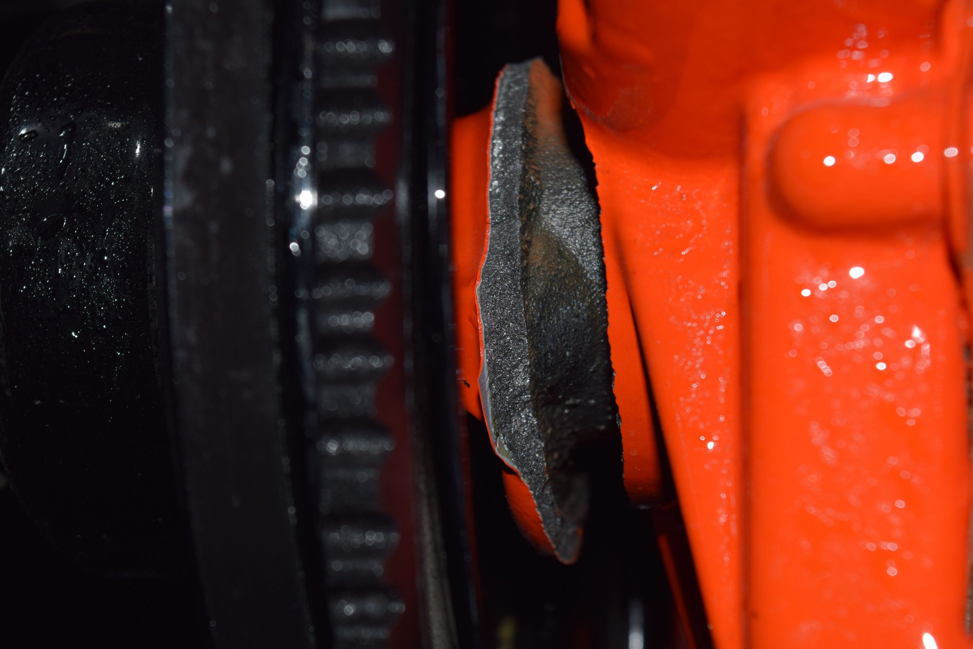

Well, as the title states, today I experienced an epic failure. I hadn't been able to tinker with my project for a while because we are selling the house, yada yada yada... So today I decided to fire it up to help motivate myself and boy did she sound good! A quick wrap on the throttle and BAM, CLANK, CLUNK and it's raining in my garage. I shut it down and this is what I saw...
So much for the motivation thing!!! And there's coolant EVERYWHERE!!! Anybody ever experience their water pump come apart? It's a brand new pump from NAPA. Must be of awful quality!!!

It looks like the bearing seized and took part of the housing with it. What is the deal with the one belt inside out ? Looks like it jumped off when the shaft seized .

From what I could see no, it doesn't appear that anything got torn up. I just had to walk away so I haven't dug into it yet. That's tomorrow hopefully. I just went back out to the garage and the radiator is fine, shroud looks good and the fan blades look good. The hole on the front wasn't quite big enough for the impeller to come out so the fan only came out as far as the pictures show. The belt flew off immediately so it stopped pretty quick. I'll know more tomorrow.
The belt was on correctly and whatever happened happened FAST! The belt wound up inside out after all was said and done.

WOW! That makes me wonder if a stray lock washer/etc. wedged itself in the impeller

Yep. Complete bushing/bearing seizure. Belts must have been really good for them to torque that cast iron casting apart! I'd say you were pretty lucky not to have been on the road and not to have had any secondary damage.
A bummer for sure....but a new water pump will fix it.

The alternator belt is the only one that came off (and turned inside out). The alternator is spinning freely so I don't think that was an issue. Puzzling to say the least!

Funny you mention that Tony. I was bouncing this off of my dad because he was a mechanic all his working life and he's never seen this before. His theory is that maybe there was a loose piece of metal in the water passages that found it's way to the impellor. I'll get a better look inside the pump tomorrow when I yank it out of there.

WOW that is UGLY!! Have heard of that being possible or happening, but that is a first to see. Might change my belts too considering what they just went through. Either that casing was cracked or something wedged in the impeller. That was the lifetime guarantee water pump wasn't it? If it wasn't I would be getting one!
