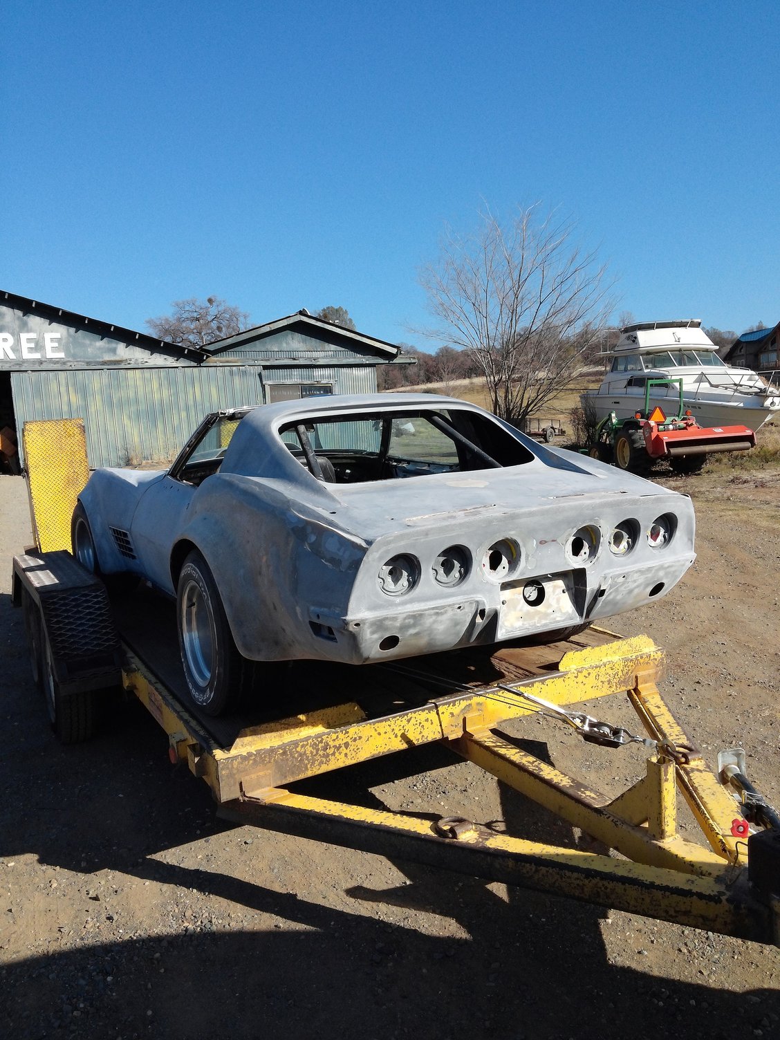

Ask the person doing baking soda blasting if he has done corvette work before? Dustless is different and lot more pressure.
Wes
This was done with high pressure baking soda worked fine but operator was experianced
