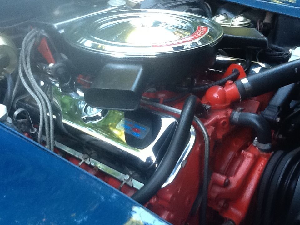

Congrats and welcome to the LS5 club....
To The 71 Arrived!

Your LS5's brother from another mother
