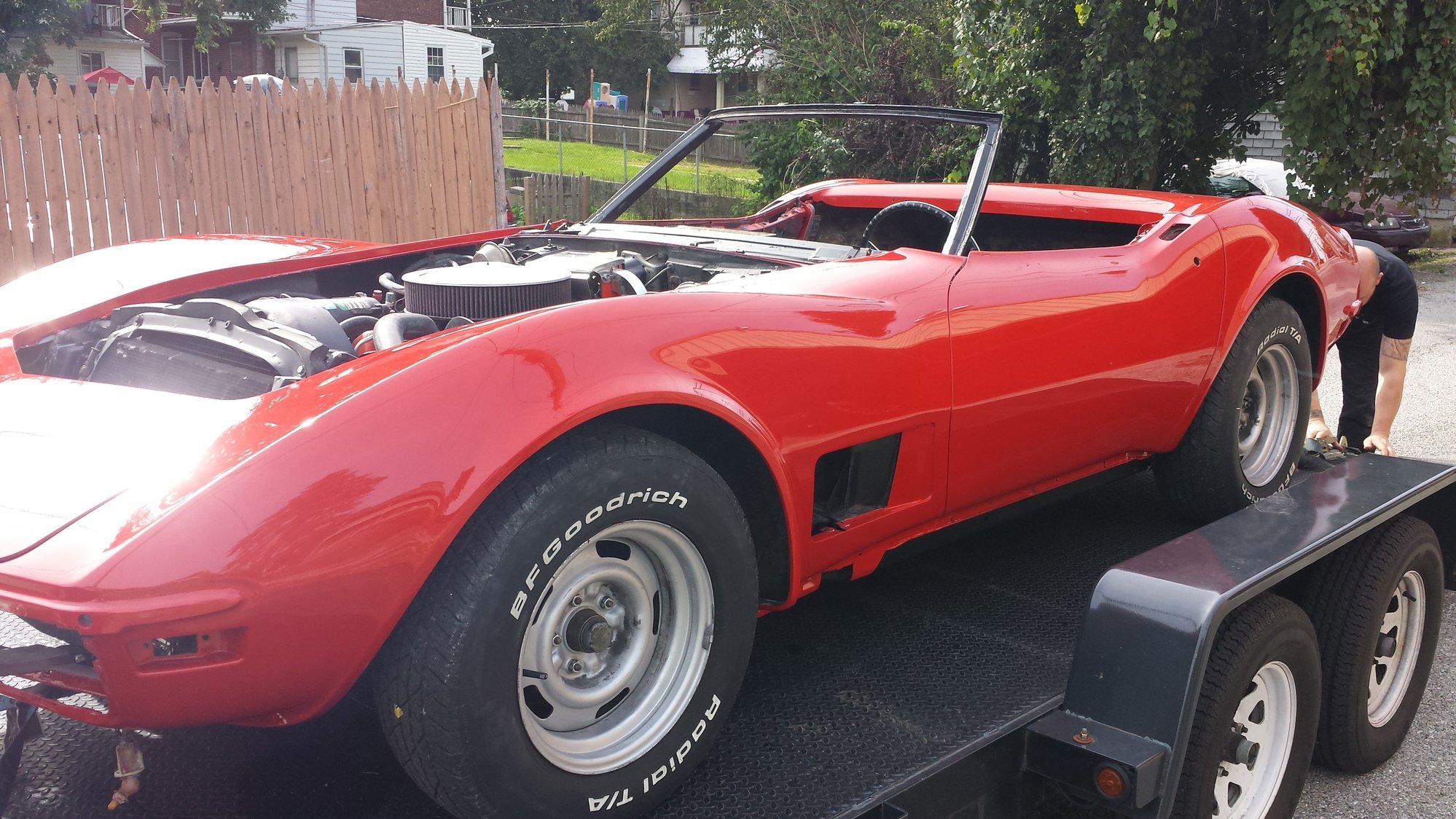

a couple of pictures of what I have done so far. The car is all original with original paint.

I had the car painted and the guys who did it talked me out of not taking the body off. I am about 8 bolts from taking the body off. After they painted it they mentioned I should detail the engine compartment since the exterior was so nice, the engine bay and interior needed freshened up. I agreed and started into it. As many know it just mushrooms. Where do you stop
I have everything either out of or off the car except for the rear suspension. I have rebuilt, repainted or will replace everything that goes back on, i.e. suspension parts, A/C parts, wiring, etc.
This is an older picture but nothing is left in the engine bay except some wiring which will be replaced. Since I had it painted, I wrapped it in foam which is what was used by Harley for their painted parts when I was working there.
So now I am seriously looking at removing the body to completely finish it. Already painted the frame that I could reach with KBS coating. I have a new set of brake lines and getting new fuel lines.
I have searched on the forum about removing the body and I have the plans for the cart. Looking at the body lift straps from the suppliers but even have heavy duty rachet straps. I am going to put more cushions and protection on the body since it is painted. Doors are on and latched for extra stability. Most of what I have seen shows the radiator support still in the car. Like I mentioned everything is out of the engine bay. What extra support is needed on the front end and where do I hook it to?
