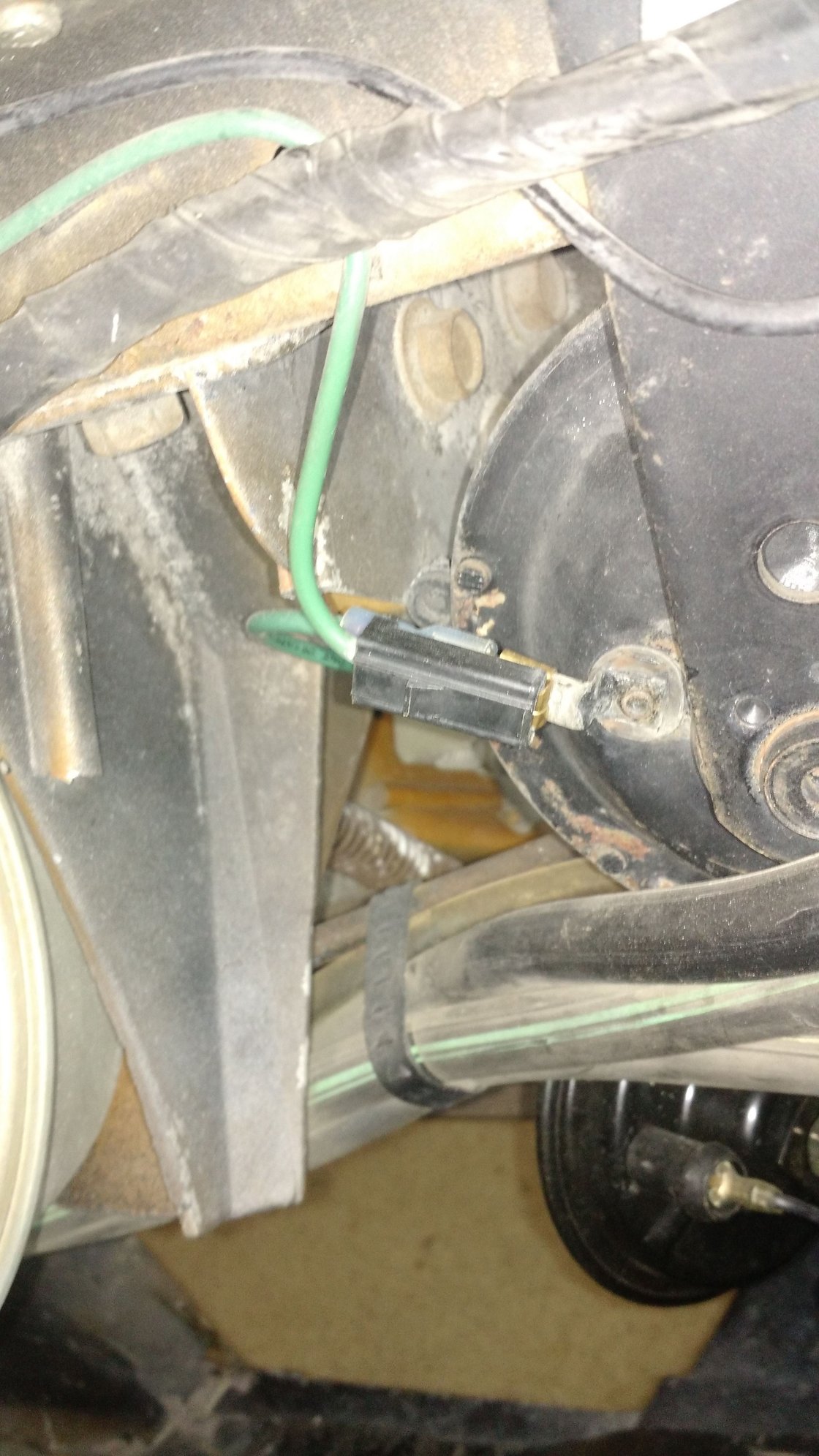

I bought a high note at O'Reilly's for about 11 bucks. I mounted it under the same bolt as the other horn and hooked the short jumper from one to the other. Also at O'Reilly's you can get a small plug on 2to1 y adapter and plug it onto the horn you have and then plug both horn's to it and not have to do any wire splicing.

My mistake, I didn't have room to mount under same bolt, so I used a grill support bolt below it. Here's a picture, the second picture shows the two for one spade adapter to avoid cutting wires.
