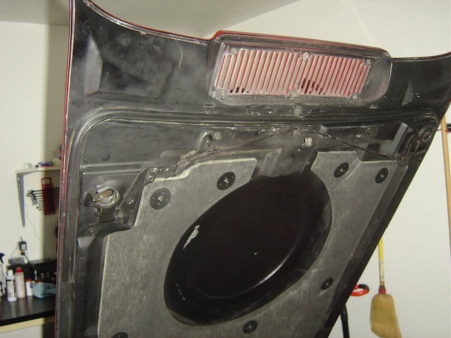

Oddly enough, I think this is your hood
With a piece of something thin/stiff like welding rod (coat hanger might be too big but would work) On the passenger side, sneak the wire in from the windshield and grab the cross over cable anywhere between the center bolt and the passenger latch, closer to the latch the better.
When you pull on the cable (even though you have the sleeve) it should be able to unlatch the passenger side latch.
In theory, you should be able to see a little of what you're doing and again in theory, push the cable into the sleeve on the passenger side might unlatch the drives side but in reality it'll probably not but you should be able to see enough to use your coat-hanger to get at the end of the cable where it hooks to the drivers latch and trip it that way

I thought this through last night. Given where the cable broke, there must be a lot still in place. I pulled on the metal sheathing from the handle apparatus and sure enough a steel cable was exposed (bottom right of pic, a little hard to see). A sturdy yank with pliers and the hood popped open. A new cable is on order. Thanks for the suggestions!
