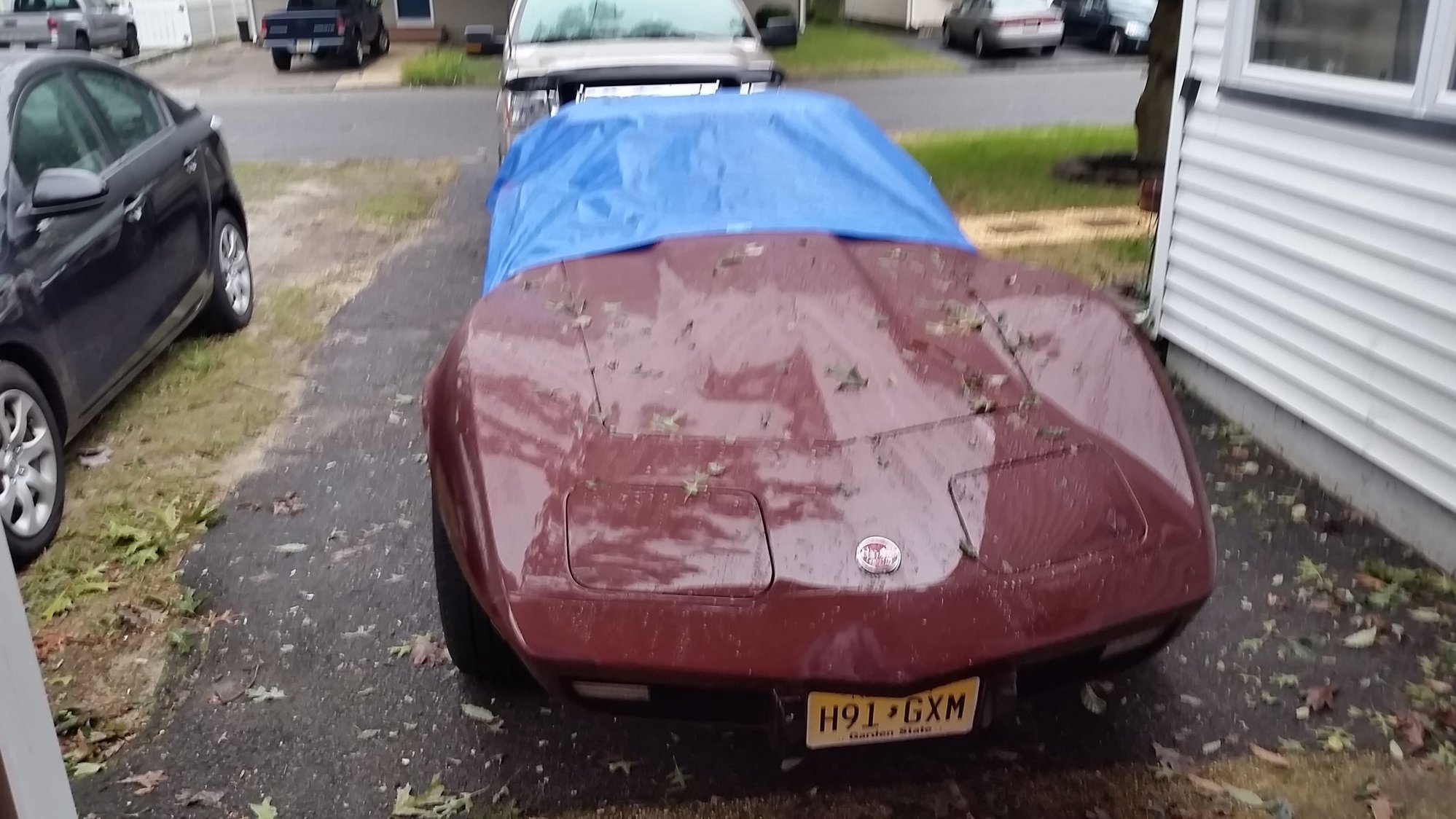

5 STRAIGHT DAYS OF RAIN... I was off work for 3 of them... SON OF A &!+(#!!! I got things to do, dammit! ...Day#6 coming up....
