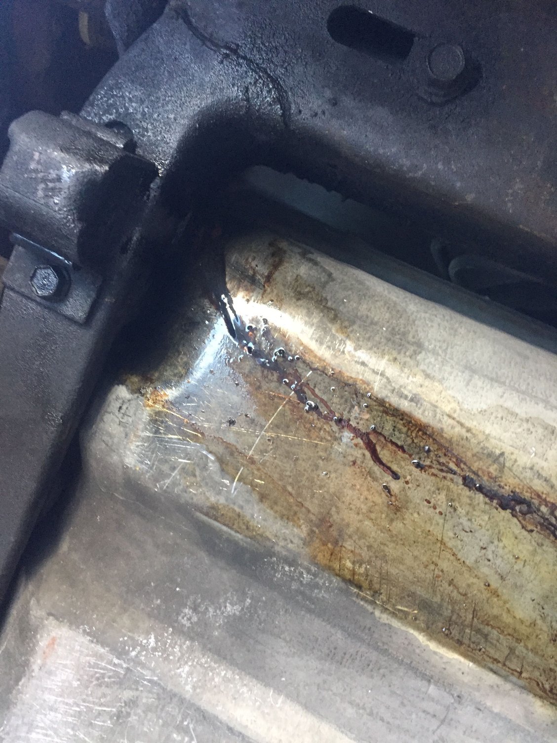

I just noticed the fuel tank has a minor leak after smelling gas for the last couple days. What do y'all recommend?
Passenger side right under the tail light

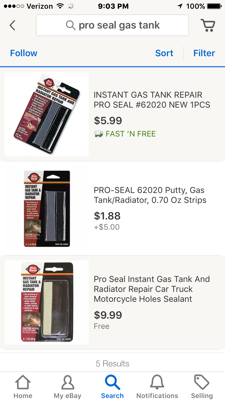

I heard pro seal is done good stuff would y'all recommend this?

I think when the gas tank is only about 3 feet behind the back of my head, the last thing i would do is try and putty it up. A new tank is only about 200 bucks from any forum vendor.

Are you certain that it's the tank that's leaking? Can't really see the point of initiation from that photo. How about the plastic fuel separator gizmo? ..rubber hose?

I've varified it is nothing on top and is only located in that small section.. guess I gotta try POR.. this vette is just one thing after another...

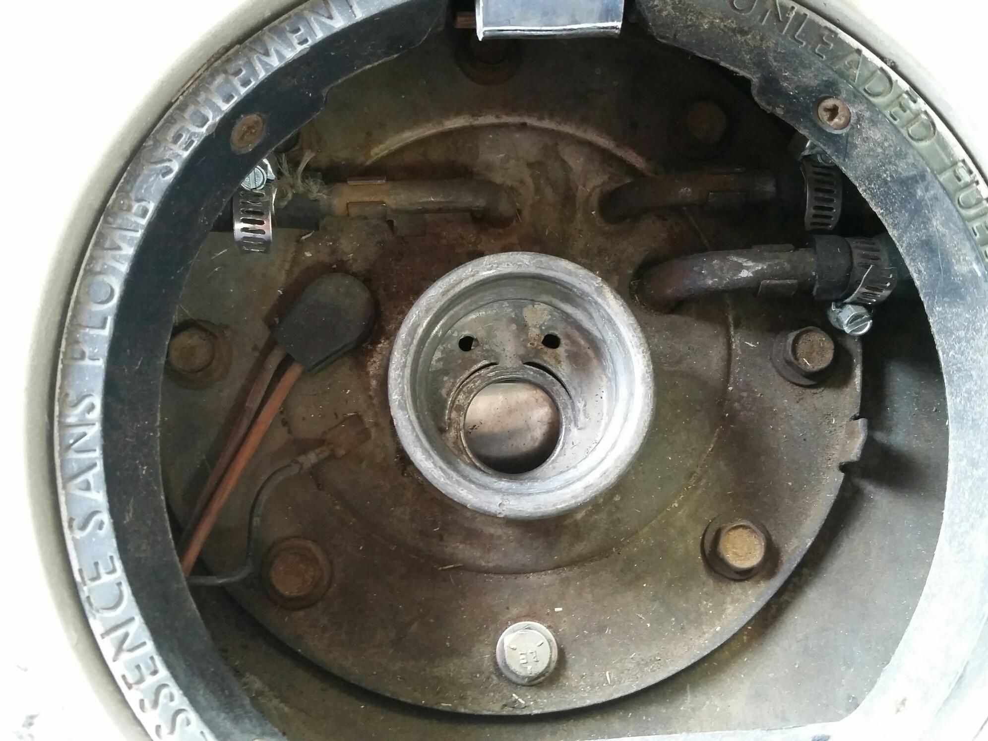

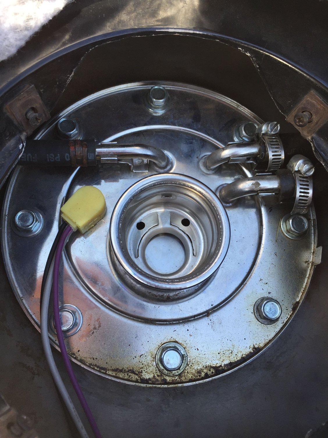

Here's my question why does someone's tank have the ground wire by itself and mine has it into a factory 3 pin harness?
Someone's original tank
My new sender

I ASSUME because you are not letting us know the year model.
Your car HAS to be a 1982...and that is why your wiring is different.
Always post your year model. It saves people time in guessing or having to look up your old posts to find out.
