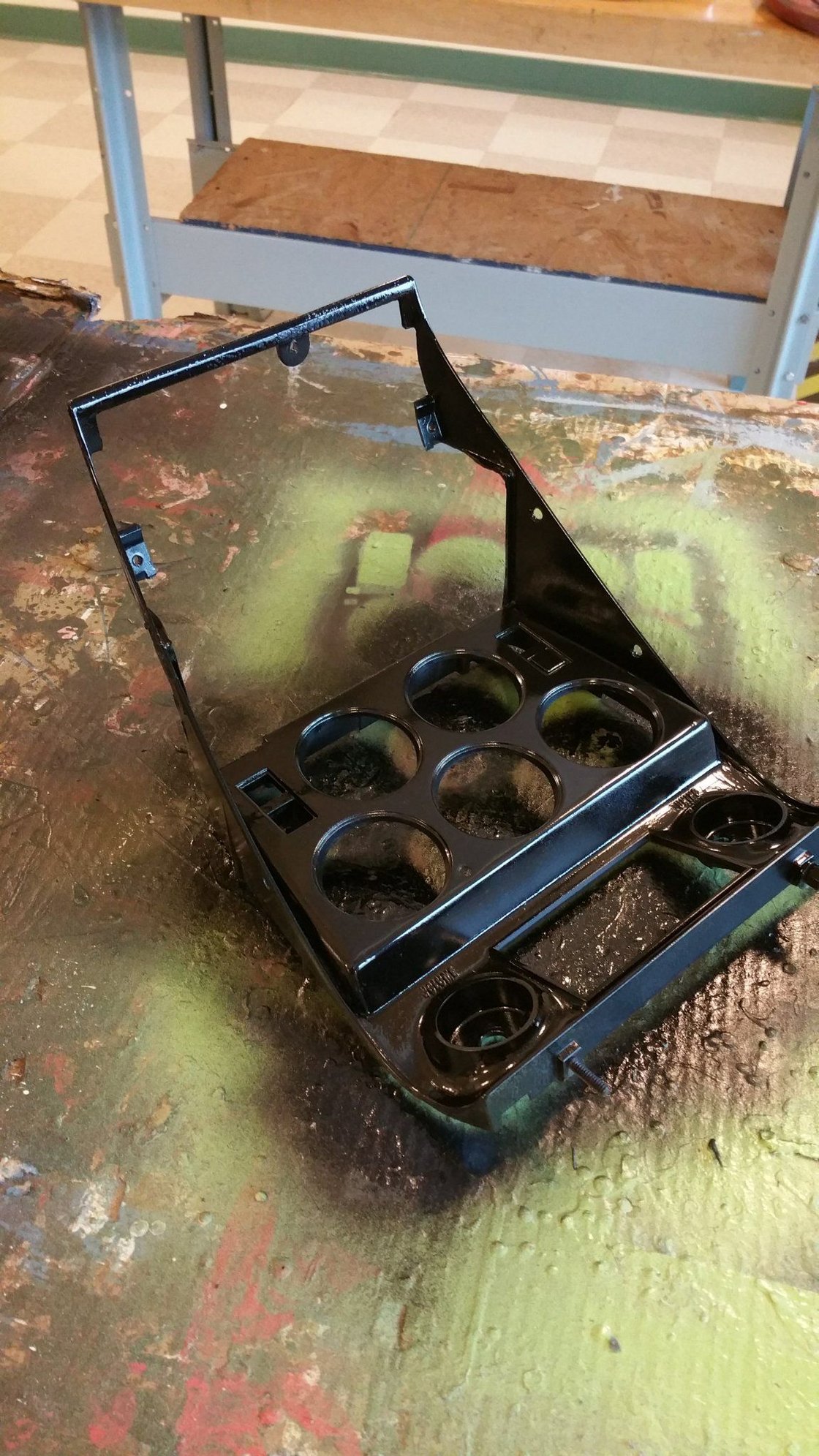

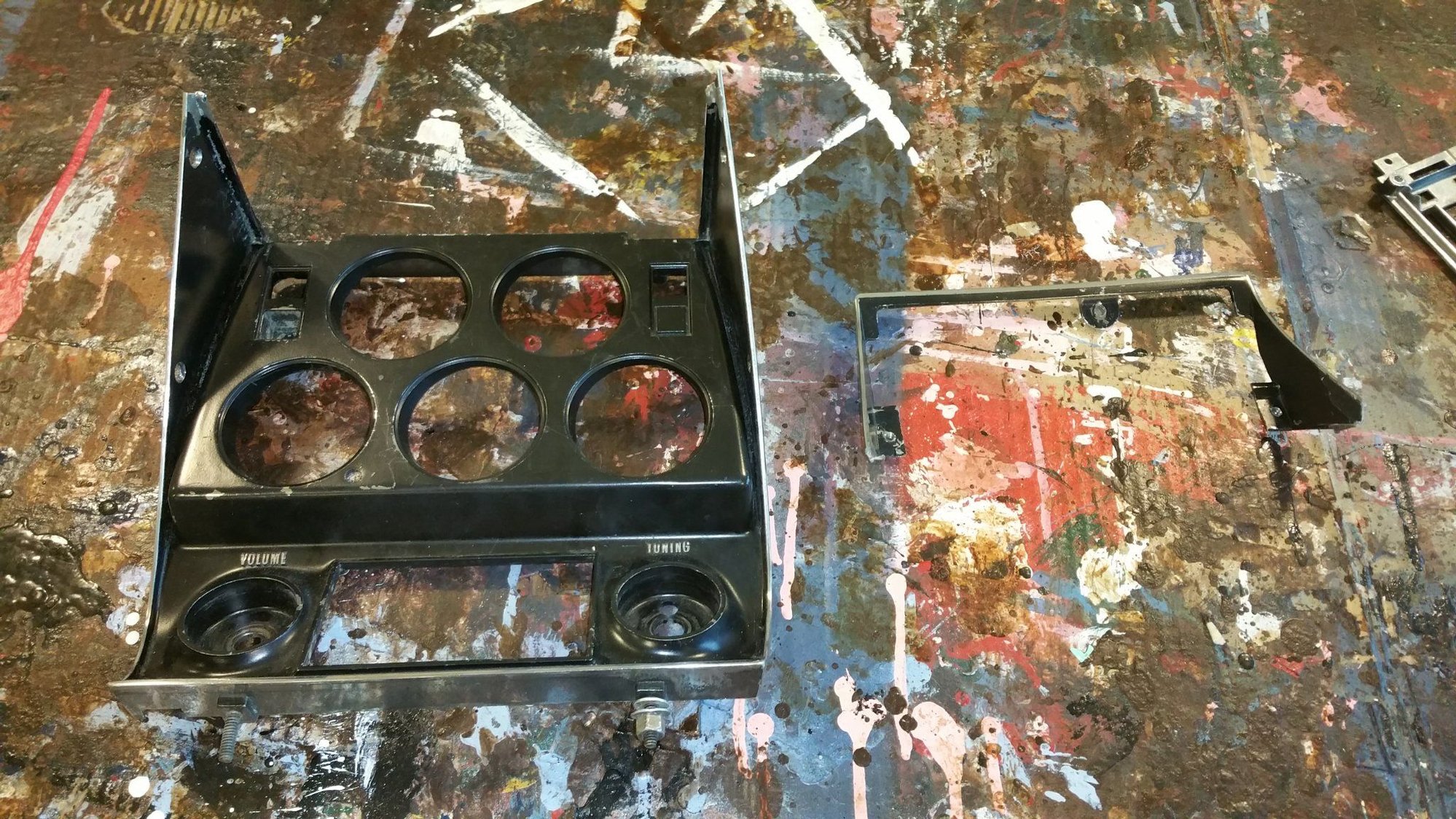

Ive repaied 2 that came out nice. My original 68 and a 69 that I have installed. Its pretty easy and looks.good when its done
I used a glossy paint because I wanted the shine, but it can easily be stripped and repainted to the satin

Old Oct 28, 2016 | 08:45 AM
7T1vette's Avatar
7T1vette
Posts: 37,637
Likes: 3,118
From: Crossville TN
It would have been better to strip ALL paint from the part before re-painting. You will always be able to see where the paint was worn off prior to the re-paint....especially with glossy paint.
