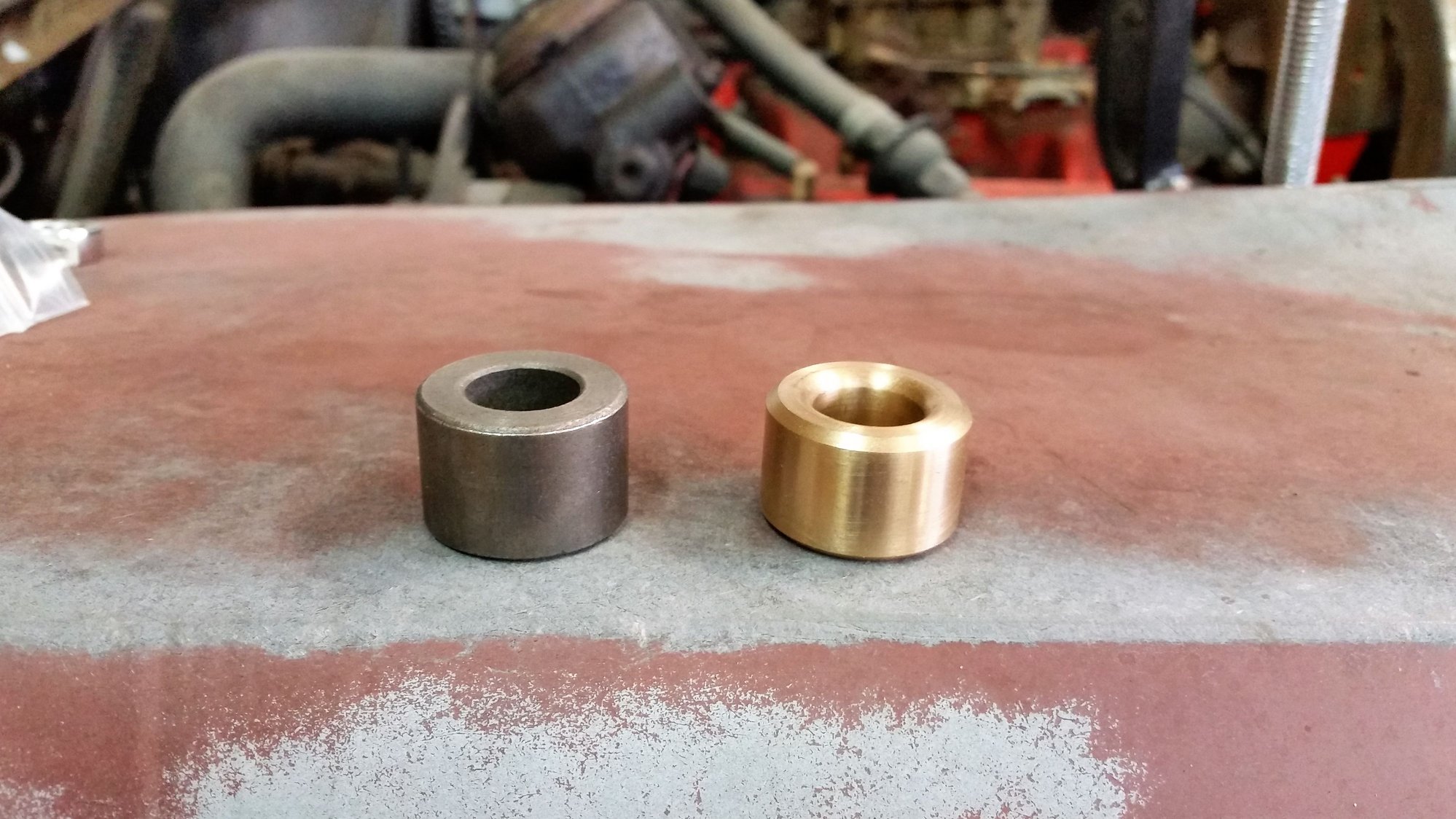

Magnetic bearing on the left, beveled edges also help. Once the old one is removed and you make your choice the bearing on the right sat in the freezer over night and went right in the next day. Mentioned by the manufacturer. Good Luck, I used my dremmell to remove 50% and found that helped me in the removal.
