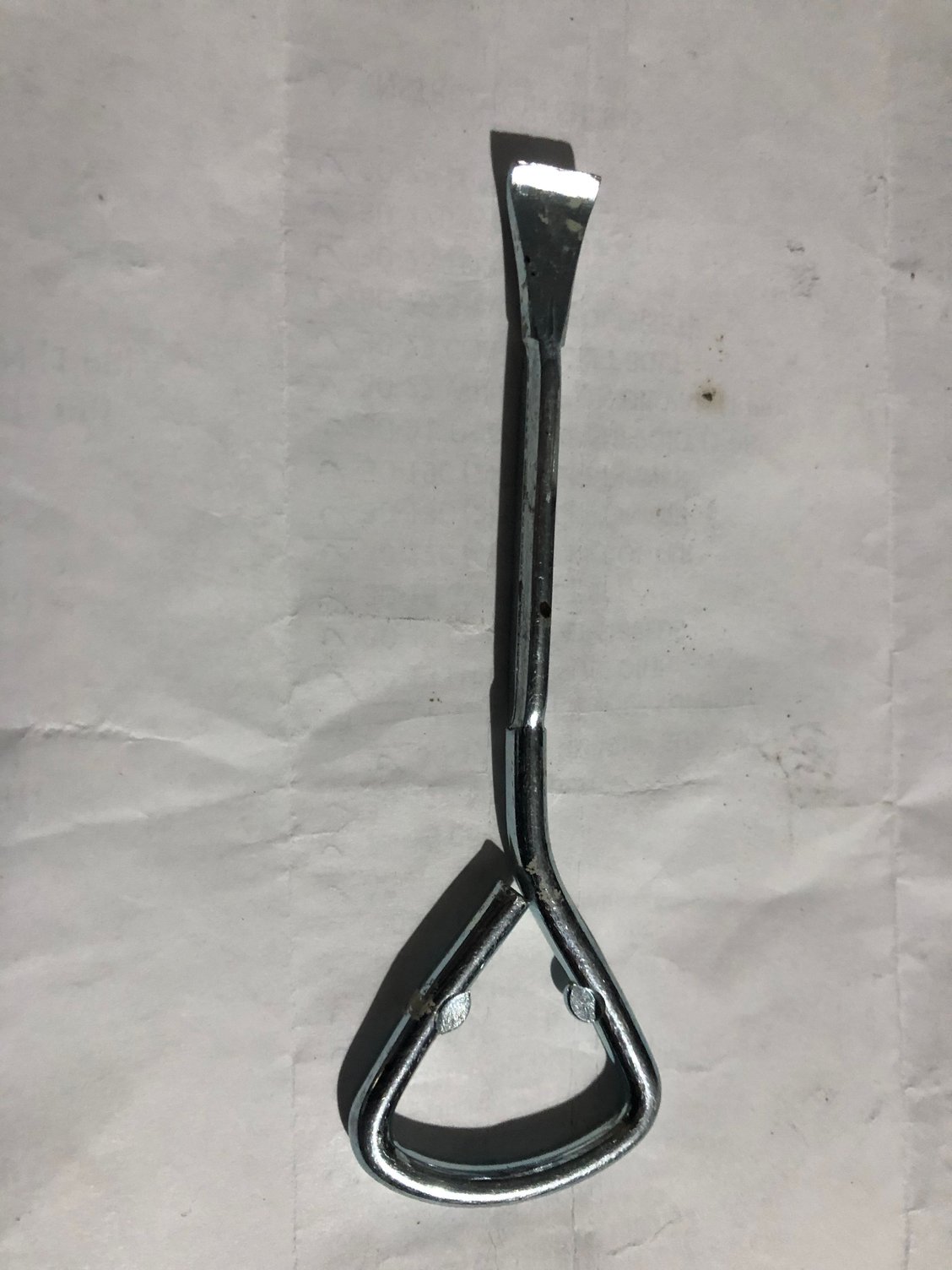

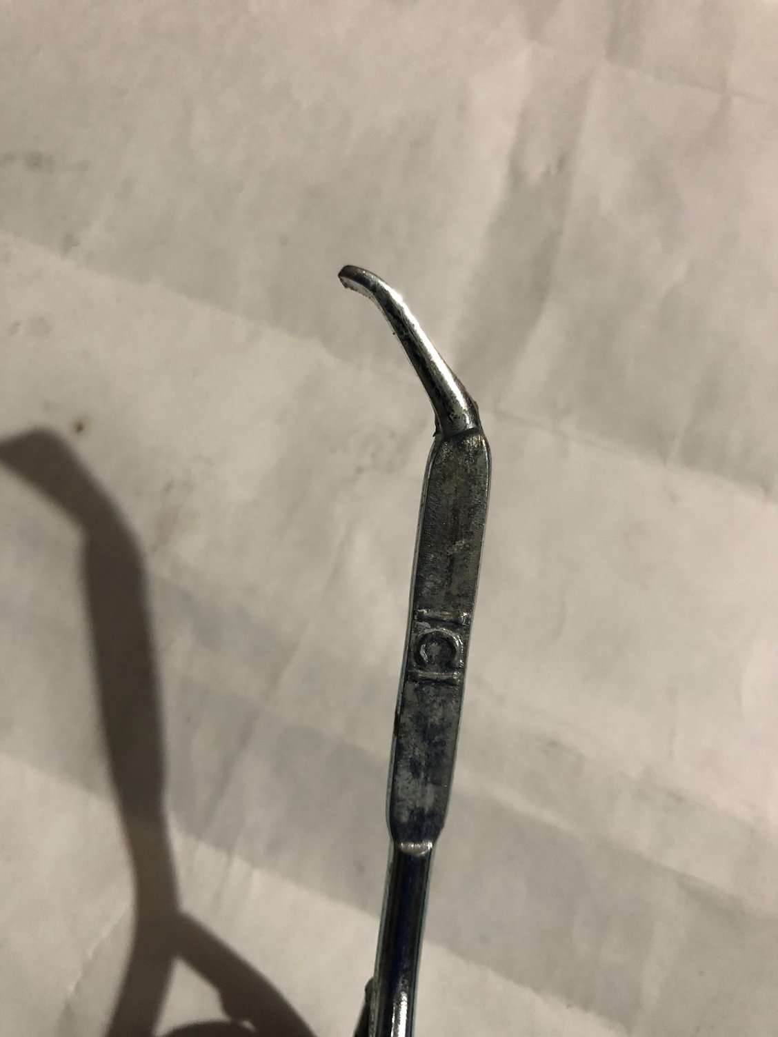

Old Apr 15, 2020 | 12:04 PM
C2search's Avatar
C2search
Joined: Sep 2019
Posts: 248
Likes: 55
From: Alberta 🇨🇦
Default DIY windshield wiper arm removal tool
Originally Posted by Kevin68
I'll rarely decline the opportunity to buy tools but if I want this out sooner rather than later and hope to never do it again....
I found the the clip after a little cleaning with PB Blaster.
You say to 'depress.' That could mean I'm going to push down to the floor. In your view though, depress could mean I'm going to pull up relative to the floor.... I'm thinking i'm going to make a tool tool pull the tab upward. ???
Thanks
I realize this is an older post but wanted to pass along my experience.
I couldn’t find the tool locally and didn’t want to wait for shipping so I made my own tool using a paint can opener. I put it in my vise and bent it to get a better prying angle.
After covering all surfaces to protect them, I just used a small rolled up piece of cardboard as a fulcrum and the wiper popped right off👍🏻
