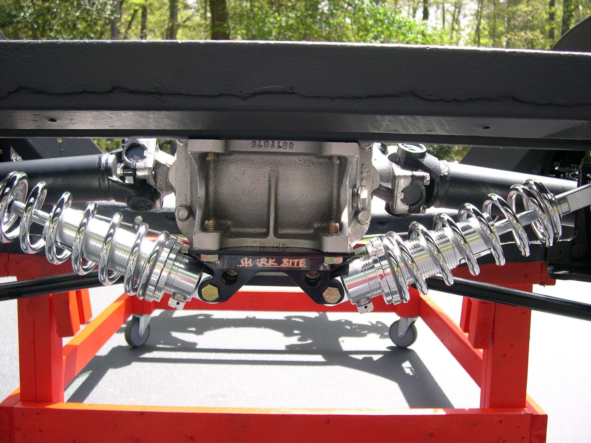

I have had them on my 68 for two seasons now and just love it. I needed mostly for ride height adjustability. With a performance rubber/wheel combo and a VBP mono leaf rear it is hard to beat. Ride and handling are fantastic.
Currently running Speed Direct Coilovers with Viking Double Adjustable shocks, Van Steel 400lb springs. VBP 340lb rear monoleaf
