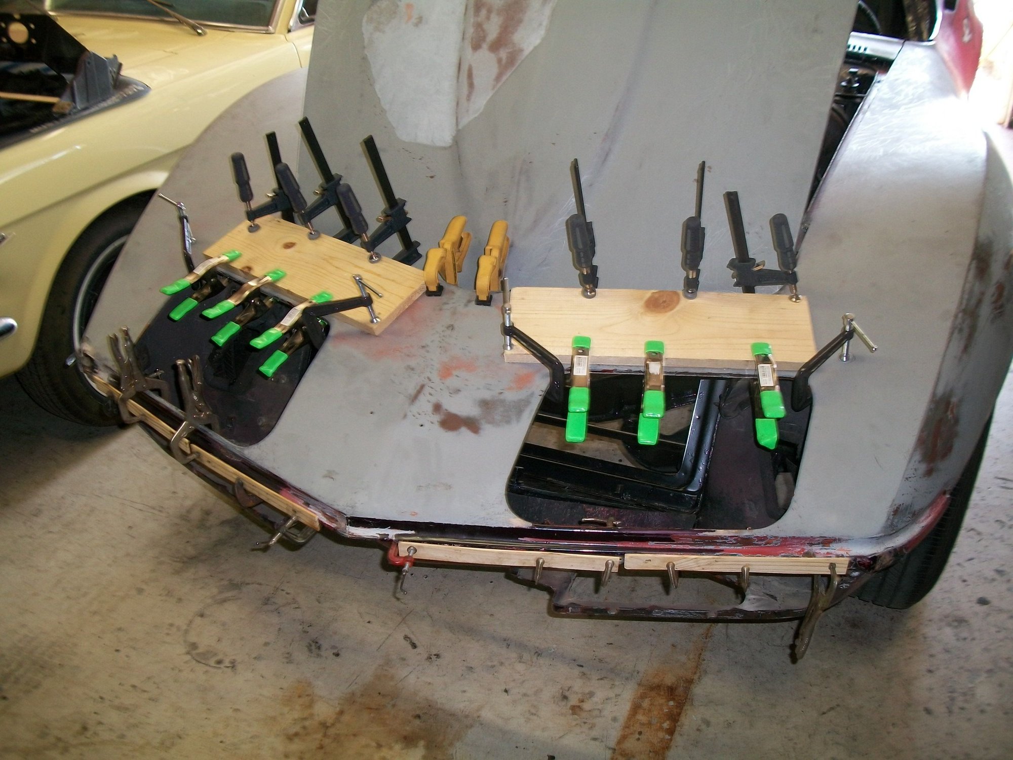

Yeah you want to go after those pesky rivets from the bottom.
I made this little cutter, nothing more than a shortened hole saw type drill without a pilot and put it in a small right angle drill to cut mine out.
With just a little effort, it cut the surface of the glass enough to pop out and release the rusted rivets, without breaking through to the top of the car.
After marking the location of the support, some Lord-Fusor adhesive
in the double tube caulking gun and its solid as a rock.
Used "C" clamps and some wood strips to flatten out the bumps in the glass. Left them clamped on over night and they were gone.

Originally Posted by John 65
Yeah you want to go after those pesky rivets from the bottom...... without breaking through to the top of the car.
