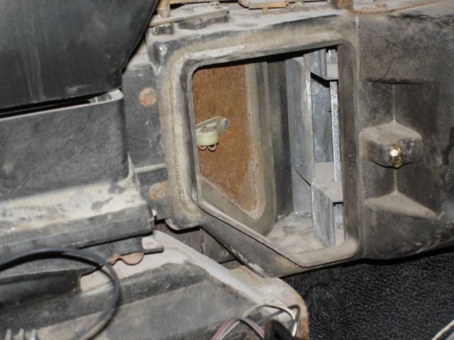

I can also agree that paying very careful attention to hose routing and wiring, etc is paramount. Hopefully no one has been in the dash and messed it up so when you put it back in you are not fighting with an improper installation.
I have encountered dash panels were someone left out the special shouldered taper washers. Without them,....the head of the Phillips can pull through the vinyl and get under the vinyl and down into the foam area. I have encountered this more times than I care to count and I usually have to get my heat gun out to warm up the vinyl so when I try to get the Phillips head screw out...I do not crack the vinyl.
Also...I know most people would not go deeper into the dash ( because they would rather be doing anything else but this)...but I can tell you that I would seriously inspect your heater box,vacuum hoses, cables. Especially an A/C car due to the vacuum pods used on moving your doors inside it to correctly channel the air where you want. Because the last thing a person wants is to be all done and then have to tear back into it again...and do it ALL OVER AGAIN.
The vacuum actuator pod that is on the heater box for an A/C car. It is between the heater box and the firewall...and the heater box needs to be detached to service it.
Trust me...it is worth the extra $$$ and time....unless you just want to do it twice.
This is the view when you pull your main duct attached to the heater box off of an A/C equipped car.. What you want to see is that the creamy white plastic retainer on the door is still intact. IF it is broken...you are screwed and the door WILL NOT operate correctly...even if the vacuum pod is working correctly.

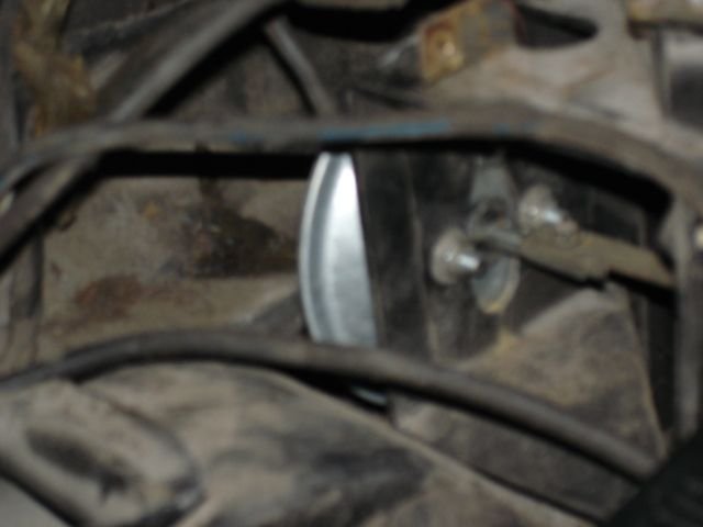

This is the vacuum pod that operated the door that the creamy white plastic part is attached to. It is bad.
A view of the vacuum pod out of the heater box.
The pod is bad. The rust and torn seal where the shaft comes out of the pod is torn. This A/C vacuum system would not work correctly until this was repaired.
