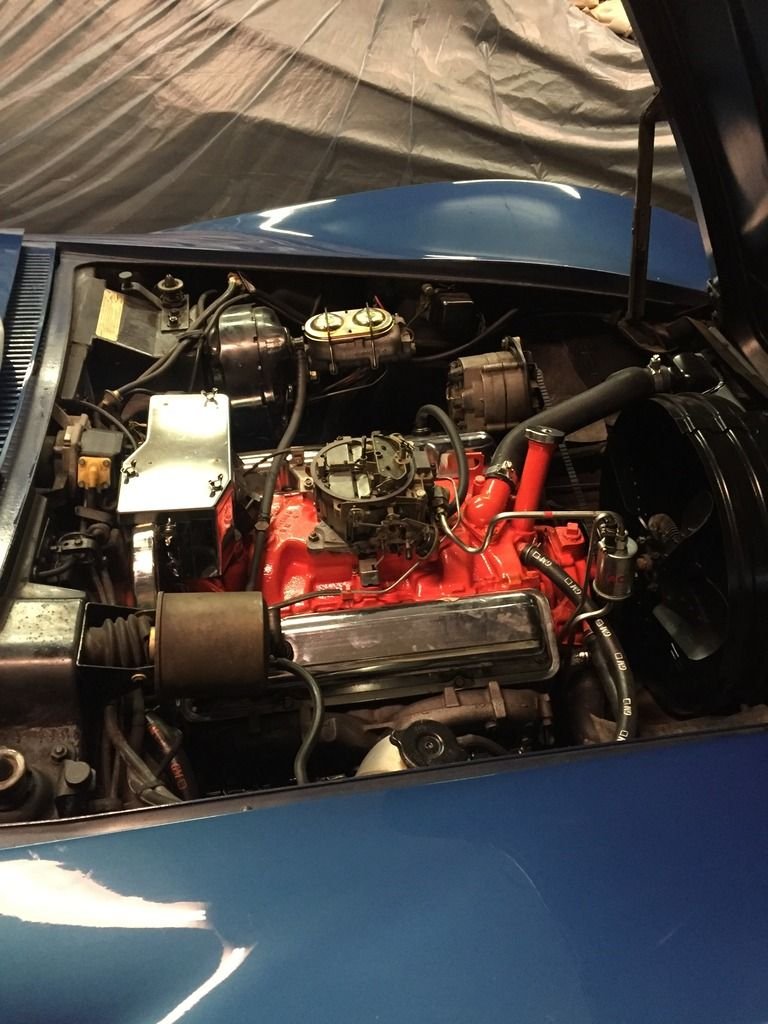

couple ppl asked for underhood. Took me awhile to snap a pic but here it is.

Nice! Yep, that looks pretty original. Where was that barn again?

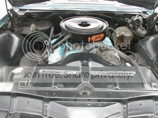

Just for consideration: I've been looking for a nice '65 Catalina sport coupe for years...nothing found that is decent. Four years ago I find a '65 Grand Prix....ALL ORIGINAL! and I mean all original. 59K miles and I'm buying it from the second owner (who keep it in a 1-car garage under some blankets). THE INTERIOR IS LITERALLY SHOWROOM PERFECT, except for the wood veneer trim which can easily be replaced. Nearly 100% original paint with no body damage. Original carpet, original headliner and all in great condition.
So, what do I do? Keep it as it is, or drive it like I stole it? Well, I gave it a year without changing anything. I did drive it to many car show and here's the response I got:
99 of 100 people who stopped to look at it seemed to appreciate that it was an original condition car...but none of them thought it was anything special. The 'one in a hundred' person went Ga-Ga over the car, seeing what it was and not believing what he was seeing.
So, there you have it. If you really like your car being original, GREAT. Keep it that way. But don't expect many viewers to think it is anything special. You have to love it for what it is YOURSELF, as very few others will feel the same.
So after a year or two, I decided to make it into what I really wanted. I am keeping the original body and paint but have done touch-ups on nicks/chips and gave it a good cut-n-buff to bring back the luster on it. Only thing done on the inside was the wood trim replacement. The engine compartment which was 50 years 'tired' was completely refurbished, but retained MOST of the original hardware. I added stock Kelsey-Hayes 8-lug wheels, new rubber, added electronic cruise control, and put a dual-master cylinder on it to make it safer to drive. And I still drive it like I stole it. Put 2000+ miles per year on it and let lots of TN folks see what a '65 GP looked like.
Oh, I did one other thing to it....I installed a completely refurbished, all-original '65 tri-power setup on the engine. I had one back 'in the day' and that's what I wanted on it.
Before>
After>
You need to do with your car whatever you want to do with your car!!

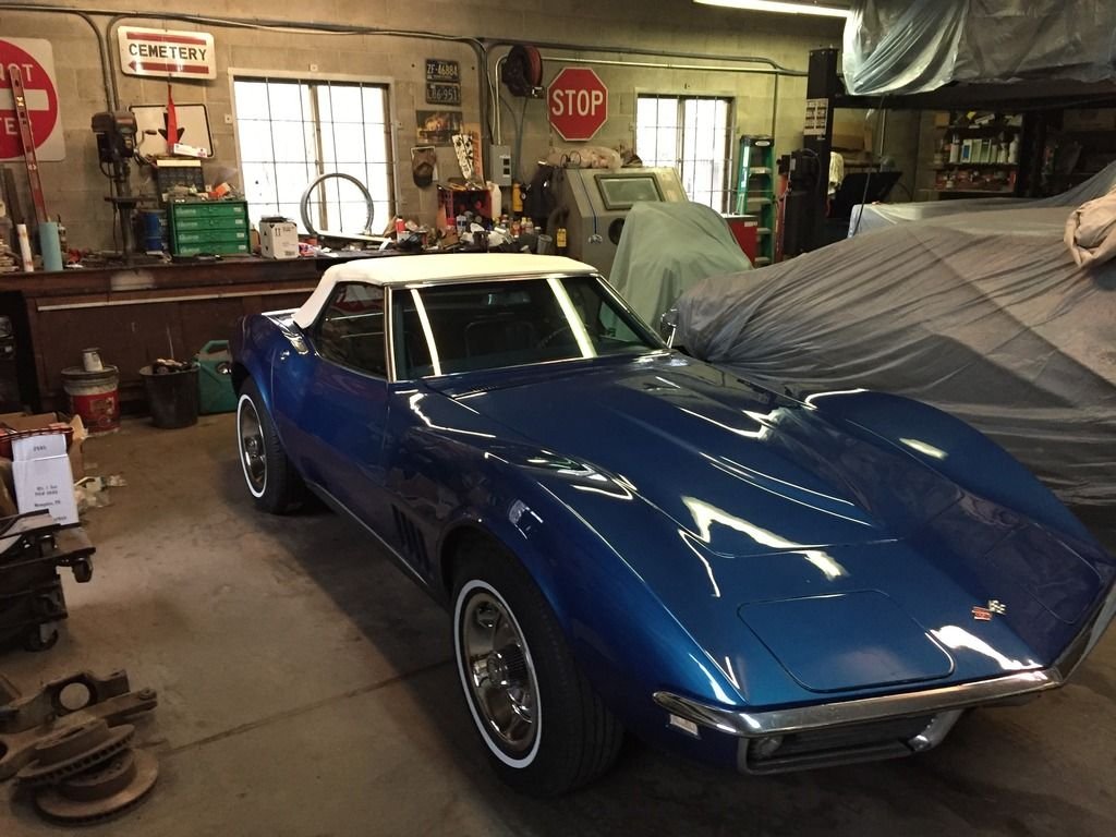

Well after sitting in the garage since 86 the car officially made its first trip around the block.
Still got some bugs to work out, but all minor.
