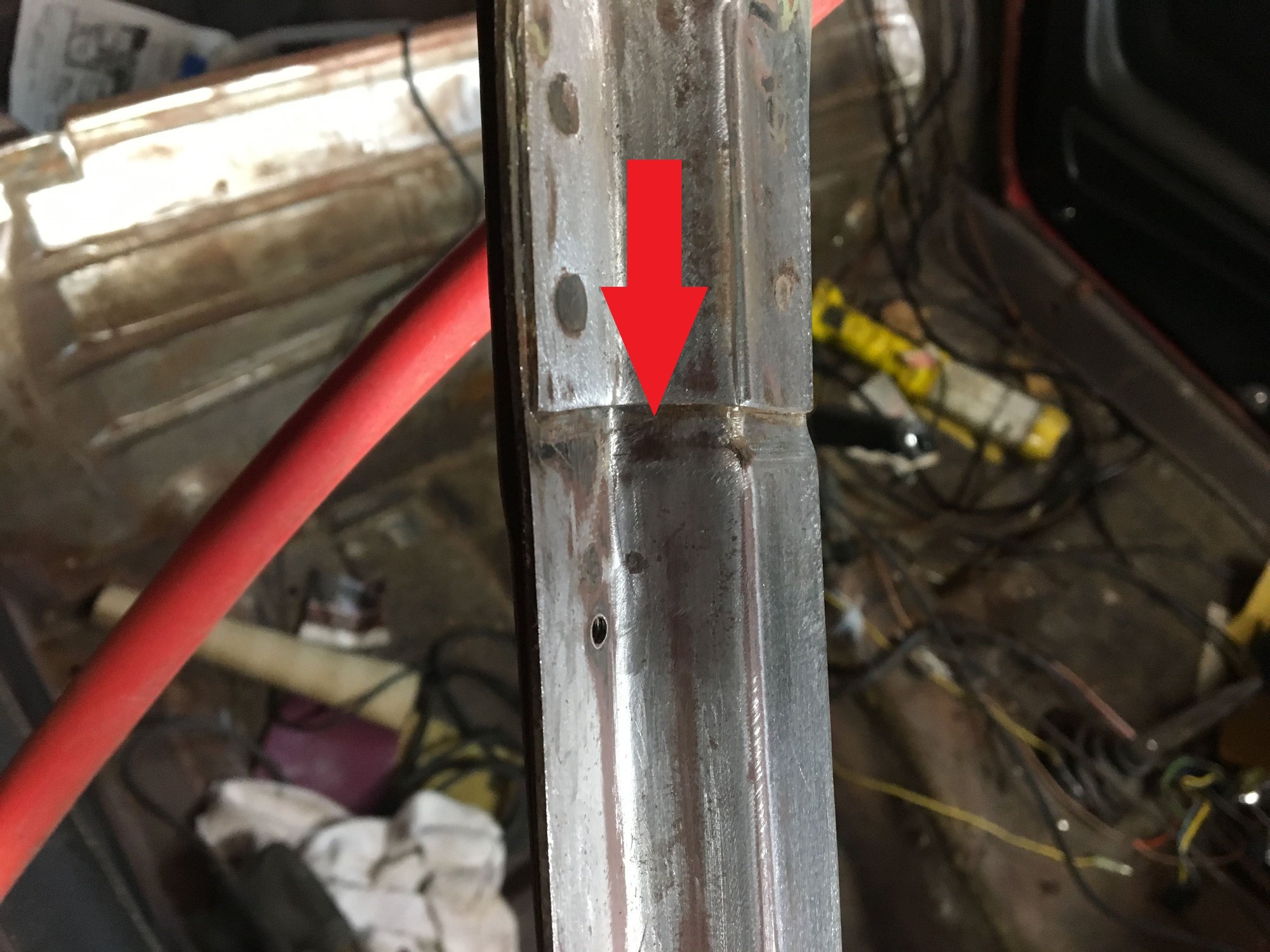

I've removed the windshield and started cleaning things up. Before I reinstall, I would appreciate a few tips on rustproofing the frame and getting the windshield to seal properly.
I must be living right, because this is the worst of my windshield frame
It seems like this seam (red arrow) would be a likely place to leak. Any thoughts on filling this with something like POR patch sealant and filler. It sets up like a rock, is sandable and bonds well to metal. My plan is to chemically strip the entire frame and use POR 15. Most of the frame looks like this:

that white sealer looks to be the original type , same as what I scraped off my 69 in places that no-one has been to since it was made.
I'm guessing you know the screen came out in 1991 .
have a look at the condition of the rivets along the top, although your car seems to have been well looked after , any moisture that got in there would be effecting the alloy rivets .
what I did to my 77 when I had the glass out was to dig out the old dried up sealer as much as possible without forcing the firewall around too much and lay in some sika flex . I know some will say its the wrong stuff etc . but I cleaned up the area as much as possible and I'm happy with how its working . btw I use dry wash now so the car hasn't got wet in about 2 years now .

If you can find it, I'd suggest using butyl rubber caulking. It won't harden completely (stays flexible) but will bond to about anything and seals like crazy. I used to find it a Lowe's, but they no longer carry it. You might do well to just etch/prime that windshield framework with self-etching primer paint. It bonds with the metal and protects against rust. But, you can also paint over it with a topcoat of whatever (rustoleum, etc.).
Since your frame has little rust on it, POR is just overkill, IMO. Seal it up well AFTER you prime/paint it.

If the original sealant pulled away from the metal, I'd be hesitant to use it again which is why I'm asking if somebody has found something better.
Any thoughts on filling the metal seams in the first 2 photos, keeping in mind that my car is too far gone for any kind of judging? I'm looking for bulletproof rust prevention.

I took the old beige sealer off too. Then used a black epoxy primer. Next I'm going to fill in the gap with SEM BEIGE SEAM SEALER, as recommended by DUB here: sealer.
For the steel-to-steel junctions I used this yellow filler: filler.

Por 15 will seal and level out the crevices, and protect it.
I used Por 15 on my window frame and it came out really good.
