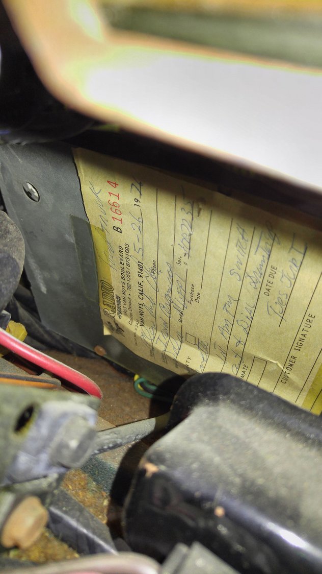

Look what I found under the radio while tracking down the wiper wiring! Its a radio service receipt from 1976 and it has the original owner's name and address. Very cool!
