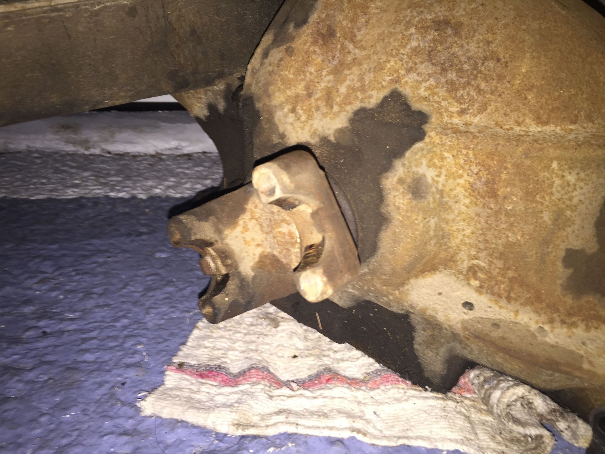

Hello all,
I need some advice, i have a Rust diffenretial for a c3 pc 1978
I would like to have it clean / paint
Looking at the ncrs book, it is mentioned unpaintex cast iron
What is your advice, blasting and paint, clear coat, etc ?
Any idea
Thanks thierry

Are you going to have it NCRS judged, or do you just want it to look good?
If it will be 'judged', ask Alan71 or other NCRS members what is the best way to approach your "problem".
If not, wire brush all loose rust off the parts. Any items that are easily removable should be removed for manual cleaning (wire brush, chemical, etc), washing, and painting [either engine enamel 'clear' or some metal-colored paint]. Once loose rust is off the diffy, spray it with rust converter to prevent further rusting (and that will become a primer coating), then shoot VHT metal-colored paint to suit your taste.
I firmly believe in painting or coating EVERY BARE METAL PART so that they will clean up easily and never corrode.

I know nothing of "NCRS correctness", but if you just want it to look nice, Eastwood makes a paint called Cast Blast. It looks like cast iron. I did my differential in this stuff, and it looks great.

Hi A,
I'll start with the differential crossmember since that's an easy one. Semi-flat black.
There are lots of options for the differential case itself:
bare cast iron
bare cast iron with a protectorant like PreLube6.
Semi flat clear
Cast Blast.
If you decide on Cast Blast remember the finished product will look more original if the fasteners don't have paint on them. The same is true for the yokes and u-joints. You could use clear on those if you wish.
Regards,
Alan

Thoroughly cleaned with a brass brush and degreaser, then coated with CRC SP400 preservative. Have not removed/reapplied in 5 years.

Thanks for the reply, nice pictures too
I don't want to be ncrs judged but i want to be as close as possible to the original
I will go with your advice

I love a product called Rust Prevention magic. You can google it. It dries to the touch and has kept the differential in my 70 rust free for about 3 years and appears as cast new. My garage is not temperature or humidity controlled and it looks freshly cast.
It does require a heat gun to heat up the part being coated with the RPM.
Costs about $34 plus tax and freight.

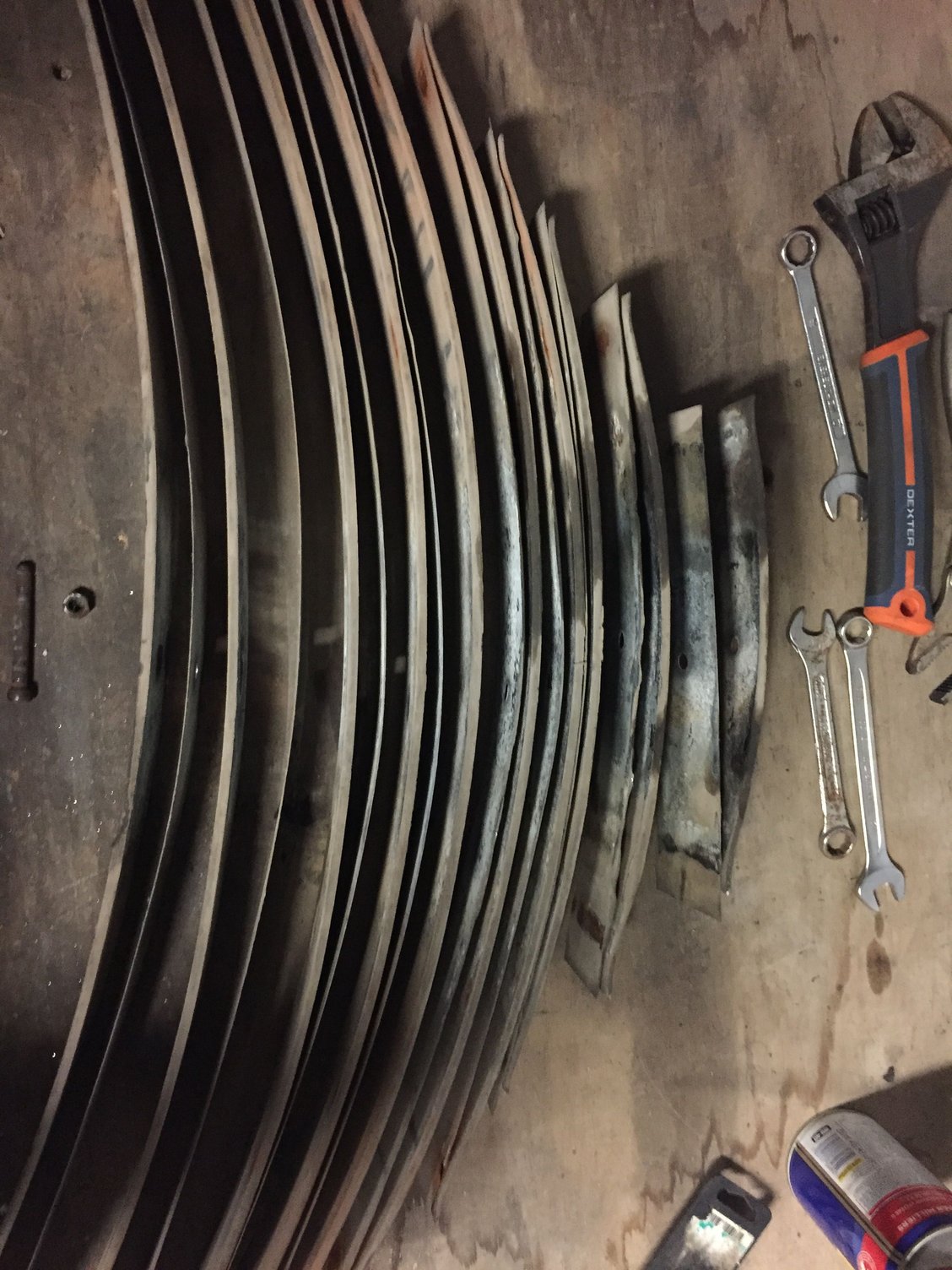

I have another question,
Looking at the nice picture of spring
Mine is 9 leafs with zinc liners
I guess the leaf have to be paint grey, right ?
What about the zinc liners, i will replace them with new one, but do i paint them ?
Thanks
Thierry

Hi Thierry,
Yes, paint.
Apparently both the spring leaves and the liners were originally painted gray.
Regards,
Alan

I'm sure the spring 'pack' was painted [outside] as an assembled set. You don't want paint on the "working" surfaces of the spring or the liners...they are designed to 'slip' against each other. Paint on those [inner] surfaces would not work as intended (and would make a lot of paint flaking mess!).

Hi nice precision' agree but
My spring leafs have some old paint trace on inner side, it is not the case about liners
