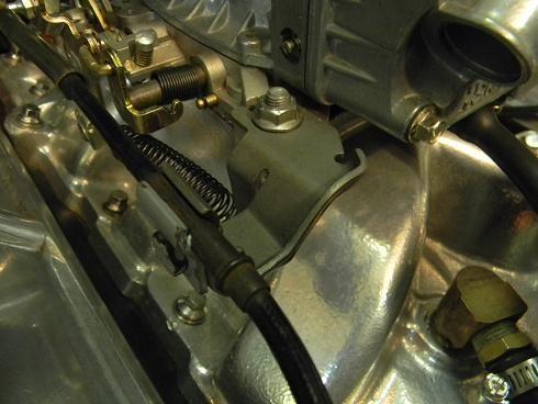

Originally Posted by Alan 71
Hi 540,
The throttle cable comes through a fitting on the firewall, is held in position by a small bracket on the left rear stud of the carburetor, and the end of the cable clips onto the carb linkage.
This is a 350/Q-Jet but the cable is the same for the Holley big block and the bracket is similar.
Regards,
Alan
Thanks Alan. I just wanted to see what the bracket looked like mounted. I bought one on E Bay yesterday for a Holley.

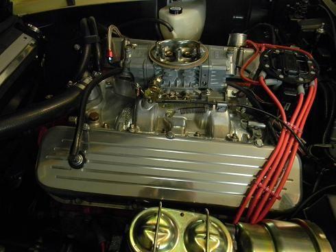

Here's mine if it helps.
Thank you. The more the better.

O.K. lets turn it around and lets see your fuel line setup. Holley big block. The one I have needs to get a little bend in it to clear the intake bolt and the line seems to get in the way of the heater hose.

Here's mine, looking down from the fender it attaches to the fuel pump at the 8 o'clock position.
