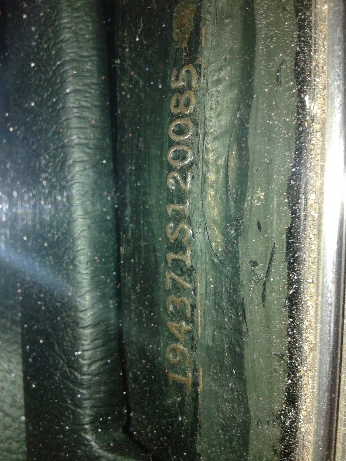

Originally Posted by Corvetteoz
How does that number correspond to your VIN?
It matches the engine, and A pillar...
120085 is the consecutive unit number for the car. The consecutive unit number becomes part of the complete VIN.
All 1971 Corvettes have the 1 following the plant code (S for St. Louis). The car in the pic was the 20085th 1971 Corvette assembled. Total production was 21801 cars. #20085 was completed near the end of the 1971 production run (21801 - 20085 = 1716 before end of year.)
Yes... June 22nd build date
