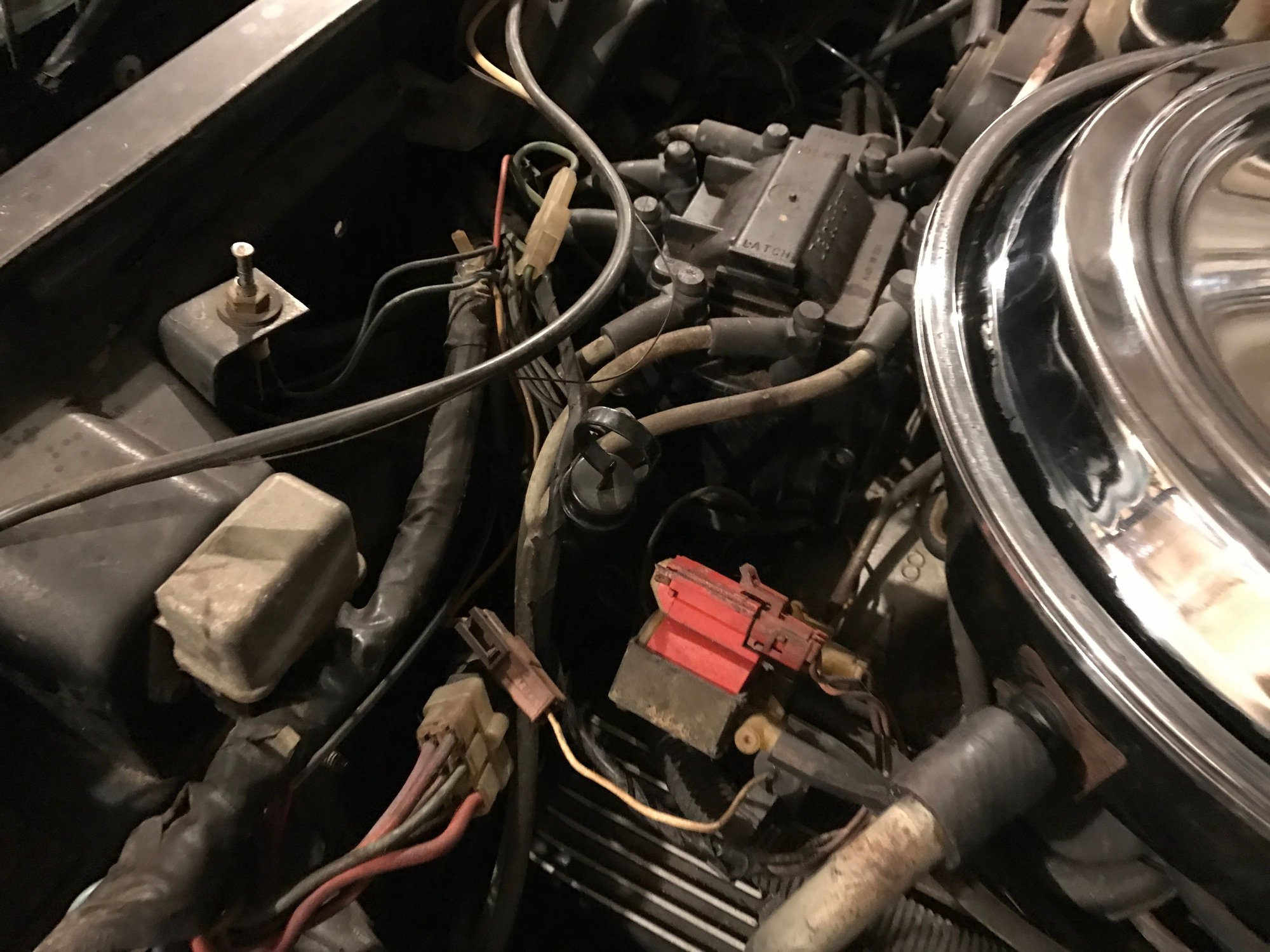

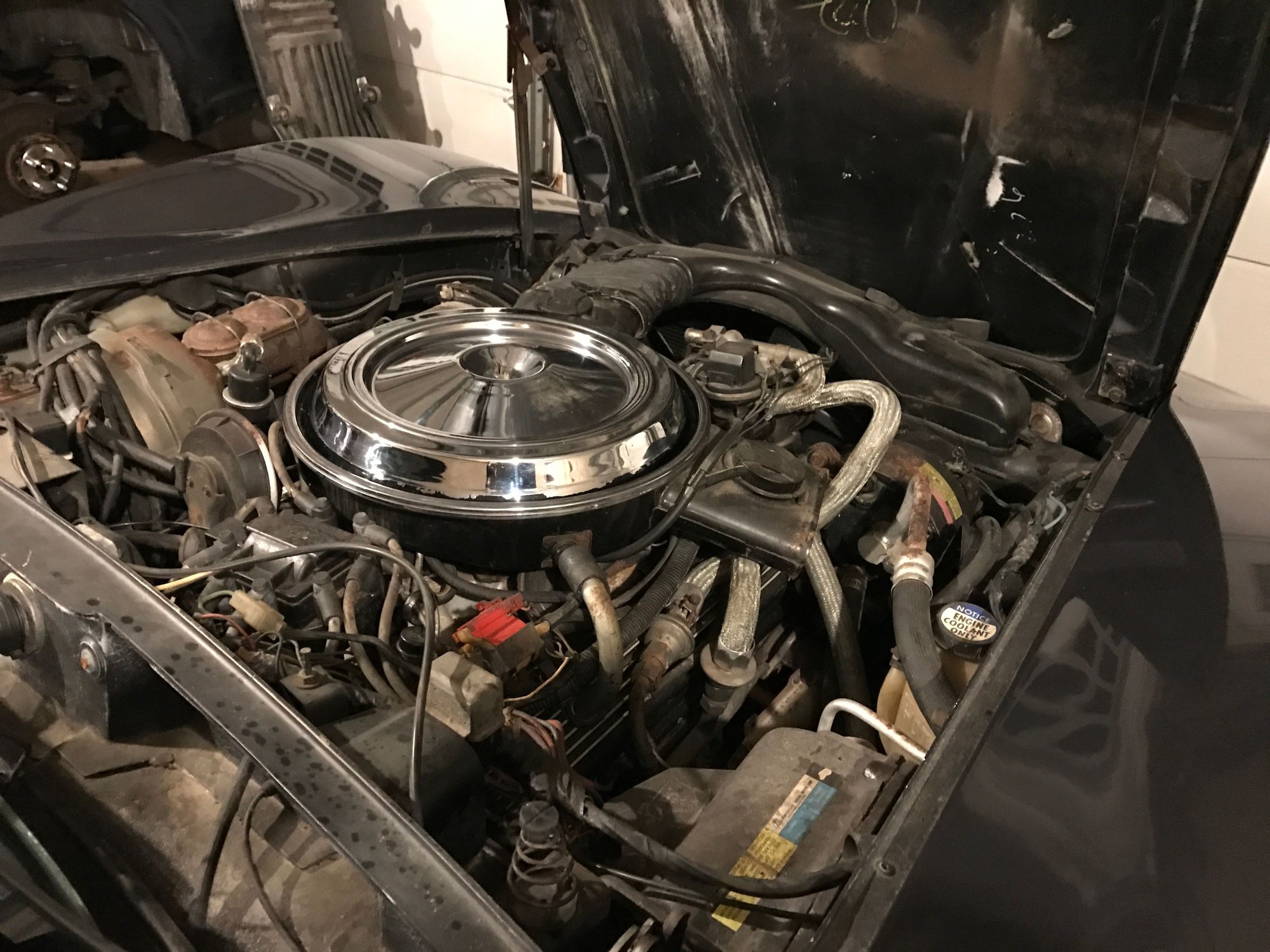

I forgot to mention EGR (Exhaust Gas Recirculation). EGR is likely the most contentious emission control system. Some say it has little to no effect on performance; others say it significantly decreases performance. Again engine tuning and other component design may account for more performance reduction than the system itself. The purpose of EGR is to reduce the oxides of nitrogen that result when fuel is not completely burned. It is an effective emission control system that is still used in every new vehicle. I believe that EGR is disabled with wide-open throttle so you might keep that in mind before you remove/disable the system.
Might I suggest that you post some pictures of your engine, carburetor and distributor? Many a new owner to an old C3 is surprised by the changes that have been made to what looks like a "bone stock" car! Some of those changes can be so old that they do look original.
While everything hinges on your ability to street license an emission modified '81 in Massachusetts you might consider backing off your stated desire to drop in a different engine.
Regardless of how stock your engine is I cannot give higher suggestion to replace all of the vacuum hoses in the car.* If you don't already have one get a hand vacuum pump like a Mitee Vac! They're cheap and of incredible use in our cars! You'll spend less than $100 replacing the hoses and like me, may be floored by the amazing improvements in performance, starting and even comfort. This includes getting all of the emission control systems working to include A.I.R--even if you don't have a catalytic converter. Don't forget the hoses (and filter) going to the brake booster and the little piece of hose installed at the transmission for the modulator valve.
*before replacing the small vacuum hoses used for HVAC simply disconnect the system at it's funky "T" at the driver rear of the engine between the distributor and brake booster, pump down with a hand vacuum pump and see if it holds vacuum overnight. It very likely will as these hoses (and their connections) are different than all others in the car.
If not already done and, again, allowed in MA, consider disabling the CCC*, swapping the carb out for one used in a '78-'80 and replacing the distributor with the basic HEI (pointless) version.
*the CCC controls your lock-up torque converter. I don't know how much of the system can be removed before the lock-up ability is lost. I do know however that this early lock-up system tended to engage and disengage so frequently and noticeably in city driving (especially with hills) that some people intentionally disabled it long ago.
Remove the catalytic converter, pipe for true dual exhaust, put in a higher performance cam (again the one used in L82s is a good choice), set timing per Lars instructions and you might find zero need to replace the engine.
Your '81 has the aluminum differential case and mounting often referred to as the "bat wing". While a significant weight reduction compared to the cast iron version that it replaced it is not as robust. The cast iron unit was able to handle anything the pre-emission, high compression, high performance big blocks could throw at it but the aluminum version was never designed to handle that much power. I do not know how much power you can add before you can expect problems.

Thanks for all the replies. I'm extremely excited about digging into the car. The color is a charcoal grey (almost black fast) with a little metallic in it. Absolutely love it and I haven't even given a good cleaning and detail in the photos you see posted here.
MA doesn't require that I keep any emissions equip so I' pretty much free to do what I want and makes sense for the way I plan to use the car. SwapmeastMike, thanks for all of the detailed information on the equip. I wanted to remove some just to clean up the engine bay a bit but I'm not opposed do keeping things that make sense. I know she isn't going to be winning any drag races with the current engine and that's fine with me. I'll have to identify each of these systems under the hood and then I can see about what to remove and which ones I'm going to test and replace hoses, etc so they will function properly. I have heard about changing the ignition timing curve which is supposed to help.
It has what I believe is the original exhaust system with a HUGE cat under it now. One of the first things I'm doing is going to a true dual system without cats.
I've read about the CCC cars and it sounds like the best option for me might be to replace the carb and dist for the short term. I'm sure a properly curved HEI will really help. I just need to understand what else needs to be done to facilitate this swap. I believe I read there is also an O2 sensor or something that feeds the ECU and will need to be addressed or you will have a CEL (Check Engine Light).
I have ABSOLUTELY NOTHING to back this up but just from looking at the engine bay it looks 100% stock. I removed the connection from the snorkel to the passenger side airbox system to clean it out for these photos but there isn't a cut wire or anything I can tell that's missing. Just ordered the shop manual but as far as I can tell I'm starting with a totally stock setup.
** If you look closely in the third pic you can tell I need to replace my cross cable for the hood release. Thing is about ready to go!

Can you post some photos of the carburetor with the air filter removed?
The CCC v1 system was extremely primitive and I believe that swapping the carb and distributor with '80- units will remove all computer control from the engine. Again, I do not know what happens with regards to torque converter lock-up but I am certain there are reasonable ways to both retain the lock-up ability AND make it less obnoxious during city driving.
Considering that your A.I.R. pump belt is removed it would not surprise me at all if your check engine bulb has been removed.
New owners to our cars are essentially forced to become crime scene investigators no matter how original the seller claims it to be. I say "crime" not because I consider all modifications/workarounds to be bad but because it requires close examination and even forensics to determine what has been changed since the car was built.
