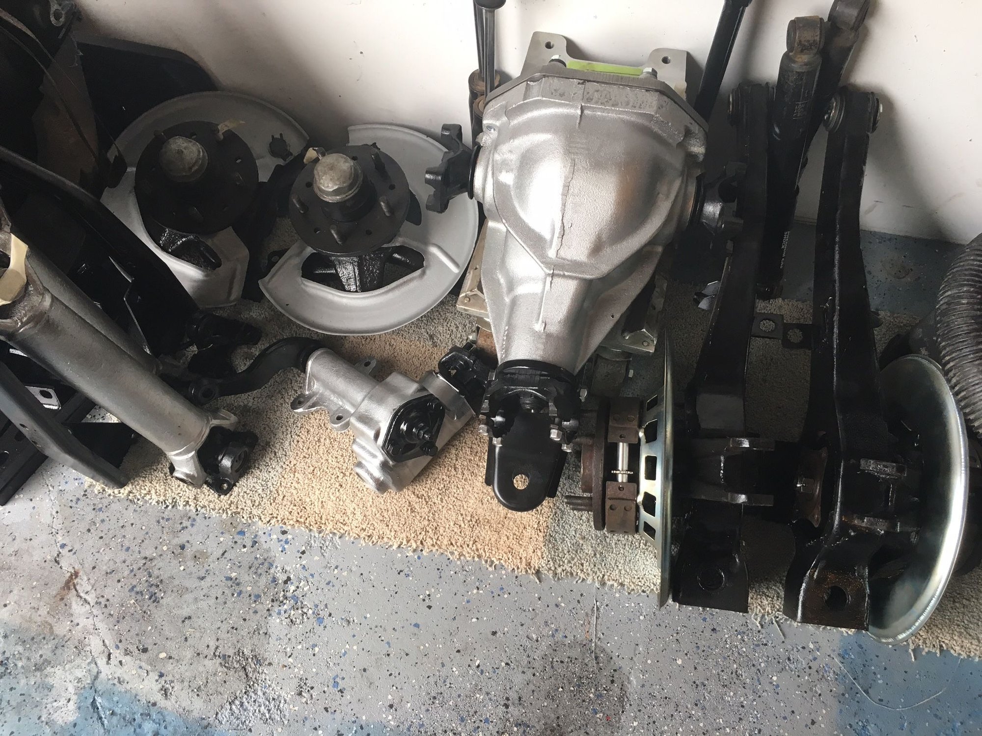

Trailing Arms rebuilt and ready for install.

the control arms look so much better. Is the trick to media blast them and then paint them or is alot of this new? How much did you have to replace. I'm just trying to learn as much as I can so if I ever decide to do this, I know what I'm getting into. First I need a garage where I can do this.

Yes tank was very bad. No hint of the tank sticker remained. The fuel and brake lines both were spliced in the back half and the fuel line has signs of rubbing the body.

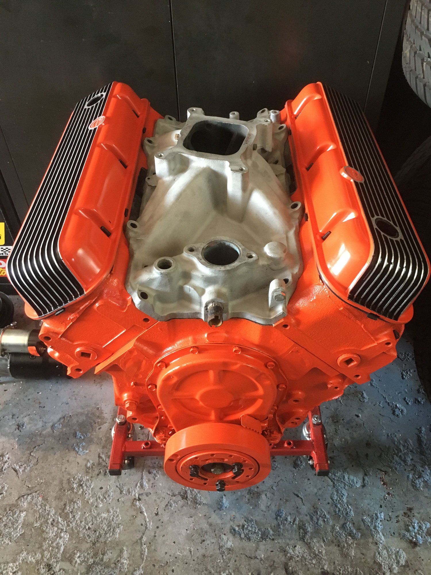

Started work on the motor.
Port work for free up some hidden power.
painted up and ready for final assembly.

Well the motor is starting to look like something. Found the old Cal-Custom covers and have them painted up. Next is some prep work to the body and then maybe i can start to put some things back together.

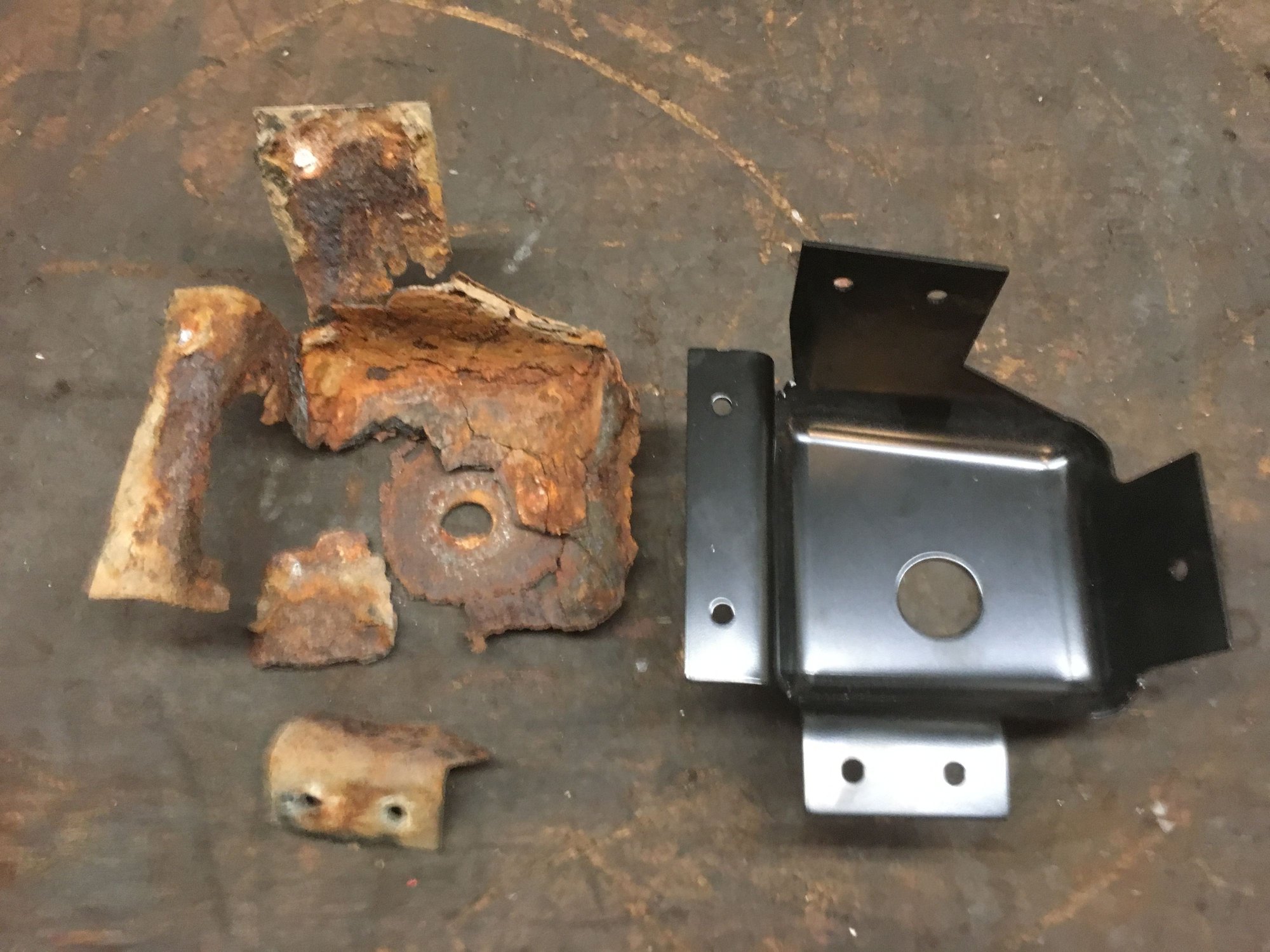

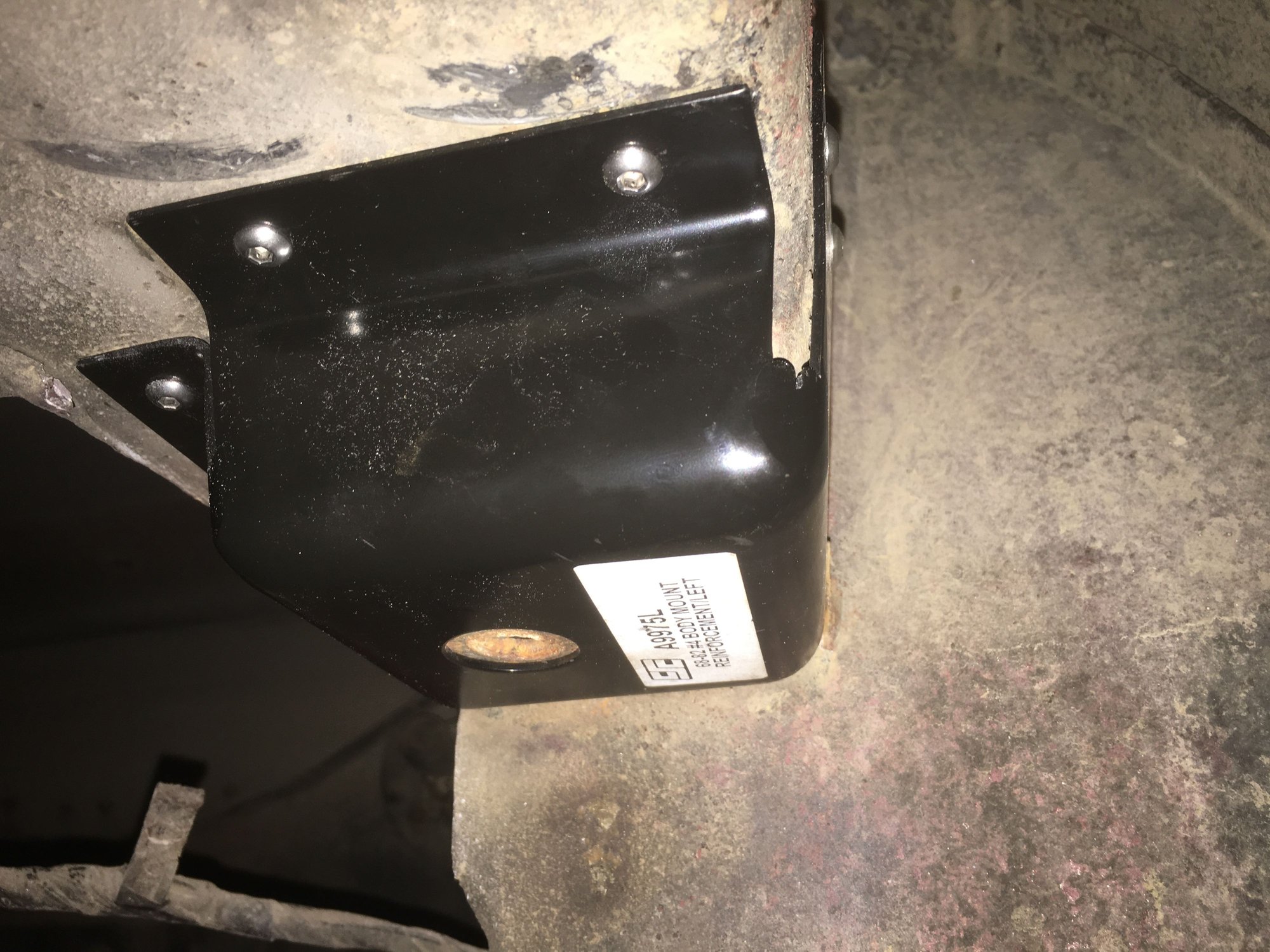

Both #4 Body mounts changed out. Used Stainless hardware over the rivets. Should last longer than me!!
