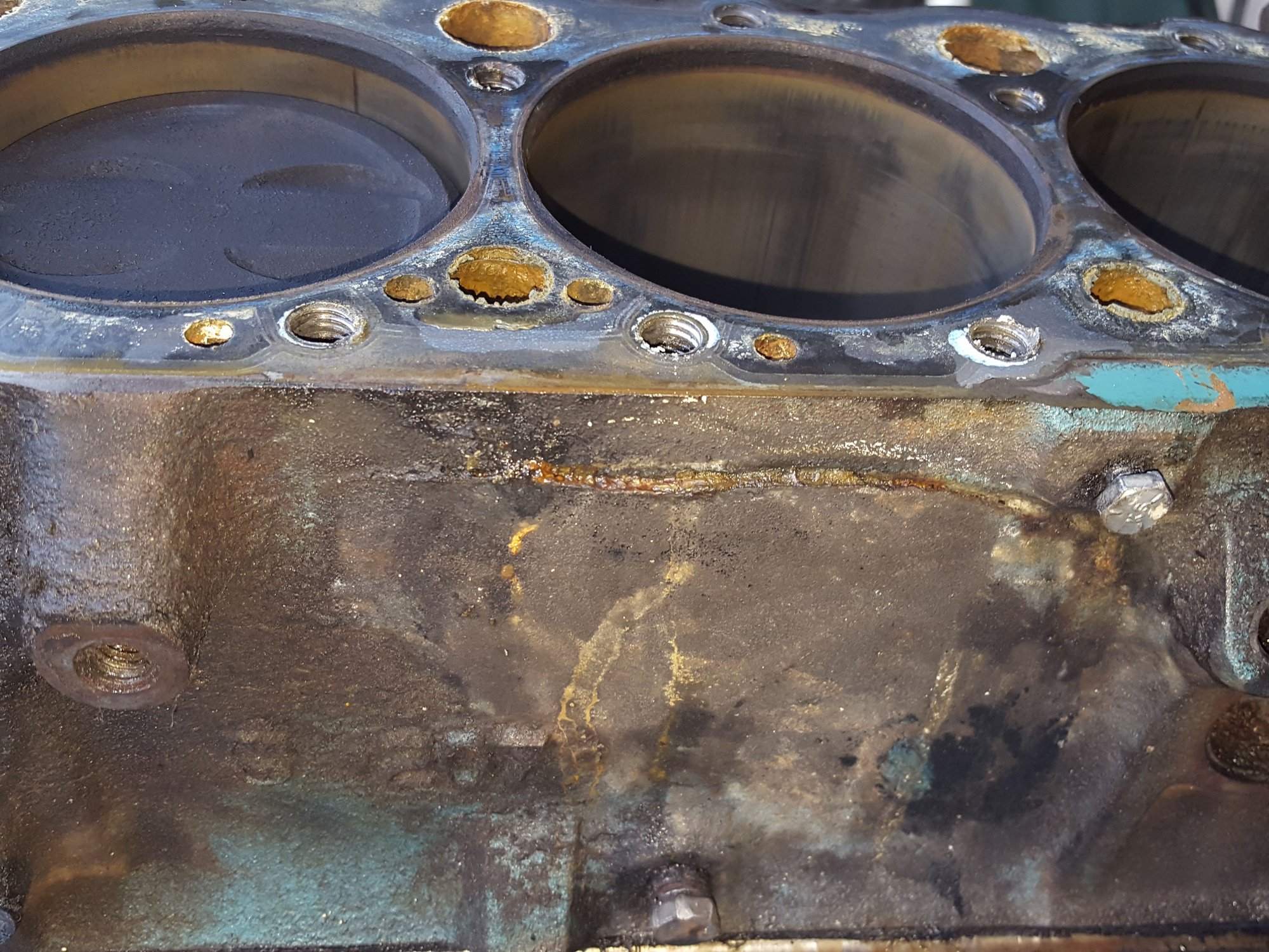

I have had my car for about 10 years now, I just had it rebuilt, bored to 383, put a slightly beefier cam(magnum cam), with some blueprint aluminum heads, for a little more power, and already have hooker headers and side pipes. I know it was a numbers matching car, that's why I opted to rebuild the engine instead of get rid of it. I have always just believed the L82 tag on the hood till I started reading and realizing people swop them out.
So I look at my vid and the 5th number is an 8...which points to it being an L48 but in disbelief, I wanted to check and make sure I didn't have the ZBB or ZBA on my block.. and I look and I see a ZAH....I know the ZA also points towards an L48 but I can not find what the ZAH means... can anyone help me out? Also, I have already changed all the things that made the L48 a lesser of an engine, so is it worth it to continue building the car. A picture of the block stamp is below. would love any advise!

Doesn't really matter what it was or is because it's now NOM 383 car. Just enjoy it.

Hi i,
The information I have indicates the ZAH suffix is a 79, 350/195, 4-barrel engine for use with an automatic transmission and was installed in Corvettes.

ZAH indicates a 79 base engine car with AT, confirmed by the 8 in the VIN.

You have a base L-48 engine. The L-82 engines were either ZBA or ZBB. (1979 model year)

Why would you suggest this is a non original motor? It could be the numbers matching L48.

All these comments, and no one mentioned the double VIN stamp?

Hey, look at that double VIN stamp!
