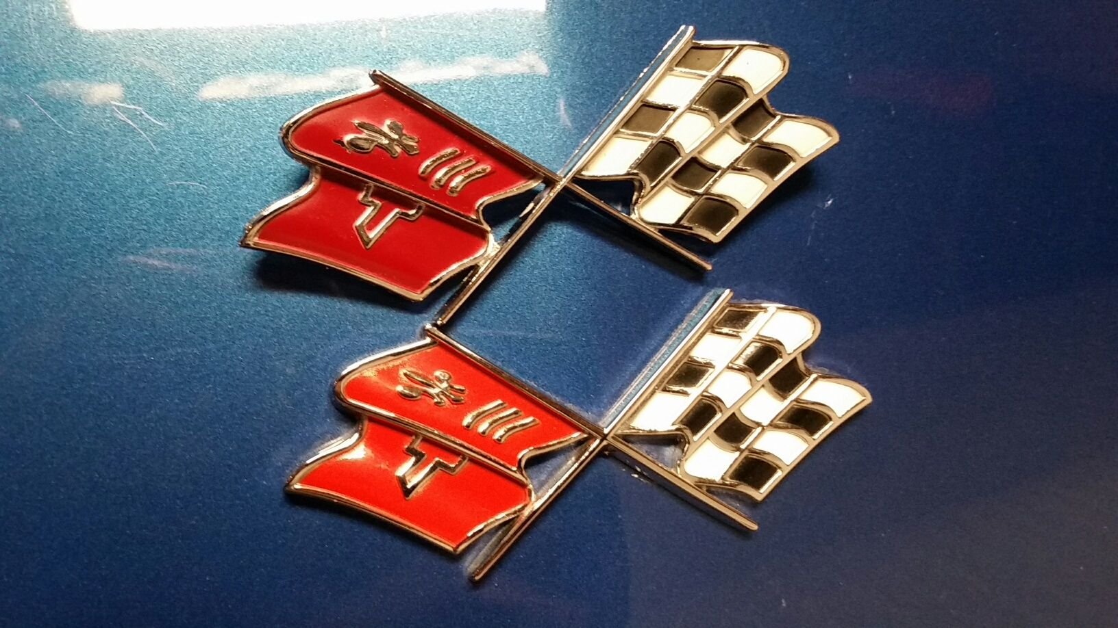

Top is Fuel Door Emblem in darker red. (rear view with stampings in prior photo)
Lower is front bumper emblem in more fire-engine red. (not removed thus far to reveal stampings for originality)
Interesting topic - I'd like to learn more.
I was sprucing up my '69's fuel filler door this weekend, as well as the vented cap. Here are photos of the filler door back side, as well as the emblem itself - front and rear. I'm guessing this is not original, as I have not seen photos of original ones, but I'd suspect I'd be looking for some GM or division logos somewhere.
Comments welcomed as to originality of either the door or the emblem.
Also, I removed it and placed it above the front bumper emblem showing a distinct Red color difference as described in above posts.

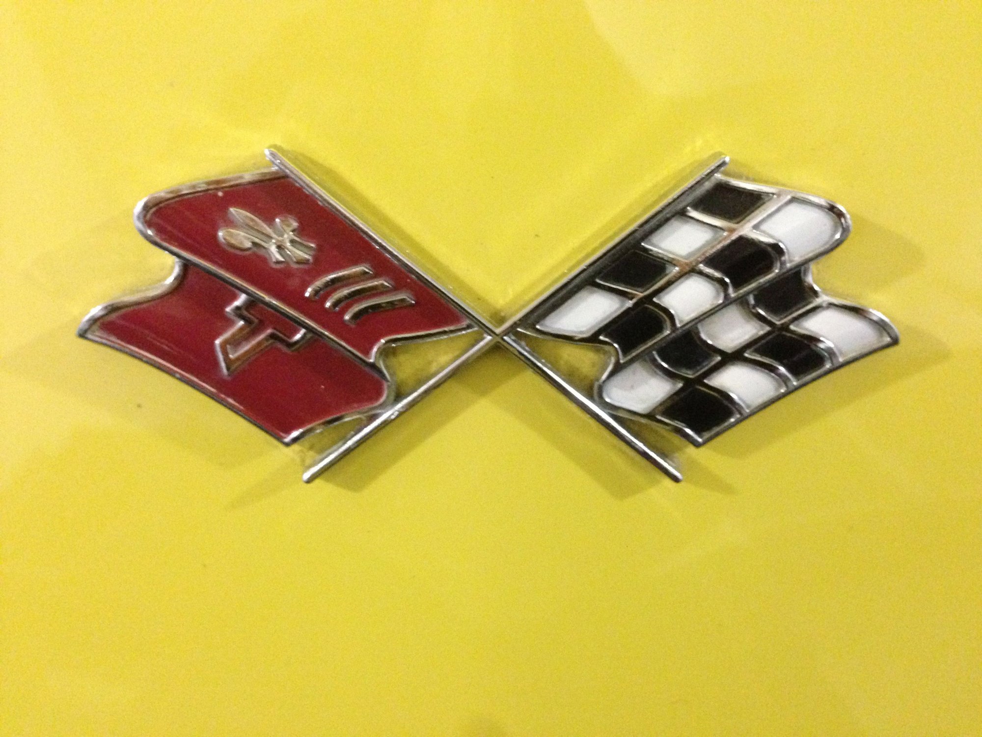

Here is the original front emblem on my 69. Same dark red front and rear but who knows, it might have been a little brighter 48 years ago....

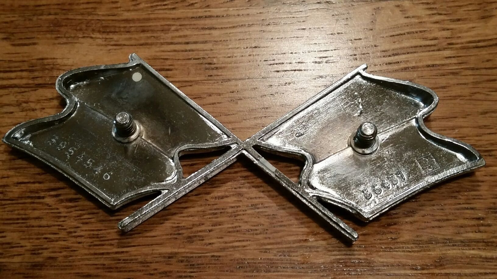

Does anyone have part markings on the B-side, comparing original to new/repro emblems?
When I searched on the Bay, some of the fuel door emblems that are listed as "original", show same markings as what I show on my photos above.
The 2 numbers (part number and a shorter number), plus the block S type of logo.
Is this what should be on an original emblem?
And then, has there been any evidence of new-made parts using the old stampings, passing themselves off as "original"?
Thanks,

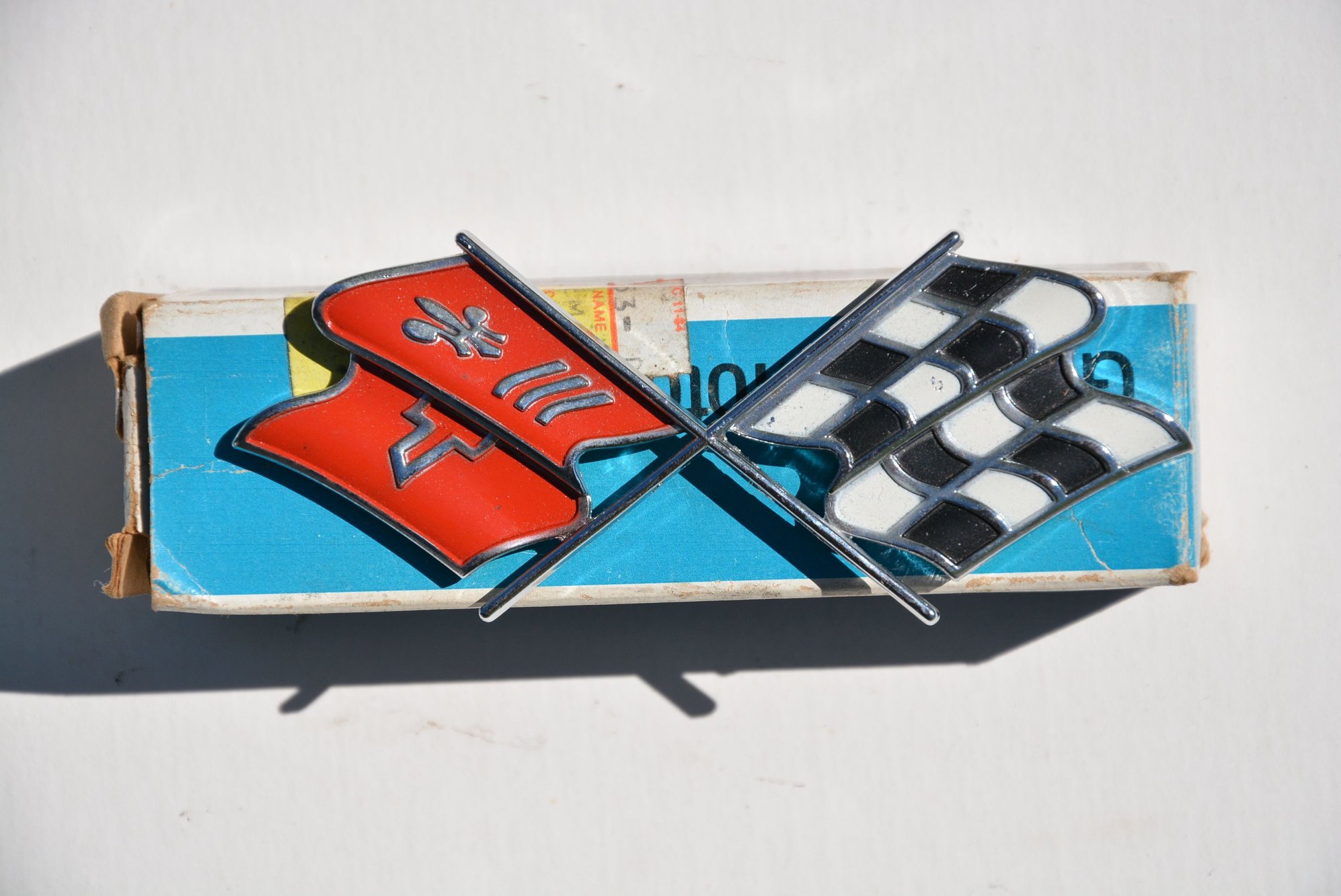

Here is an NOS front emblem, that I recently got in a group of NOS parts I bought. The label on it is dated 8-86, and it is the red-orange color. If the darker red is correct, then GM changed the red they were using, at some point.
It wasn't uncommon for GM to do this, change the colors on emblems. It sure makes it hard on the hobby though, too know what was right, and when. Of course, GM wasn't building show cars, so they didn't really worry about such things.
The repro's made by Trim Parts, have the GM part numbers cast into the back of them, because Trim Parts is using GM's original molds. There is (or was) a cheaper Taiwan repro, that is blank on the back. I don't recall if the Trim Parts emblems have the General Foundry logo cast into them also, but I think they do. I have a couple of the Trim Parts ones, but I can't get to them right now to look (they're packed away for Spring Carlisle).

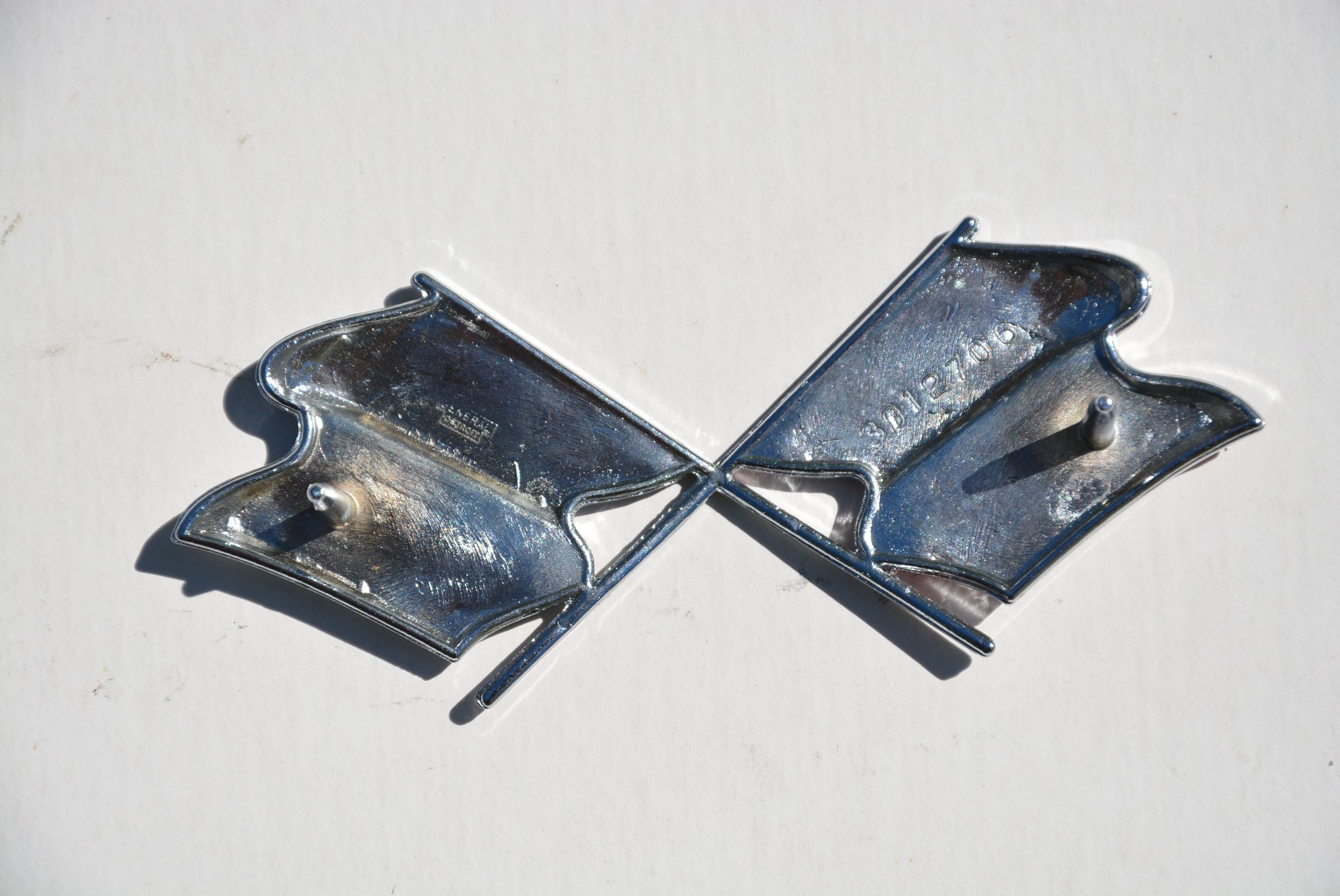

Hi,
Here are the back of the emblems from my 71.
The front emblem has:
GENERAL
DETROIT
The same as seen in GB's photo.
The rear emblem's logo I don't recognize.
Regards,
Alan

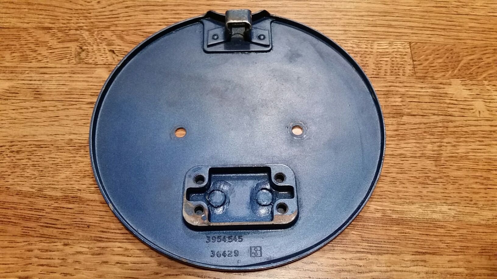

Thanks Alan - looks like your rear emblem matches the markings on mine - so I feel gook knowing it's original (or at least well-faked).
The same block "S" is on both the rear emblem and on the fuel door itself. I was thinking they were both repro'd by the same company with the block "S' logo.
I haven't removed the front to see what I've got under there (and I likely won't anytime soon).

Now I'm curious about the S you mention that's on the door…. where on the door is it?
Regards,
Alan
This is the underside of my 71 door.
