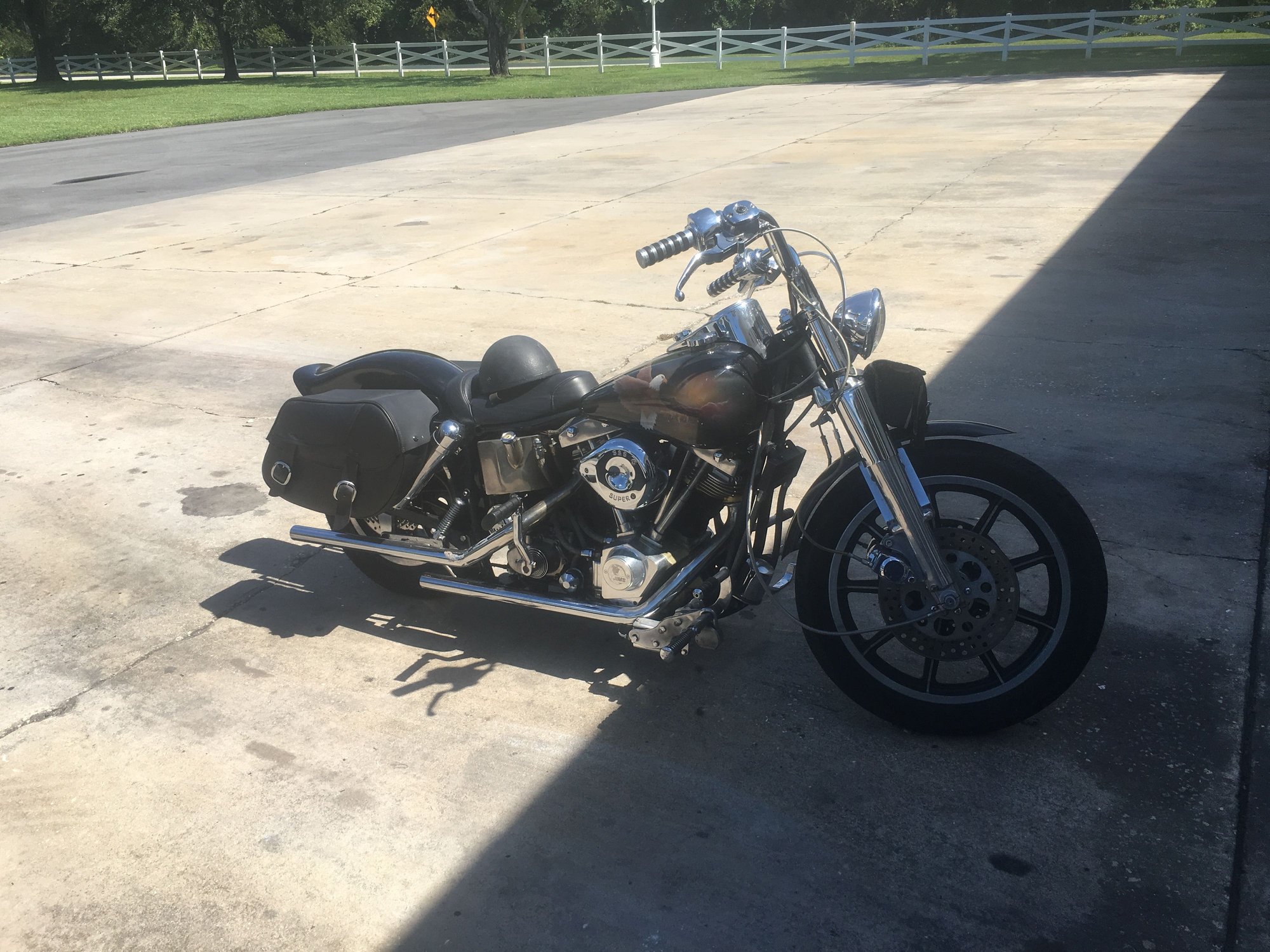

They do! Crazy how it just happened that the Vette would be the same year as the Harley! Can't wait to get to all the other stuff on it!!
Here's a pic of my Harley!
